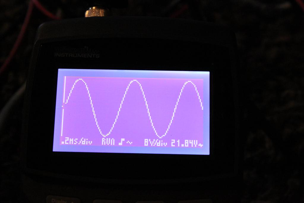

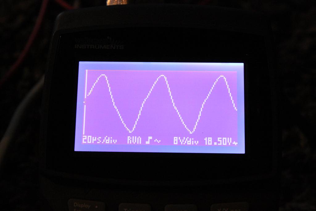

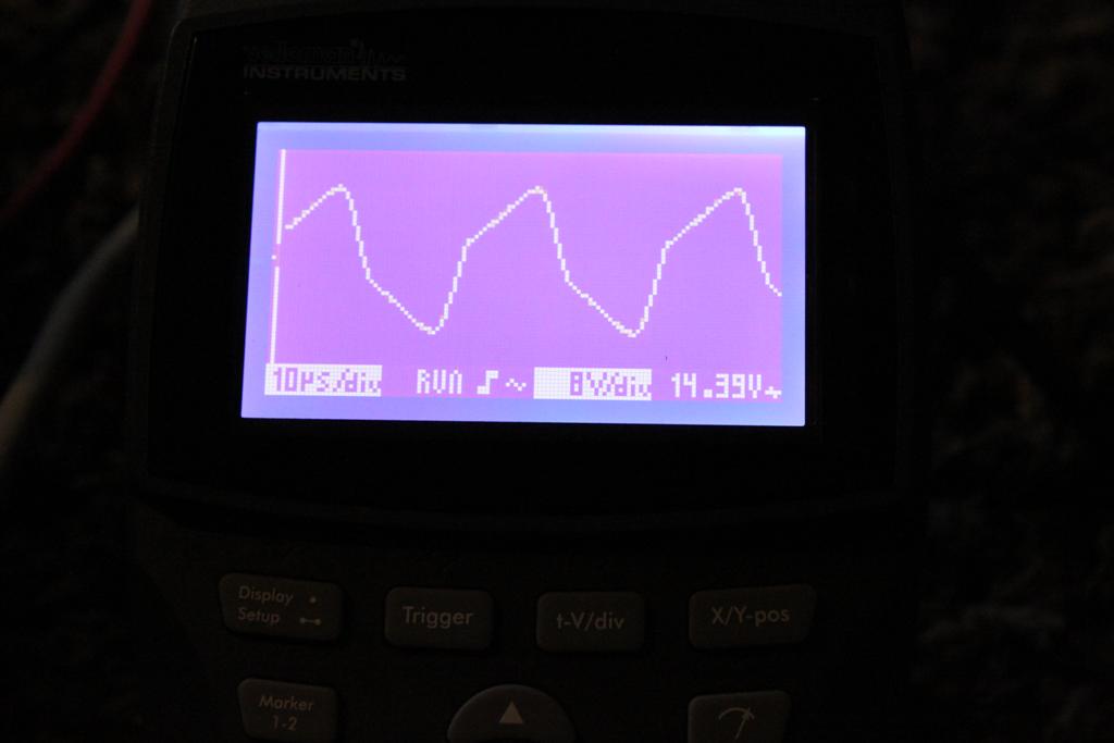

Aleph-X strange HF behavior
Today I did some measurements with my Aleph-X Blocks. They are build with the green DIY Audio boards. The circuit is scaled to app. 70 watts into 8 ohms.
Current Gain is set to app 65%.
Up to app 9 or 10 kHz everything is ok. Above 10kHz the output signal get's distorted at high power. With 20kHz sine wave input at full power the output signal looks almost like a square wave. Switching back to 1kHz the output signal is again a nice sine wave.
At half power this isn't the case!
What could be wrong?
Strange HF behaviour pics
Output signal with sine input 2.5V and different frequency. Amp works app half power.
1st: 2.5V input (app half power) 1kHz
2nd: 2.5V input (app half power) 10kHz
3rd: 2.5V input (app half power) 20kHz
At low power level everything is ok.
Can anybody help?

8903B Nice toy.
What bias current are you running? And what does the signal look like out of the diff pairs on the input. Also what is the static DC offset on the outputs?
P.S. Even the first trace on the post above doesn't look too good.
Bias etc see #1995
Relative (static) DC is close to zero
Absolute DC is around 0.03V
Signal out of the diff. input I need to check
