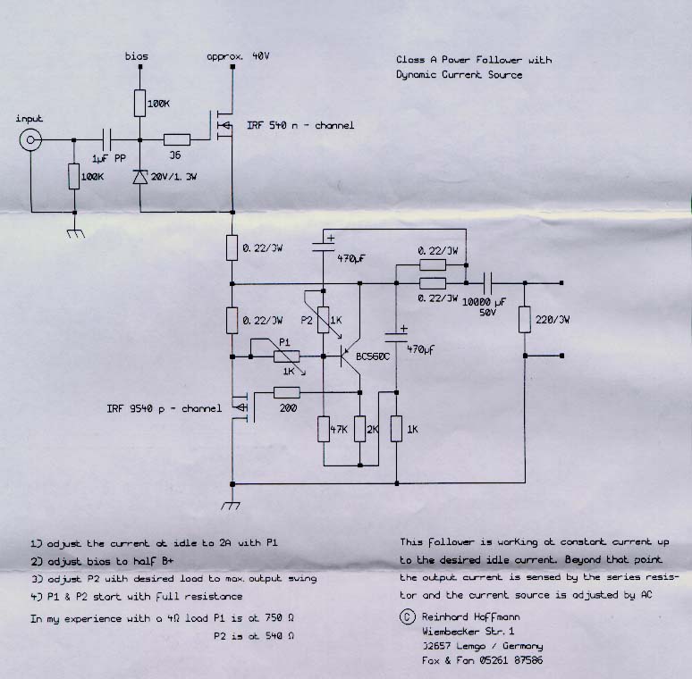

By chance I have found the schema from the attachement.
The main difference to the Aleph output stage is the fact, that this stage works as power follower like that one about
http://www.audiodesignguide.com/my/Follower_99c.gif
but include the same features than the Aleph output stage concerning the enhancement of the efficiency.
The question is, how I can add a differential input amp to the power follower from the attached jpg file?
If I know this, there is automaticlly the possibility of choice about a select switch, to operate in two modes:
1) output stage as common source
2) output stage as power follower
Who can post the appropriate circuit topology?
