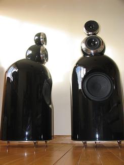

:att'n: It's nothing wtih this but if you are intresting to see my last loudspeaker I think you never see something like that before (sphere in full carbone) http://users.skynet.be/fa616506/
