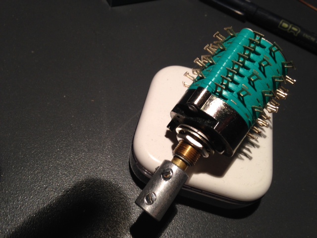

balanced route is having two poles phases : one + , one -
just imagine it as plain stereo , with + as R and - as L channel
so , wire it as plain stereo pot
for stereo balanced , that's as two stereo pots on one shaft
all that , speaking of common (meaning - usual ) L (shaped) attenuator
there are other types , but that one is good enough for starters
I have 3 rows of 4 pins and 3 rows of 8 pins … The row of 4 i'm understanding to be 1 input +/- , +/- …. The rows of 8 … are my common ground ? and ? …. thats not it :) I have 12 positions ??? The above is only 9 .
I'm lost now ……
BTW, I'm using 3 inputs balanced .
Sorry to make a mess of this thread …. !
Rich
