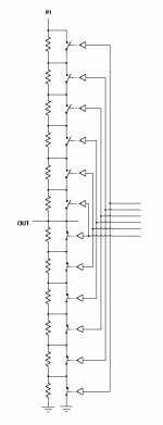

What is constant impedance? I think the sum of the resistance from output to ground and output in input is the same with every step. Is that right? If that’s right then I have an idea that will work. It does use a lot of relays however. As you can see For 16 steps you need 7.5 relays. For 32 steps you would need 15.5 relays. It works almost like a mechanical stepped latter attenuator.
Even of I had commercial intentions on this design, I would still show it. I know that’s what Mr. Pass would want me to do and without him I would have never in a hundred years though of making an attenuator out of relays and resistors.

I'm glad you like the constant impedance concept. What is basically means is that regardless of volumesetting, the resistance remains the same. The stages before and after the attenuator are faced with the same amount of resistance. This is achieved through a number of sections with a fixed amount of attenuation. Such a section consists of a number of precision resistors configured as a voltage divider. The relay is there to either allow the signal to pass trough the section, or bypass it.
The desired amount of attenuation is achieved by putting several of these sections in series. The data from an optical encoder is translated into bits that controll these various sections (see the picture).
