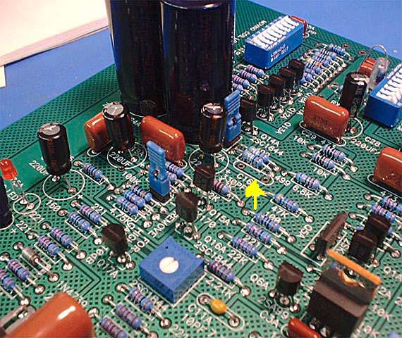

Hi everyone!
Iam just in the process of designing the PCB artwork for the Ono/Xono phono preamp.It will have almost the same physical layout as the original Xono( one big Pc board for the main amplification stages with filtering and regulation-~30cm * 40cm-.and the other for rectification and first stage filtering ~30cm*20cm.)When i finish the Artwork and crosscheck it ,i will release a Gerber file so that everyone can use it (this will take probably a week or so).
Here are my questions:On the picture in the Xono manual there is an electrolytic cap labelled C28 220uF/16V,probably bypassed with C29 47 nF in the position where on the Ono pcb is the coupling cap C10.Can it be that this is the coupling cap between MC and MM stage?!,why electrolyt,why so big (220uF)?Any ideas?
The second question is:my Pcb artwork will have the same crosshatched plane as in the original.Should i ground it,and where ,or should i let it float?(Nelson,Wayne?)

nagard said:The second question is:my Pcb artwork will have the same crosshatched plane as in the original.Should i ground it,and where ,or should i let it float?(Nelson,Wayne?)
Make the groundplane massive (no crosshatching) and use it as signal ground. Don't forget to make "hot releaf" pads. Otherwise it can be very hard to solder, especially the caps!
Wayne/Nelson has crosshatched groundplane because it's cheaper to produce and can also be an advantage when machine soldering. You don't stress the pcb so much when heated.

Groundplane will be chrosshatched, like the original. The groundplane is NOT used as a conductor, only connected at a single point to ground.
This is the way I think it works best, and as Pass did it. If You want it different, Your choice, but this design is fixed in this detail.

Most industrial pcb's have massive groundplanes and power planes (especially digital ones) just because you want the best posssible ground. It's nothing wrong to have the groundplane as a shield but I think you can get better working conditions with a massive groundplane and use it as a combined signal and power ground. But if your circuit is handling currents (power amp maybe) you must carefully design the traces with currents. For small signal amps it's no problem at all to use a massive groundplane. It doesn't matter so much that you haven't full control over the current paths.

I don't think that a cross-hatched groundplane is necessarily cheaper to manufacture. The same basic stock pcb material used.
Also have you considered that the cross-hatched ground plane might sound better because of lower capacitance while providing similar shielding properties?
Actually you do recover more of the etched copper in the manufacturing process and have lower rejects due to board warping both of which can have cost influence. I had to fight like hell to get solid groundplanes on my last design where I needed the low ESR for large currents. The manufacturing people had a cow!
I wonder if groundplanes are really desired for high end audio as they do add a lots of stray capacitance to the circuit and FR-4 is not the best dielectric. I don't see the point to point wiring crowd using coax everywear for shielding which would have much the same rational as a using a groundplane.

I have noticed that you get better step response if you make a hole under the input transistors and especially the emitters. This is caused by stray capacitance from the emitters down to ground instead of a high impedance path to the current generator.
But seriously, how often is 2-4 pF harmful? Almost never I would say!

But if you have so sensitive circuits I think it's even more important with groundplane with holes where you must reduce stray caps. In almost every application note over high speed devices they emphasize the importance of decoupling and groundplanes.

If ground plane, then ground plane.
I can think of no good reason to use crosshatch on any board.
If you are worried about warping then pour some solid plane on
secondary side as well and use stitching vias in the pour.
With through hole boards a little warping is usually no big deal.
More important with SMT.
Plus hatched planes are usually a manufacturing nightmare.
Many slivers are created which have to be fixed by the CAM
operator and can cause problems with small pieces of resist
becoming dislocated during imaging process.
Solid ground plane is very easy to "cut out" under inductors, etc.
If different capacitance or impedance is required, adjust the
stackup accordingly.

But it does surely shield more or less the low voltage signals in the Xono.
Look at this picture! It looks like there is no ground plane, neither crosshatched nor solid?
Anyway not on the Pcb borders. And in the PSU unit the two caps and probably the block rectifier for what are they? Can it be that Nelson or Wayne has implemented the Mains DC blocking scheme?
My Pcb manufacturer likes more the solid then the crosshatched version, because with crosshatch he has to be more precise, but of course it does not change the price
Big ground planes over signal traces definitely raise the stray capacitance, and crosshatched plane has lower capacitance then the same solid ground plane. But does it influence the sound? In Pass designs with highly capacitive MOSFET's and relatively low resistor values probably not too much (and if you design it wisely as Nelson did it in the XA-200 amp you can get rid of the compensation caps, - see the picture below, taken from the Xono manual.)
