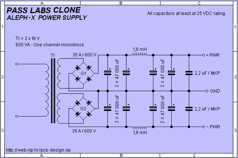

I am following the recomended transformer
You've made a mistake ordering 25V caps if you are still planning to use a 20VAC transformer. I've been banging that drum for a long time, thought you'd heard it.
Your first caps will be on the edge if you use an 18VAC transformer, but then your rails will be about 19V.
You'd mentioned the disability income before, which is why I kept pushing cheaper alternatives. You are way up the diminishing returns curve. I'd go with CRC at 50,000 uf and doubt there would be any issues with the sound. Then spend the difference on better speakers. 😉
I will be using the 18volt 600VA transformer for each mono amp, I had to use 25volt capacitors because of the differance in price by going to 35volt or 40 volt capacitors. I am following the capacitance given on the attached diagram, however I have added another stage to the choke, this is writen about by tube amp designers who have discribed the differance in sound quality in the high frequency and the deffinition of instraments in the wide sound stage created by a good amplifier.
I have researched the speakers I have just finished building last month, I built a 30years of my research and knowlege into them, but now I need an excellent amplifier to enjoy the speakers the way they should be listened to, above 100Hz, I have the amplifier I will be using below 100Hz. They are the best speakers anyone has ever herd who has listened to them even with a low quality Phase Linear amplifier, the parts cost me about $6,000.00 pair and the boxs took one year to build. Thay sound simmilar to the B&W Naudalist, a friend of mine brought over his B&W's and amps so we could sit down and listen, because my speakers are to big to move easyly having 18inch base drivers loaded in a 14foot transmission line, the differance being I have a far superior bottom end, other wise they sound the same.
You hadn't mentioned dropping back to 18V that I remember. You'll have nominally 24V at the first cap, plus transformer regulation plus line voltage tolerance.
I see we have the same idea - start with good speakers. Rephrase that comment to read spend the difference elsewhere.
Have you given any thought to how you are going to keep those inductors cool? The resistive dissipation will be ~50W and ~40W respectively. You'll be throwing away 180 watts per channel before you get to power your amp. The chokes in Jacco's links have lower DCR and cost less.
PSUD says using the 2.2mH foil choke in a CLC supply you will get less than 5 mV peak to peak ripple. The 4 mH would get it under 2 mV p-p. Do you really think going from 5 mV to .2mV with the CLCLC is going make an audible difference worth the expense?

I am not financially committed to the coils yet
Will the coils become hot, because the foil coils are covered with polypropyline plastic, that means I will have to use the copper wire coils because I could cool them, but then there will be magnetic fields comming off of them to consider, would there be magnetic fields comming off of wire coils ? They would have to be mounted with insulation from the live current passing through them, I think some cement(ceramic) might be ok, I intend on mounting all of my Power Supply components on a heat sink from www.apexjr.com , two of the $20.00 ones [6.75in X 9.75in X 2in], one will be for the positive rail and the other one for the negitive rail.
If I were to use resistors, what kind should they be, chassis mount 50volt Power Wirewound Resistors ? or is there a better kind to use, I know that they all resister types sound different, as all coils types sound different.

All air coils become hot.
Foil coils have a lower thermal resistance from the core to the exterior (Rcc ? :clown: ), as foil has a large homogenous area and a wire has not.
Max core temperature of foil-coils and air-coils is identical, temperature of the exterior surface is not.
Foil coils have foil insulation inbetween layers, the wire in common air coils is covered with insulating material.
Magnetic flux rules apply to foil coils as well, what of it if there's a big magnetic core transformer present ?
Coils in a power supply do not sound, your button is still in x-over mode.
As for the sound of PSU components, think of it this way - if the amp has a power supply rejection ratio (PSRR) of 40 dB any PSU ripple or "component sound" will be reduced by 40 dB. Therefore, 1 mV ripple becomes 0.01mV at the output.
I don't know if anyone has determined the PSRR of the AJ-X, but I would be surprised if it is less than 40 dB (more being better).
50W wirewounds in aluminum cases should be fine on those heat sinks with your bridges
