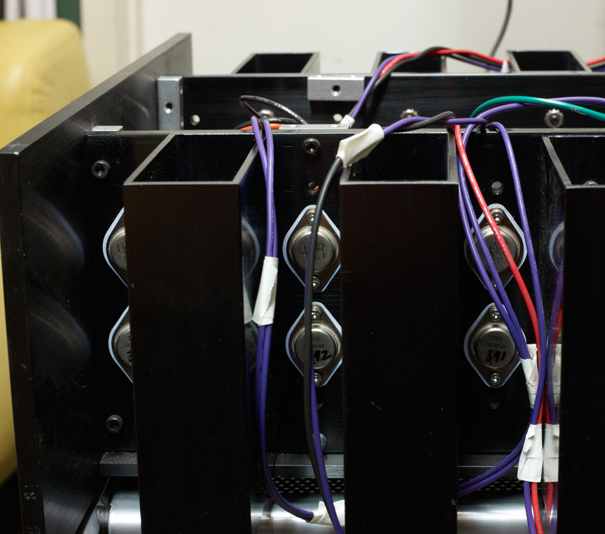

To answer your question, regarding my set up: The case is the one that Mr. Pass generously donated during the Burning Amp. I am using it as a test bed to try different set ups and amps. What I have planned is F5, F5 balanced, F5 cascoded, F3, Aleph JX, Babelfish, Burning Amp 1 and Burning Amp 2 and who knows what else comes up.
Here is the picture of the set up:

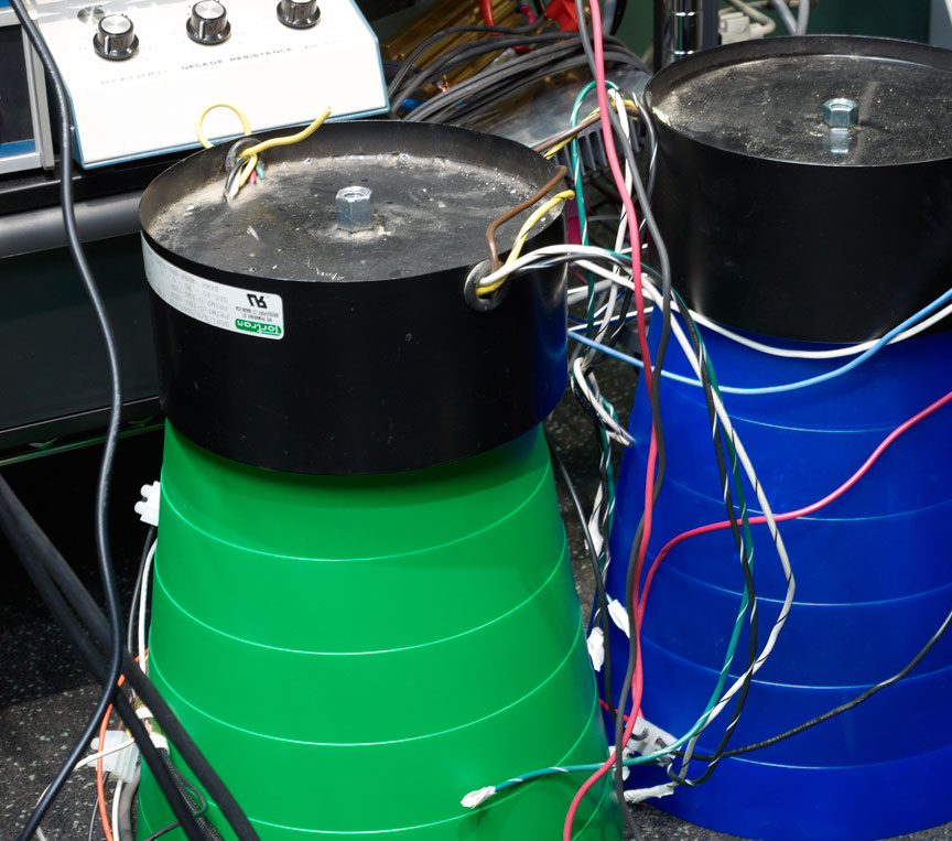

I am using transformers that are also coming from Mr. Pass and 2007 Burning Amp. Those are center taped 45 -35-0-35-45 with 120 and 220 primaries and they are I believe 3-4 KVA each. I am using two in order to get dual secondaries wired for 220V which gives me on 35V outputs exactly 24V unloaded after rectification.
Here are the transformers:

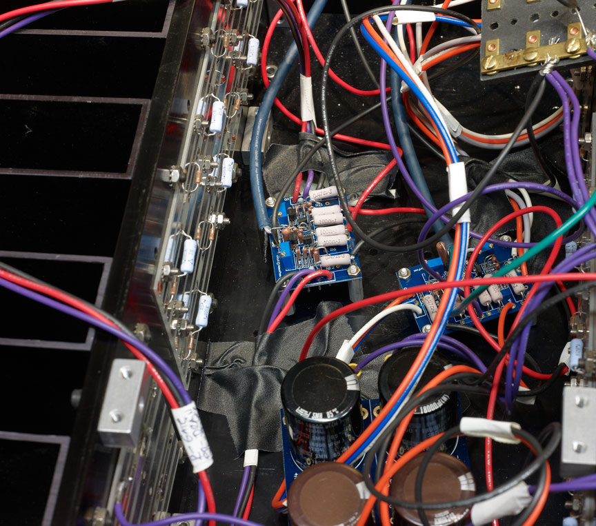

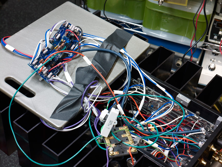

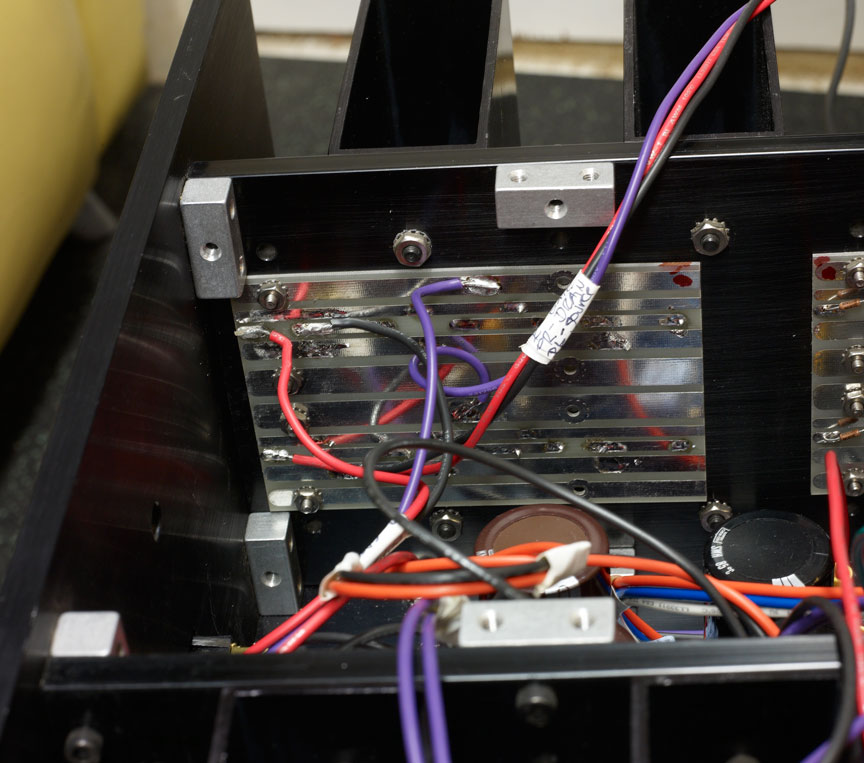

OK here is Peter's rectifier board temporary mounted on the heat sink.
Now, everything is temporary and very ugly at this point. I am using wires to connect everything in order to accommodate all the set ups I would like to do.
So far I did F5 and F5 balanced, and liked it very much. Here is the shot of that. Here you could see the boards that are connecting TO3 IRF devices. There are 6 P and 6 N devices per side, what makes it ideal to do different configurations. And here are the devices seen from outside.

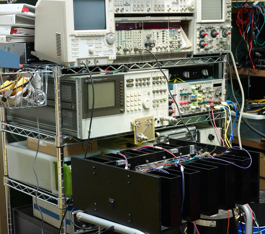

Like I explained, it is very ugly at this point, but very functional to what I am trying to do. Here is the shot of JX while I still have F5 in the case, so I am using the rest of the N devices in order to see how JX works. The case survived really well heating, no problems there.
I did test with total 4 devices per side, and like I explained I have only one channel so far. My test speakers are around 93 dB and they are 6 ohms. My lab, I was listening in, is not too big, but I do have experience with that space and speakers so I know how it will sound in my main system and room.
My interest is mostly to find the amp that has more power than Aleph 30, I am using now, but with that marvelous top end that amp has. I am using Aleph 30 to drive my ribbons in my active three way system. The the new amp I am searching for, will be driving my new set up for ribbons and mids. I would like to have that top end with plenty of headroom.
