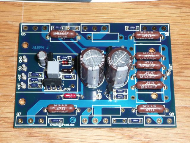

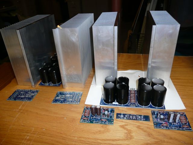

Here is the first fruit of Peter's boards pretty much ready to go ...
Going to try the Aleph J stereo first, then maybe AJ-X

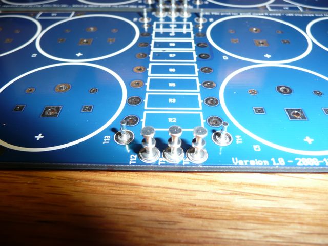

Were did you get those sweet turrets?:spin:
Keystone terminals from Mouser (stock) and Digikey (not stock). You need the staking kit and appropriate anvils but they are great for the power supply where you tend to solder and then re-solder it for different boards. I just bought the kit and a few bags of them to fit .062 thick PCB and .062, .090, .112, etc. holes.
