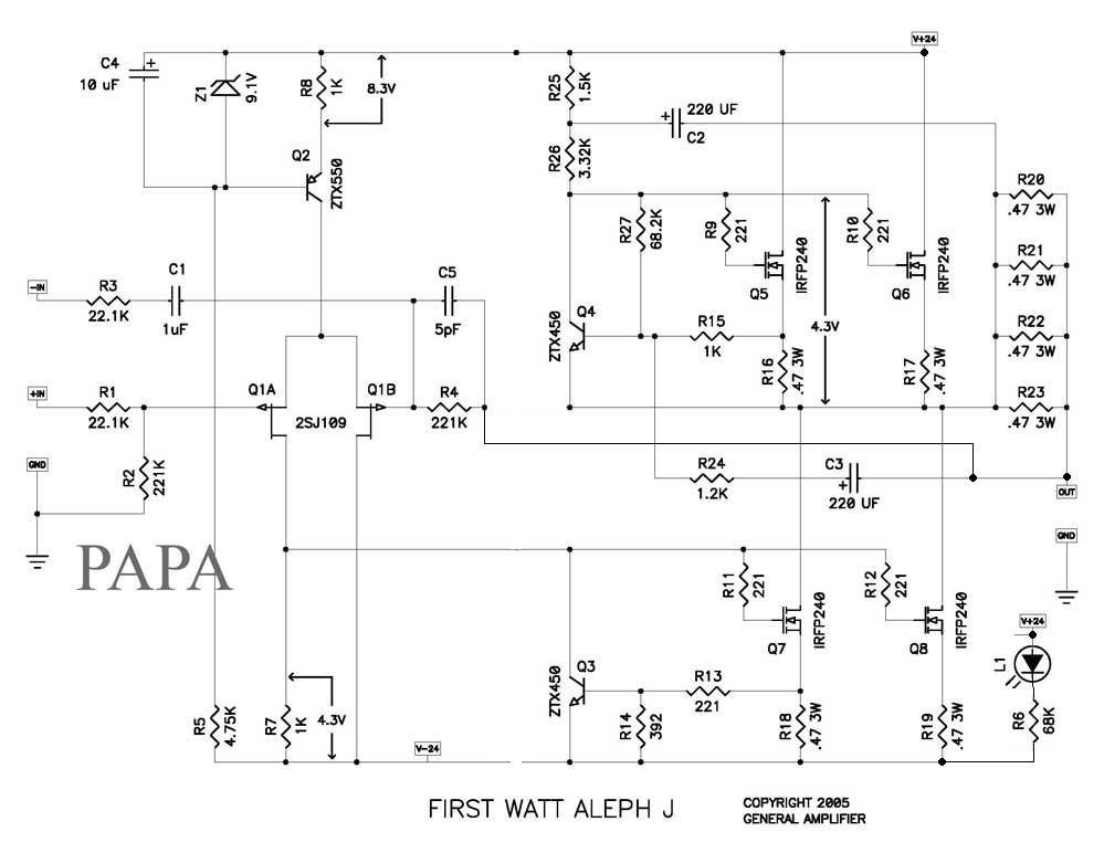

Shew ... read through 125 pages ... <so tired>
Anyway, I saw this addressed a few places, but wanted clarity.
If I only plan to use SE input, can I just omit R3 and C1 or must I ground the input side of R3? I am curious as a quality poly film 1uF isn't a "cheap" component and I'd like to omit if possible since I will never pass signal through it.
for SE input : short instead of C1 , ground R3
Thanx!

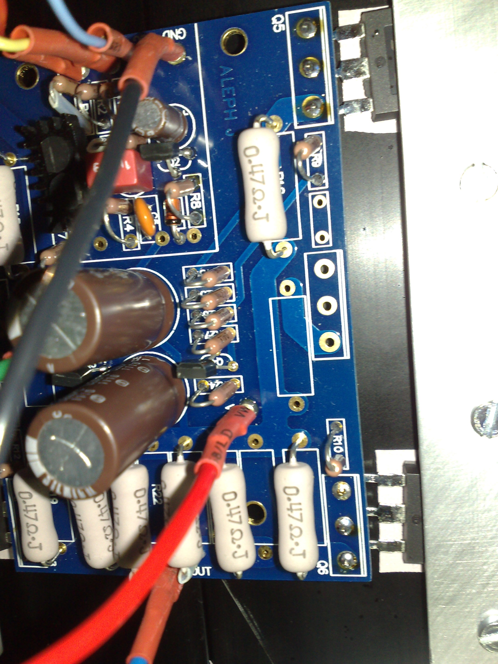

Problem with new build
Hi guys,
I finally got my powerchord for my variac and was able to test my new Aleph J this evening.
Quick recap of the setup:
I switched off the unit. Voltage dropped very, very slowly. When it was 0V I took out the variac and connected straight to mains. I switched the unit back on and had +30.5V and -30.5V DC (no load).
I then connected the amp boards and had nearly NO voltage. Checked to see what was going on and found that both fuses had blown.
I knew that the 1.6A could be a bit too small (1.6A is correct size for 300VA dual 18V secondaries) so increased fuses to 2A slowblow each.
I then disconnected power to both amp boards and switched the unit back on. No problem, +30.5V and -30.5V DC (no load).
I switched the unit off and waited for the voltage to drop. I then connected the right channel only. Switched the back on. Voltage steady at +27.3V and -27.3V DC.
The problem is that I have -24V on the speaker output!
I disconnected the right channel and connected the left channel only. Exactly the same problem.
Interestingly I noticed that the heatsink with Q5 and Q6 gets warm/hot, while the heatsink with Q7 and Q8 remains cool.
I am using Peter Daniel boards. JFets and Mosfets came from a reputable source (Hannes aka h_a). All other parts from Mouser and Digikey. Case is Modushop 4U 400mm full aluminium. Mosfets attached to heatsink using Kerafol.
Any suggestions? What should I try/do?
Thanks,
Albert

Hi Zen Mod,inputs shorted to gnd ?
I just rechecked. Both + and - are shorted.
- Aleph J Schematic
