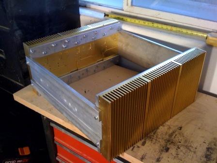

Heatsinks is a topic I always get hung up on.
I'm getting ready to put an enclosure together for a J. What I'm considering vertical box with heatsinks from barrredboss on eBay. He has an 8.5 inch profile that can be cut to length.
Would a 12 inch section per channel mounted vertically be enough? Or should I go bigger?
Sorry for the ignorant question.

salesmonster said:Heatsinks is a topic I always get hung up on.
sorry - I can't see any handy link in your post ..... these days my eyes are already sore from too much googling .....
That's not an ignorant question, many underestimate the HS requirements. I think Conrad heatsinks' website has some pretty good info on general guidelines.
I'm afraid a 12" length loses too much efficiency for one channel, but if you had them cut to 6" and made the chassis 17" deep you would be right at the minimum. Side by side they are quite a bit more efficient. Still, bigger would be better.
Best, Bill

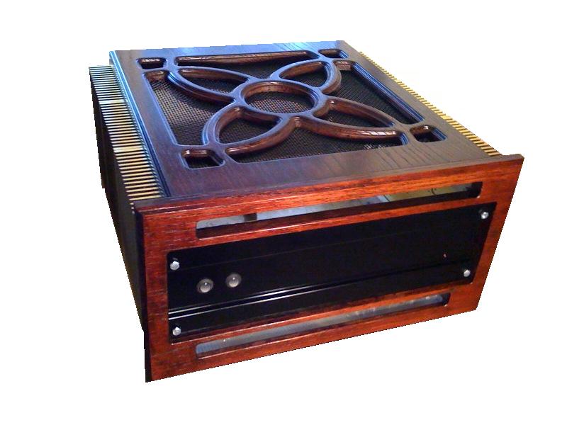

carpenter said:.....
Woodie - you're insane good with wood ;
carve one nice piece and send to Papa
