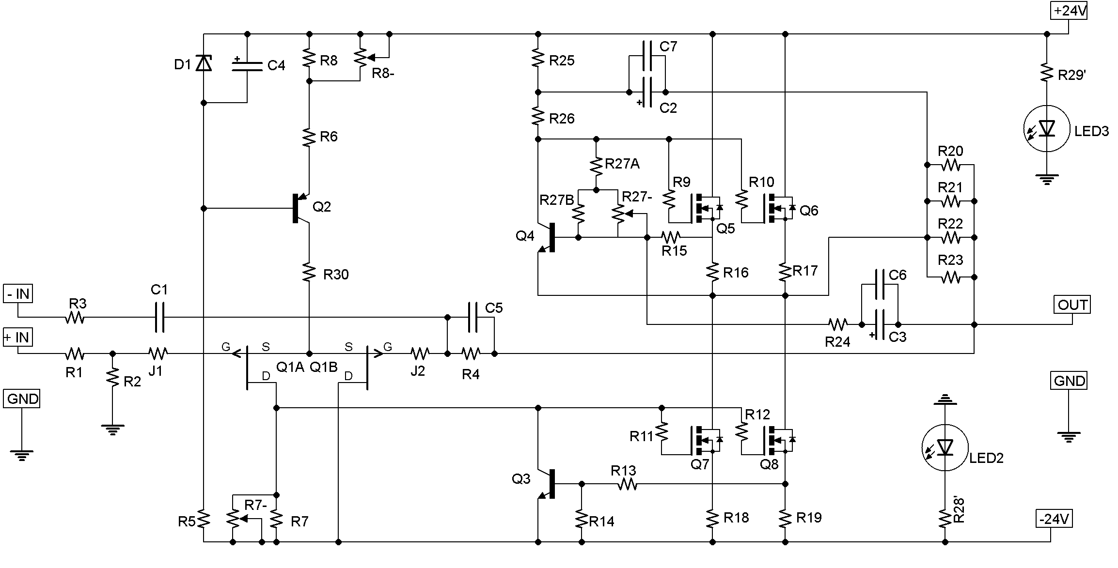

Would this mean changing R1 from 22K1 to 640R? R2 would in that case stay 221K.
As said, I am a novice, so please do not laugh at my question: by using another combination for R1 and R2 (say: 1K2 for both), would the gain change? I ask this because I have too much gain in the chain right now. Considering this, I maybe better have built a F4...

... and here's the Schematic

@ VDO
decrease R2 to 4K7 and inform
you can solder 4K7 to 5K1 across original one
Hi Zen Mod,
Followed your advice... and it works like a charm!
Although the main hum inducer turned out to be a dimmer), the hum is even les now. In fact it's very quite in de listening seat.
Thanks.

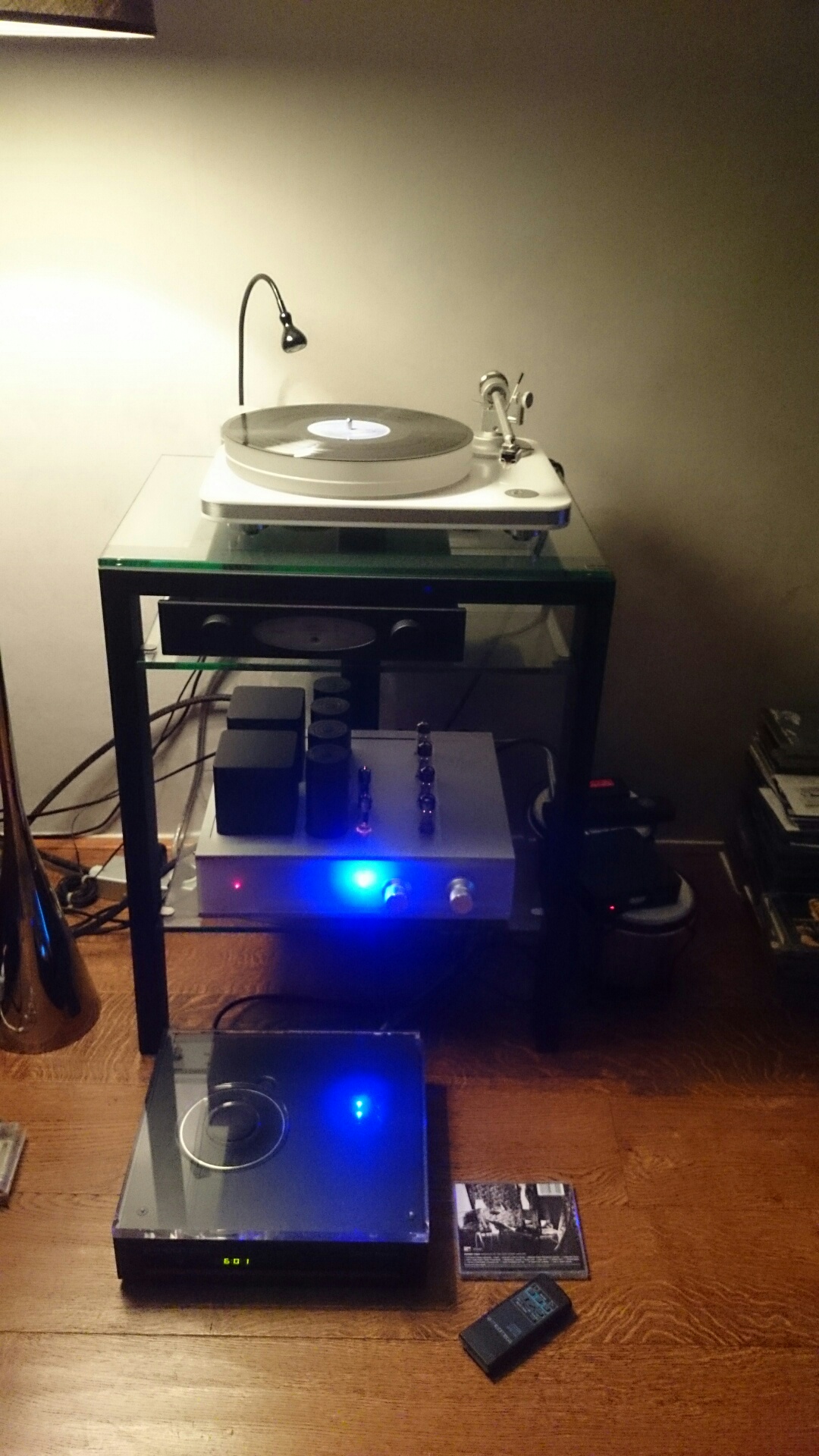

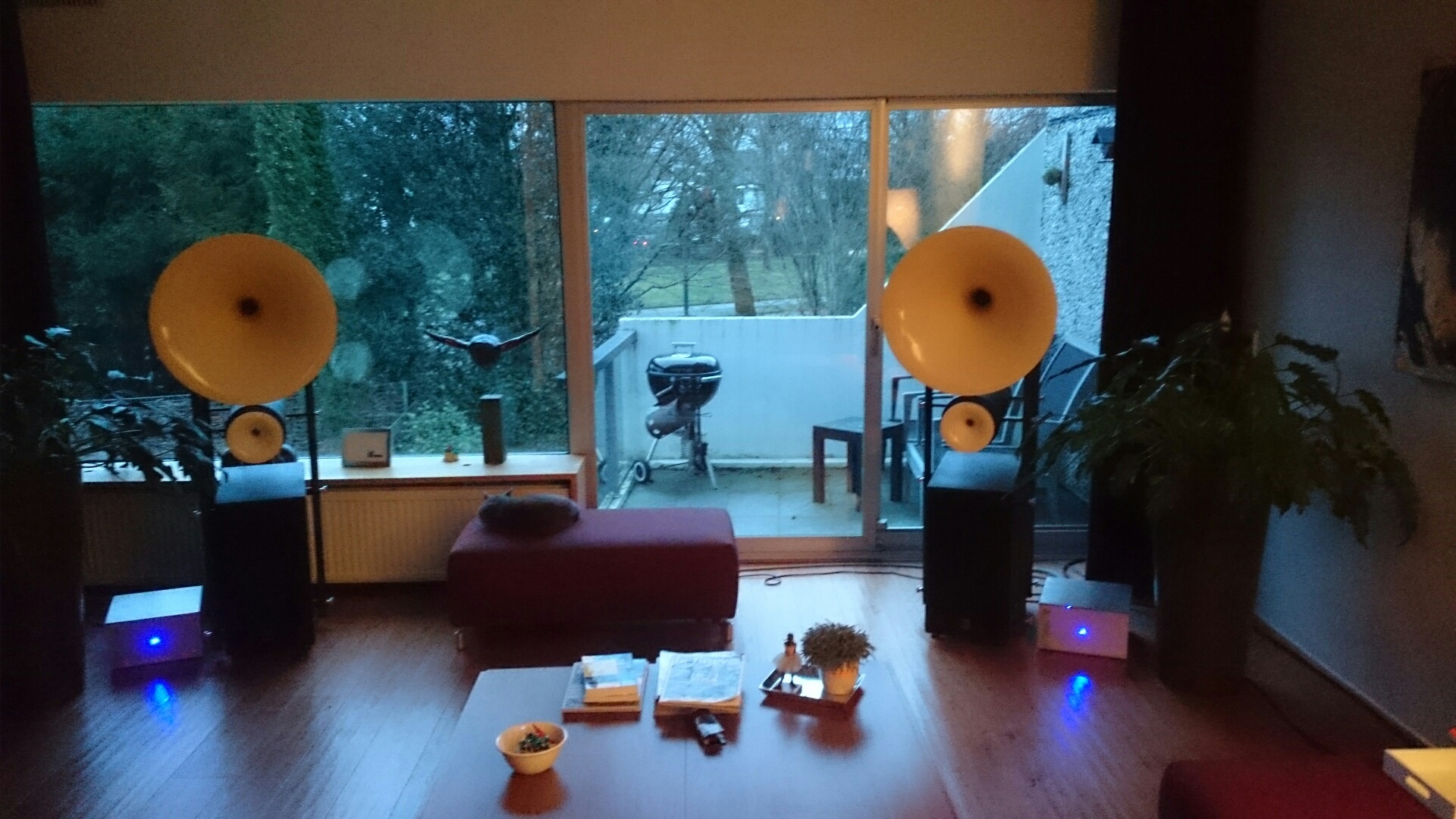

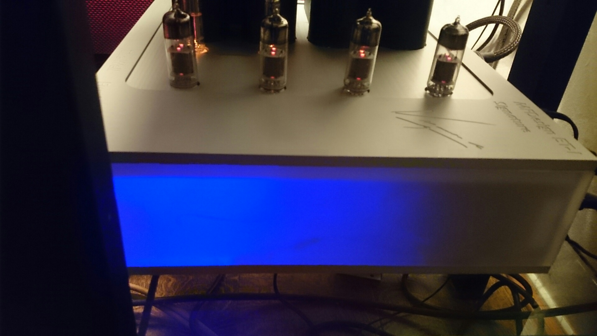

Now that everything works, here's some foto's of my rig...
