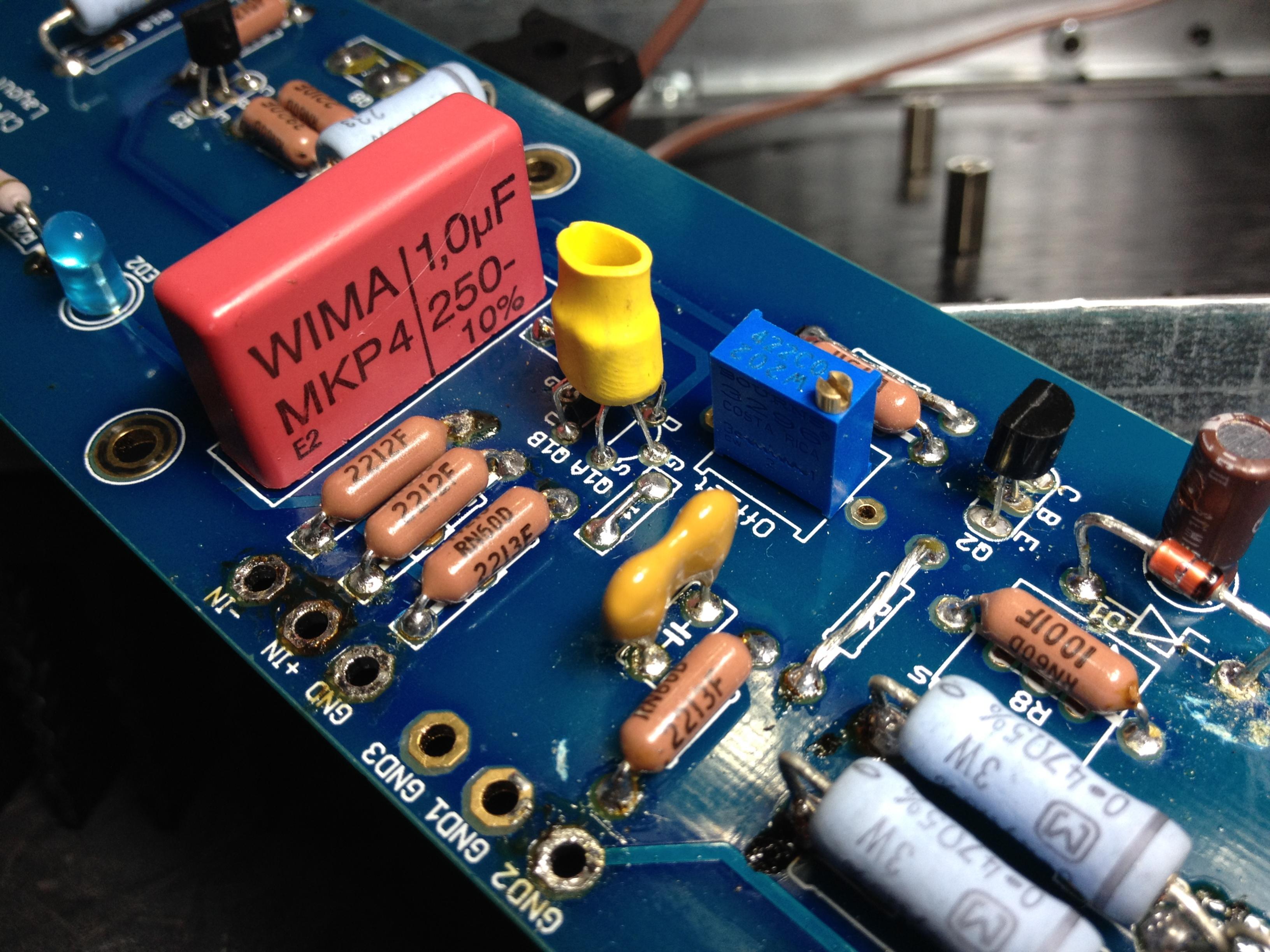

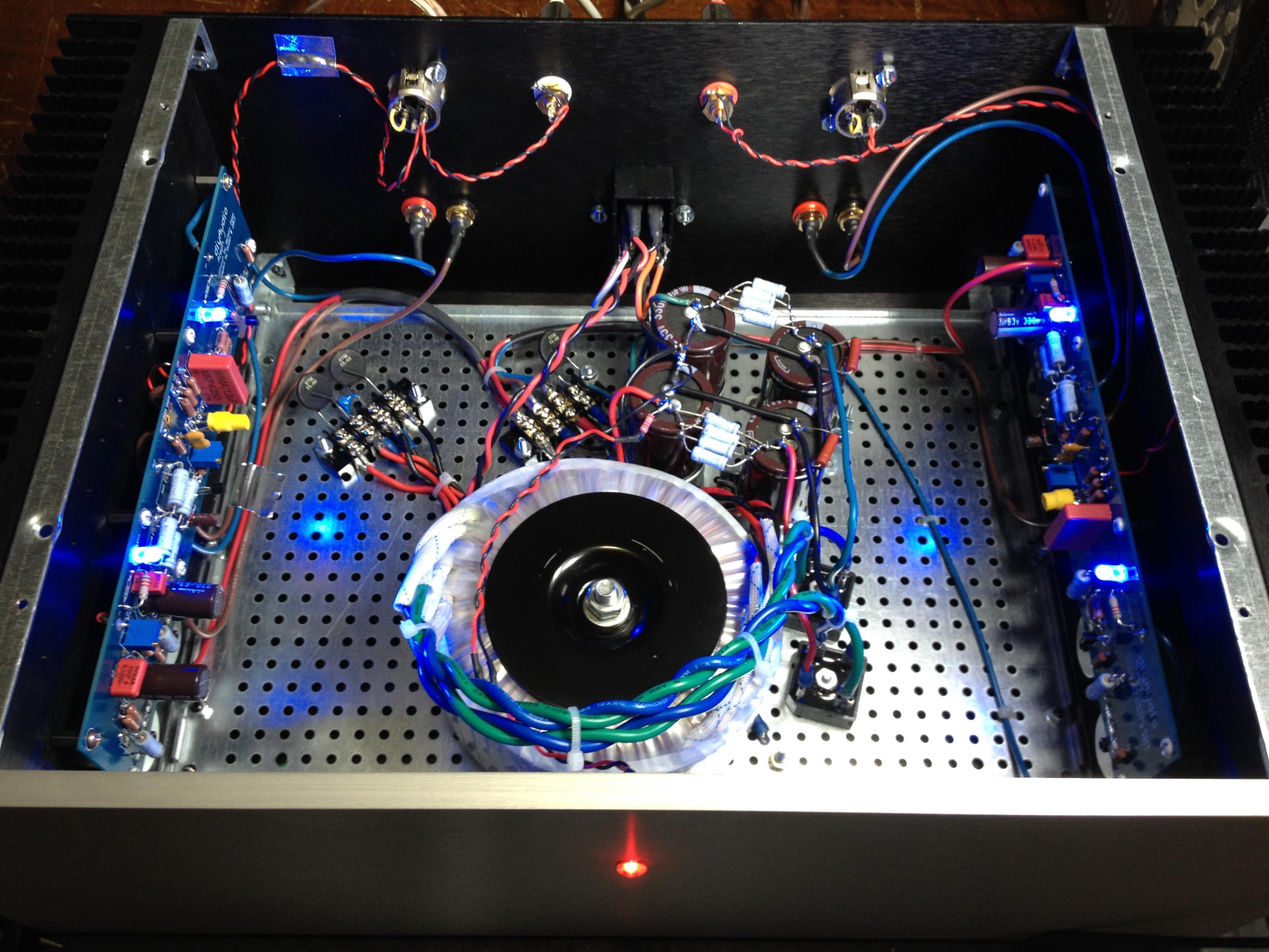

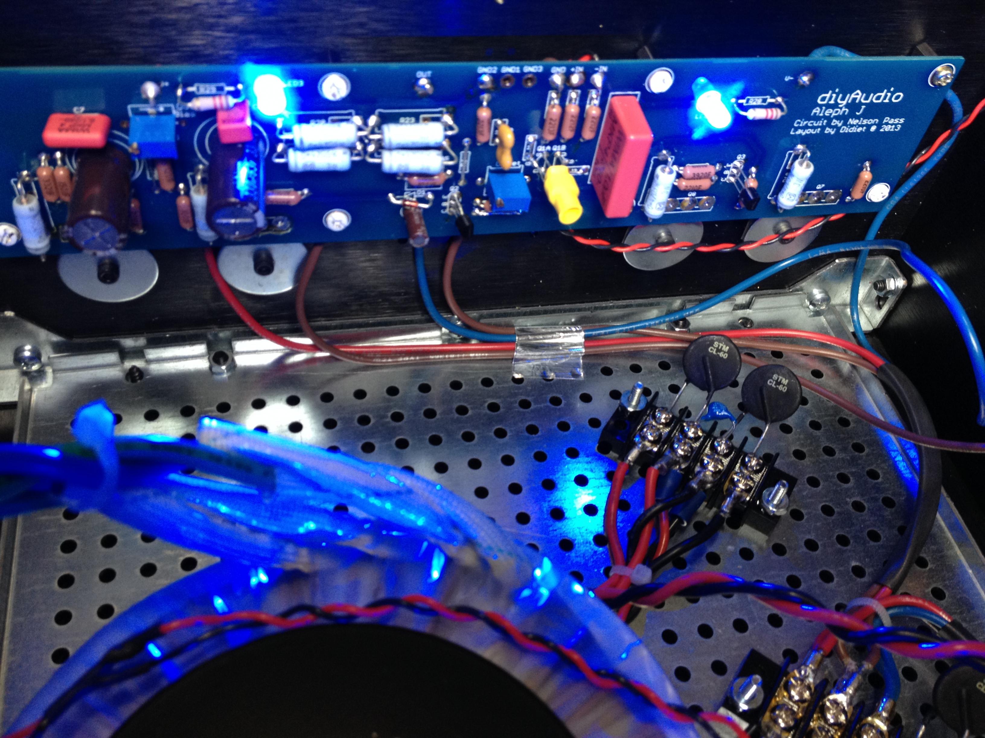

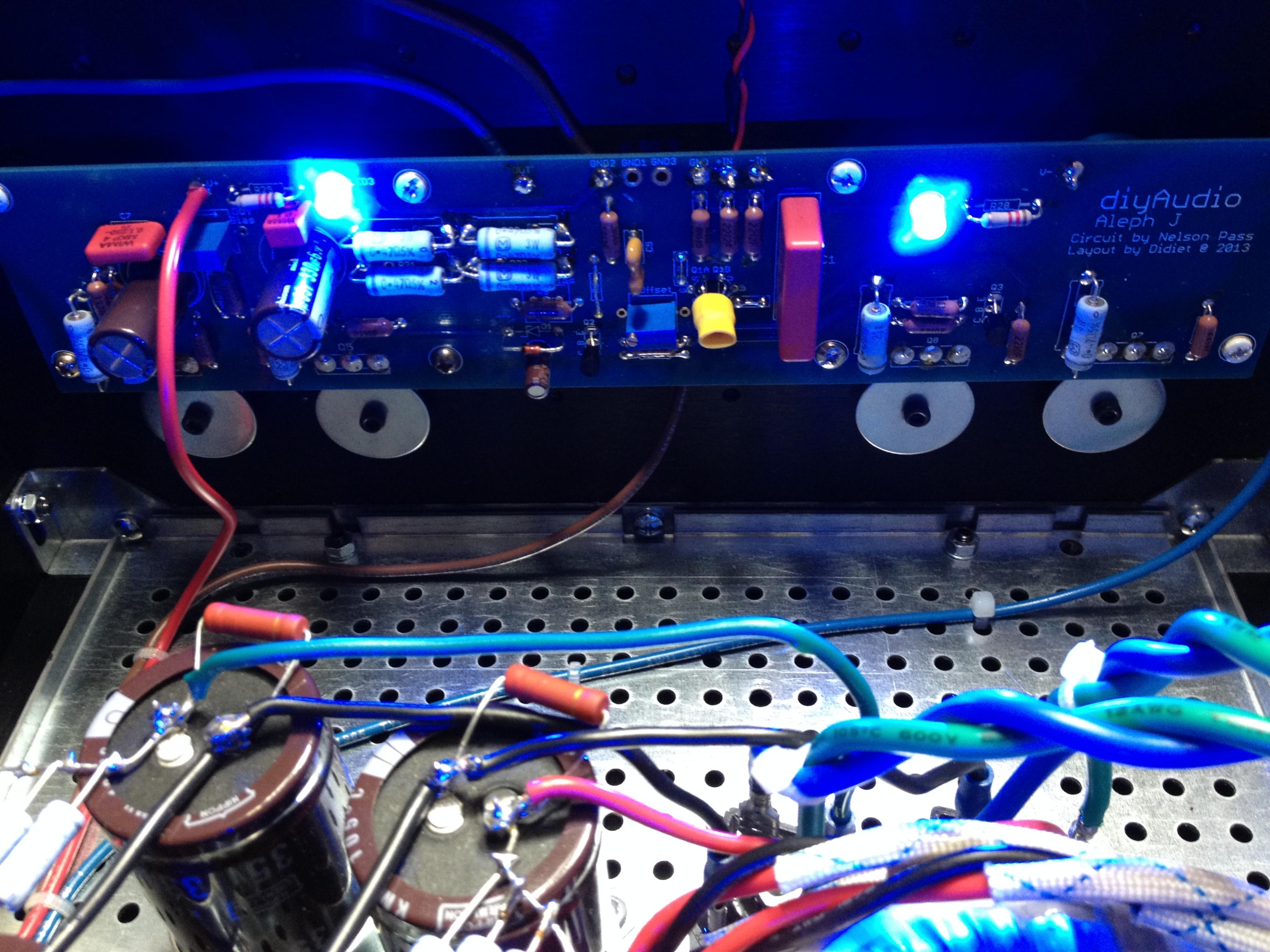

The only time the hum went away was when I removed Q1A and Q1B. Unfortunately, I did not follow advise and got them off the eBay place.
So the amp didn't hum when the jfets were removed? With the input stage disabled and it quiet means that 1) It's most likely not PSU hum, and is a wiring error, or bad devices themselves.
As all eBay K170/J74 are assumed to be fake, I think you may have figured it out...
I will have to do that again unless one of you comes up with a pair of Linear Systems J74S or four Toshibas J74S that they want to sell me. PM if so or point me to a member that might have some to go.

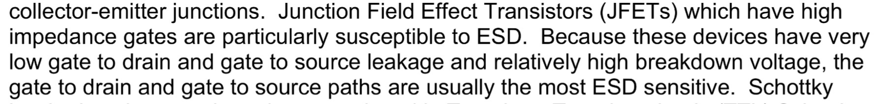

If finally you get new jfets at home
take care and handle them without ESD: electrostatic discharge.
Antistatic gloves is useful sometimes.
Best regards
http://www.superiorglove.com/industry-gloves/electronics-gloves/anti-static-electronics-gloves
http://www.navsea.navy.mil/nswc/crane/sd18/Public Documents/ResourcesElectDischargeCons.pdf

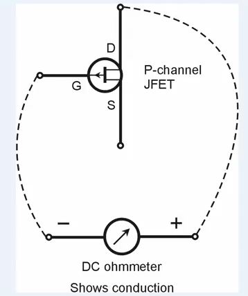

Thanks, I appreciate that video. Here is the P-channel version from the same gentlemen: How to Test a P-Channel JFET - YouTube
According to him, these (most likely miserable fake) Linear System J74s JFETS are bad and are from eBay. There is no conductivity as he suggests there should be. My meter is pushing 2.4 VDC for ohms testing at low resistance, and still does no come through the junction. See photo diagram, my meter does not show any conductivity when probes applied as shown.
If anyone has some real Linear Systems J74s out of a circuit, can you test this result?

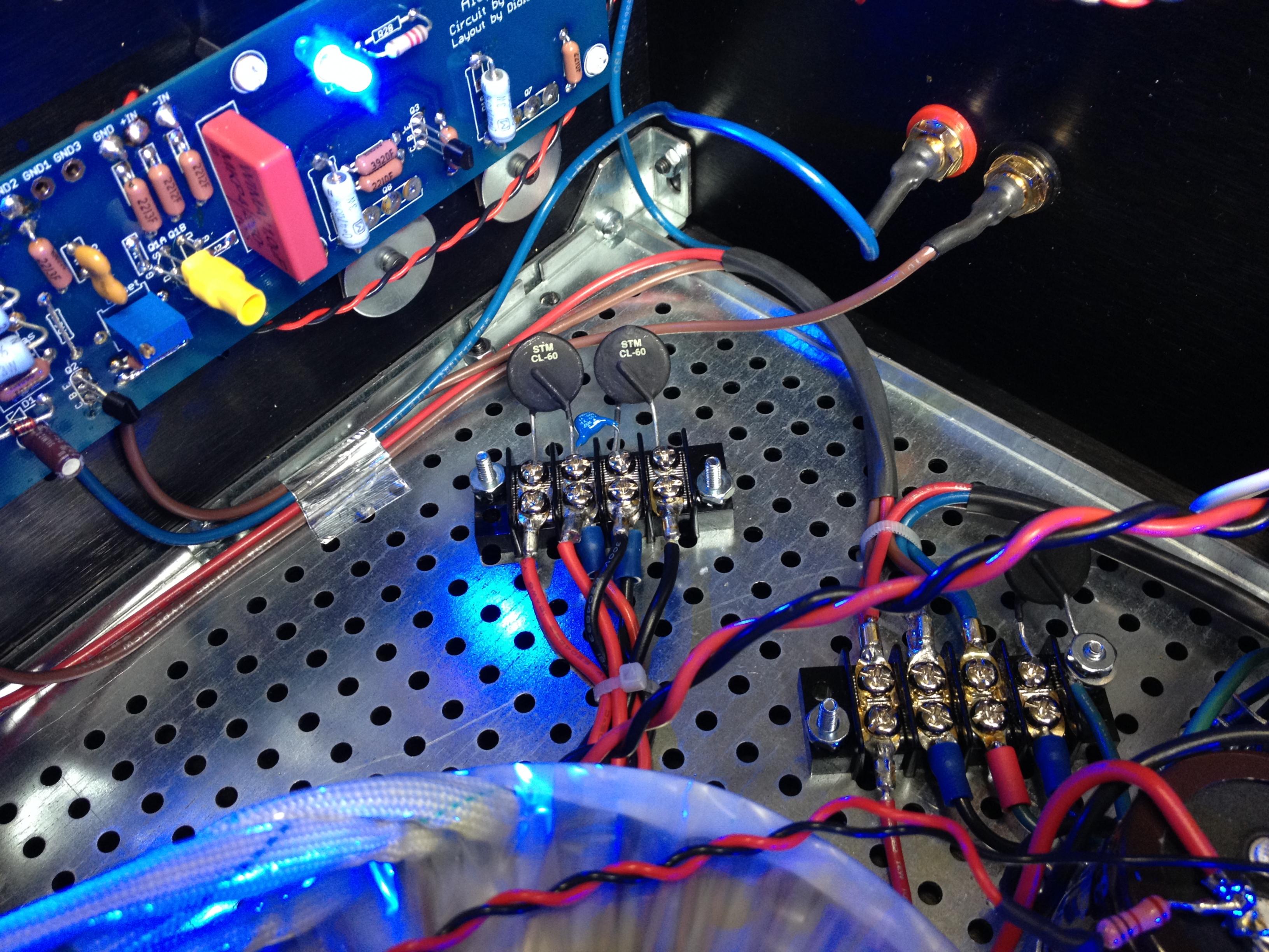

When I was having problems because of my toasted outputs, ZM commented "Please toss those horrible automotive connections". (see post 998)
I am starting to connect everything and have this same supply of Tyco Electronics connectors. I want to set up my amps so I can switch boards in and out if I want to and do it with some ease.
I can't see why these are so inferior. They are not gold, but do the job. Aesthetics, connection integrity, sonic effect? Why so "horrible"?

So the amp didn't hum when the jfets were removed? With the input stage disabled and it quiet means that ... bad devices themselves.
This is the conclusion of the whole problem, the noisy channel was due to a bad new pair of Linear Systems J74s from a US eBay seller. Fakes?
A pair of Fairchild J76 did the trick wonderfully, no noise whatsoever. So the other channel got them as well. They might be lower in transconductance, but not sure. All other specs seem to line up OK. I reset DC offset, BIAS seemed to not need much readjust.
This story has a happy ending, the amp is extremely quiet with no stray pickup or noisy transistors.
Thanks to you all, I ended up with a better wiring route and a lesson for future amps.
