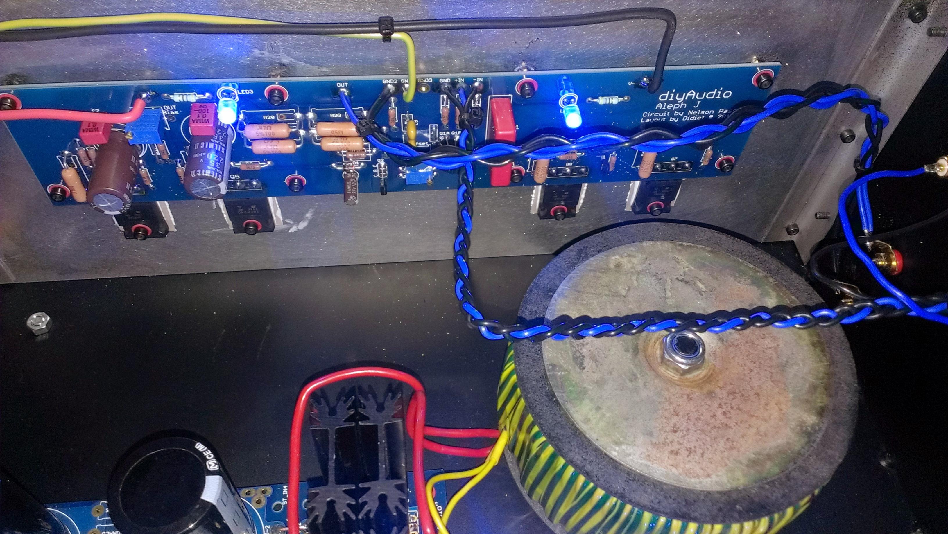

Input from single ended is -- RCA center to +IN, RCA outer to GND, jumper -IN to GND.
Thats the best photo I have, it's a little small, sorry. But you can see the fine blue wire from -IN to GND, the white fom RCA outer to GND, and Blue, RCA center, to +IN
Where is C1? omitting that is going to cause problems. Are your Jfets still good?

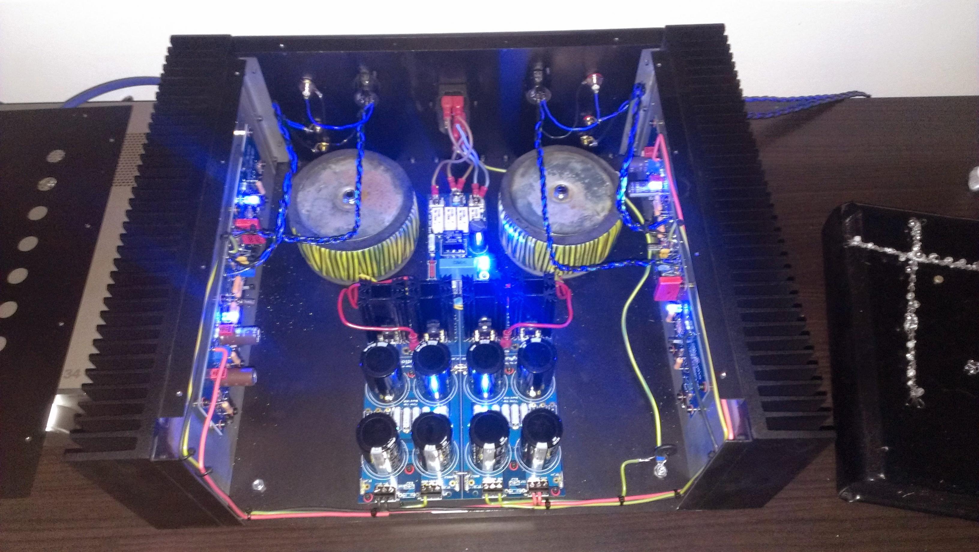

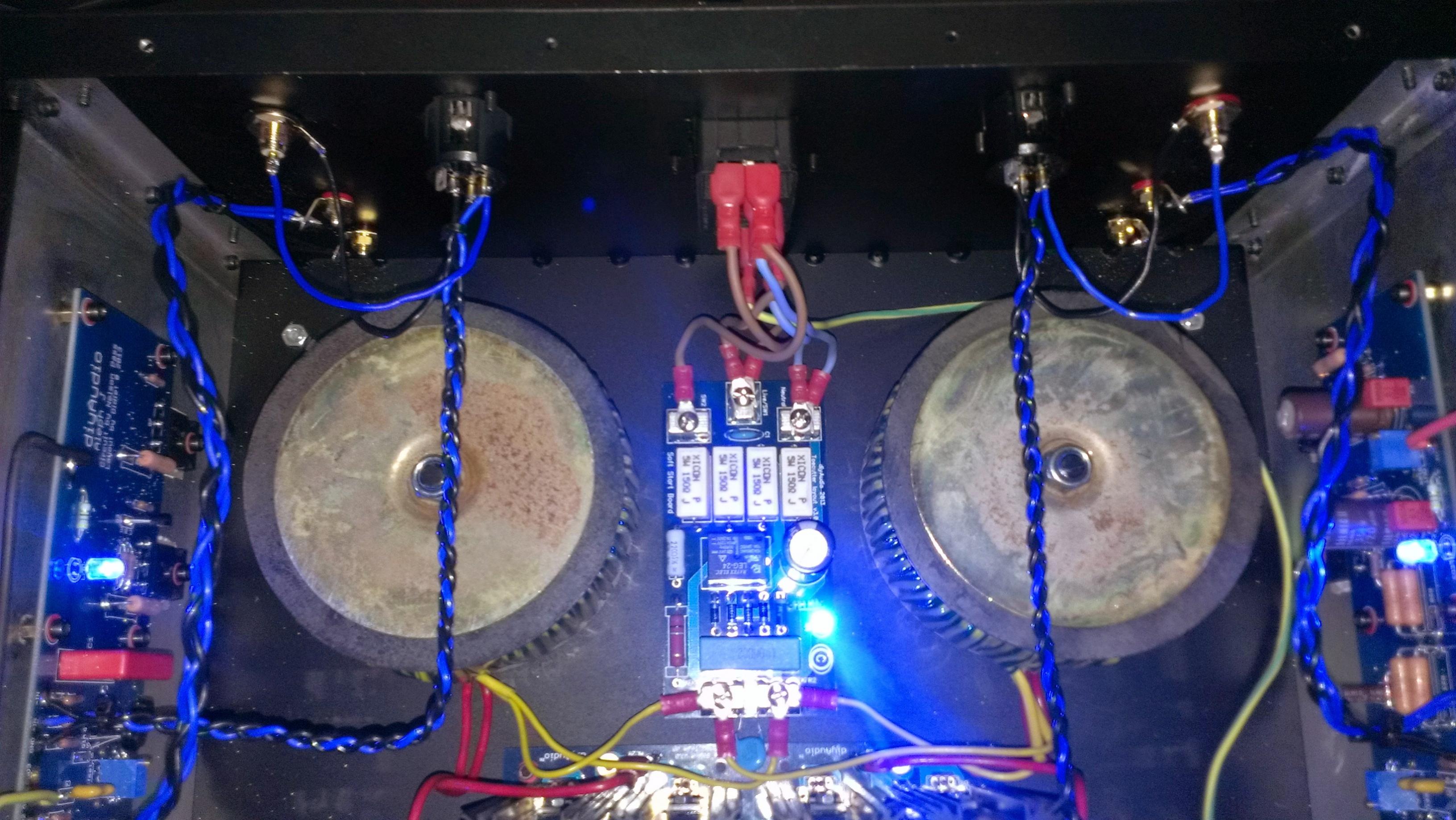

Hi, so I finished the first of two Aleph J amp:) And the sound good, as good as I had hoped.
But there is a little hum from speakers, when only the amp is on, is normal or what?
When I turn it off, it gives the bass unit a large puf but doesn't say anything. What can be wrong?
I have installed soft start board
I am missing the front

I worked hard to keep my input and output wiring as far away from AC cables and the transformer as possible. I still have a power on noise, despite a soft start board too. I get a tolerable power off noise. No hum from my amp, with sensitive speakers.
I also have an intermittent switch on the front that controls a solid state relay for on/off, and am unsure if that is causing my noise. I need to take a look at changing the capacitor to further retard the power on process. Either that or scrap the soft start and just try the slow start with the CL-60s. The oversized 400VA tranny, and similarly oversized cap bank are somewhat at fault.

Hi krath, very nice. Good idea to use two transformers and two PSU boards. Your can try these steps:
1) reduce the area between the wires connected to the RCA connector.
2) Reduce the area between the wires connecting to the diodes.
3) Perhaps the wires that connect the PSU to the PCB are too long.
4) Pin 1 of the XLR is conneced to the wrong place ( see: http://www.diyaudio.com/forums/diya...udio-component-grounding-interconnection.html )
