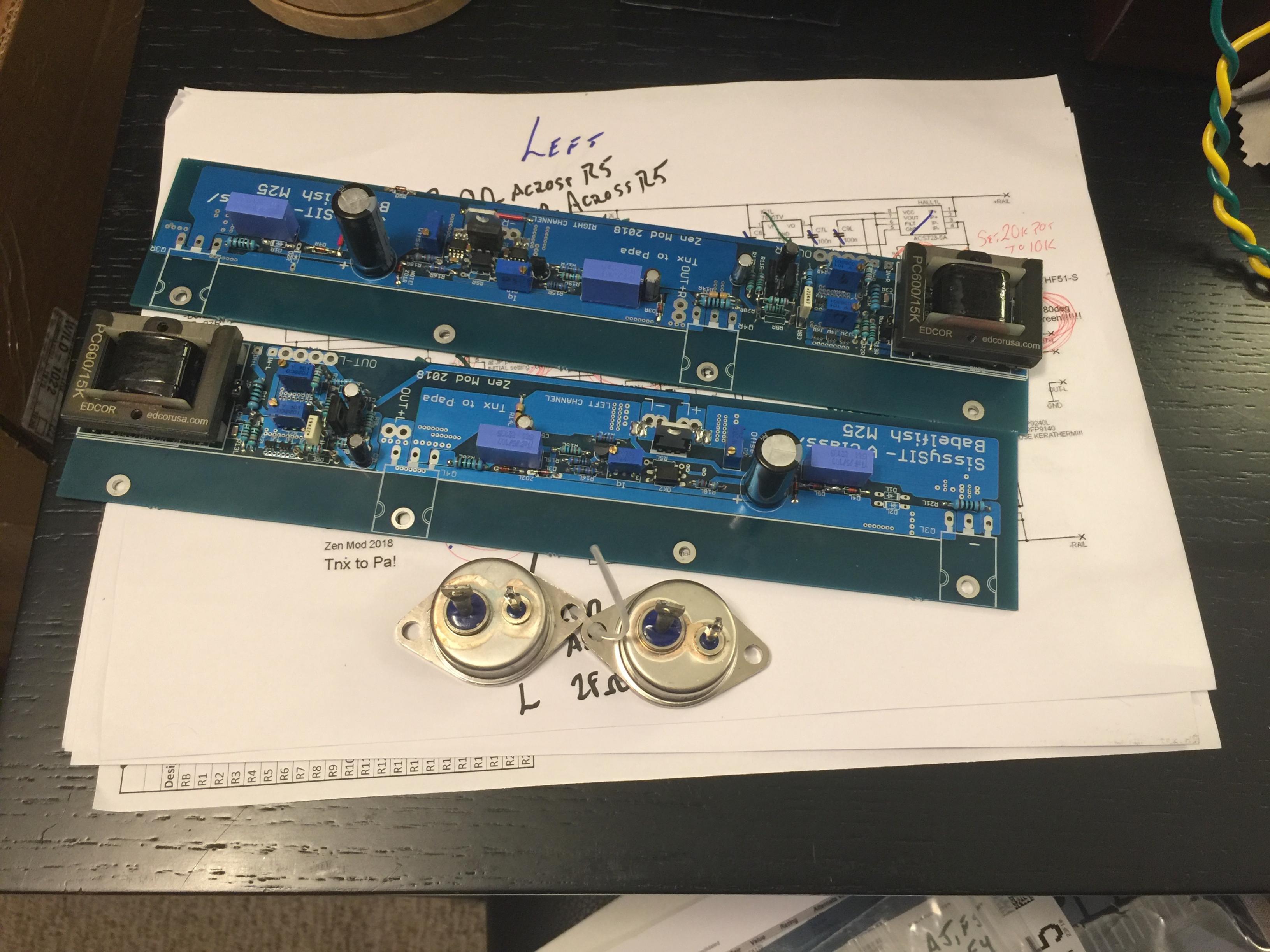

Well, now it's time to learn how to match MOSFETs. 😀
The topic of matching seems to be covered quite a bit particularly for the JFETs. However, I have only found a little bit of information on the MOSFETs.
I found a few mentions of it, but in this article linked, it seems relatively straight forward.
http://www.firstwatt.com/pdf/art_matching.pdf
First a few questions please.
1) Is it critical to match these at 22V - 0.4A? I see that the ones in the store are matched at those parameters. Can I achieve a good match at a lower voltage and/or current? I'd prefer to not need to put each of these on a heatsink. However, if it is critical or even advisable, I can can make it happen.
2) If I have a laboratory DC supply to set at 22V that I can current limit to 0.4A and a DMM, that should be all the tools required, correct? If I can set the current limit to 0.4A, do I need any resistors in series with the drain?
Edited to add - Thank you Dennis. It looks like we were posting on top of each other.
Edited again - I also found this. PassDiy Last section covers things very well.
So, my main questions are regarding the resistors and proper operating parameters.
With thanks as always!

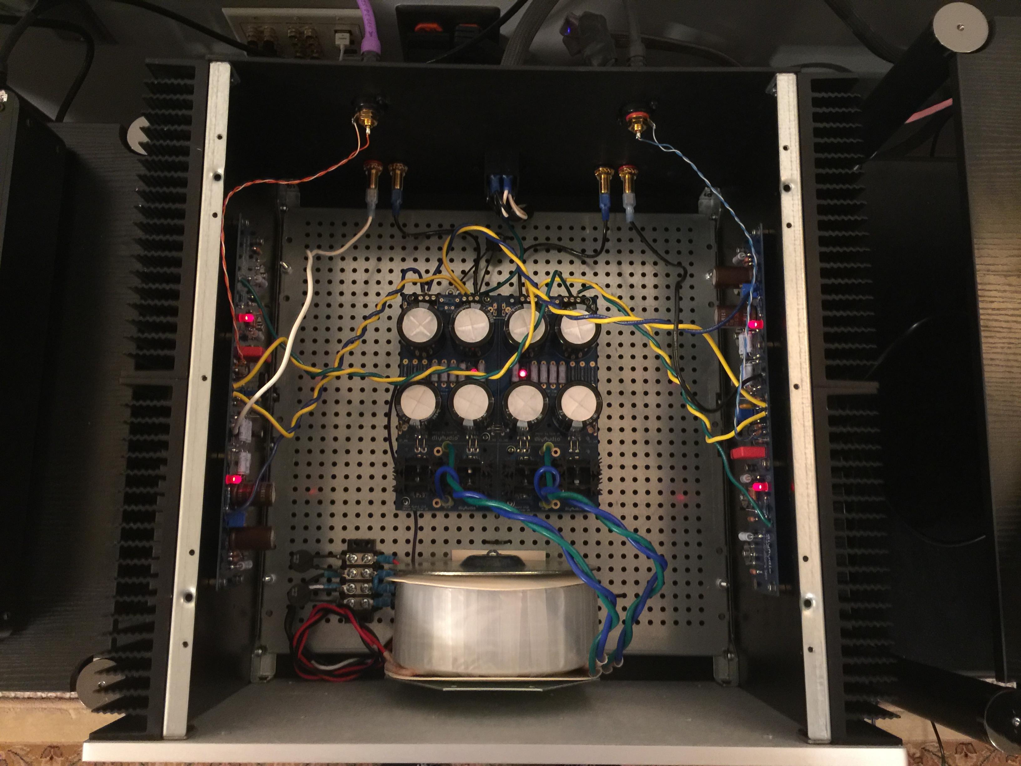

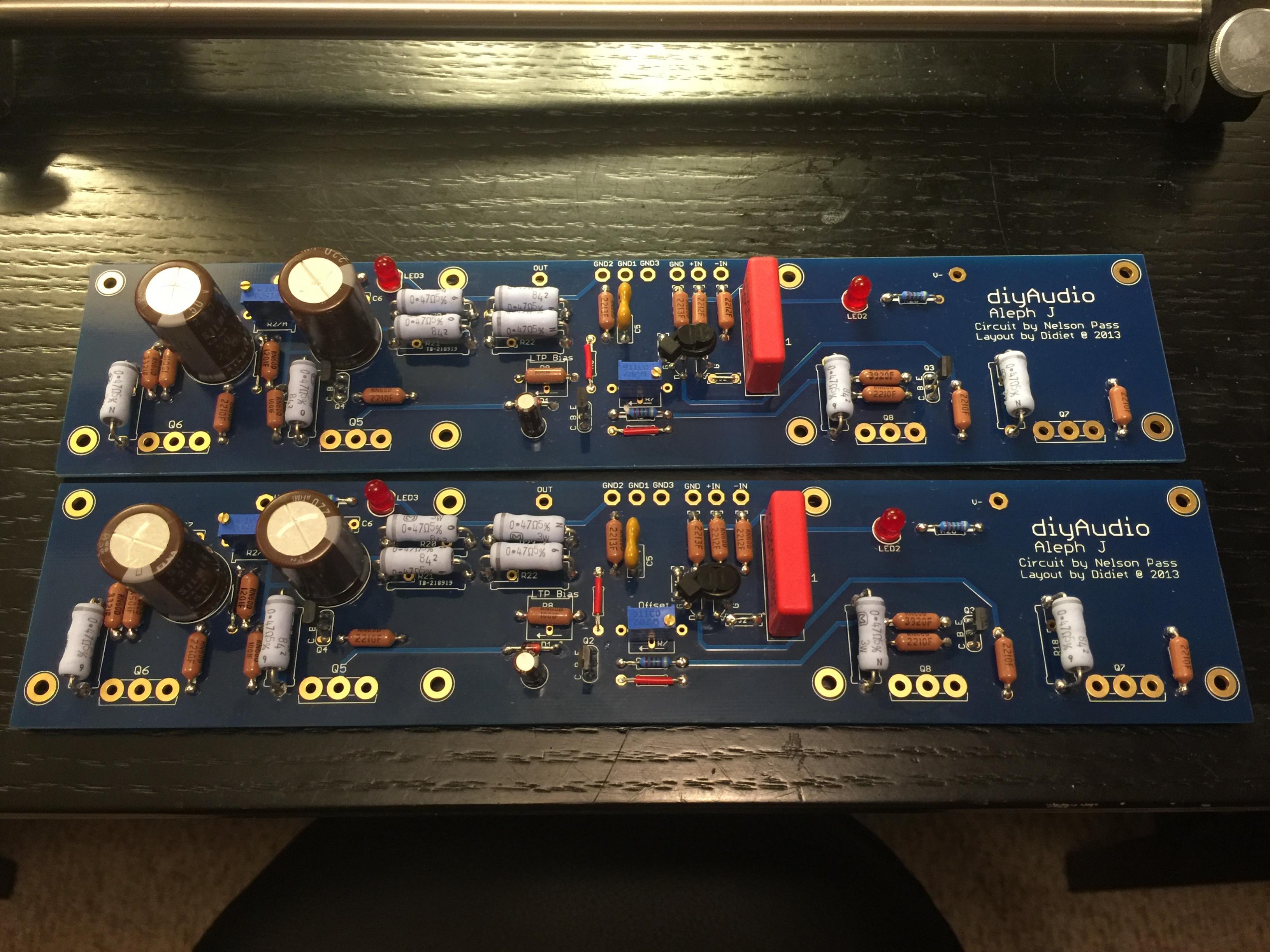

Well, I thought this was to be a post of resounding triumph. Not quite.
Everything went smoothly with the board installation etc. I've powered up both channels and done the initial checks. I can't get the amps to bias past 289mV. The pots are "to the click".
I saw earlier in the threat that could be attributed to forgetting to put in the R27 jumper, but I put that in. I suppose the good (or bad) news is that it is on both channels. I set them to 68k per the guide prior to powering up.
The good news is DC offset nulls like a champ.
I've re-read the thread and my notes. Pics of the boards are in post #3762.
Any help is appreciated.
With thanks!

OK - Well, I'm never afraid to admit I goofed. Particularly if my goof may help prevent someone else from doing the same thing.
Always! Check your DMM, and don't start building at 3am b/c you're excited to hear your new amp.
I had my DMM set to mA instead of MV... DOH! Jim clearly explained how to do it properly in the build guide (and kindly caught my error again).
What an awesome group. It's got the lid on cooking... 😀
We have beautiful music! Set properly to 0.40xV on both sides with <1mV of DC offset. I goof up literally the last thing in the build.... DOH!
