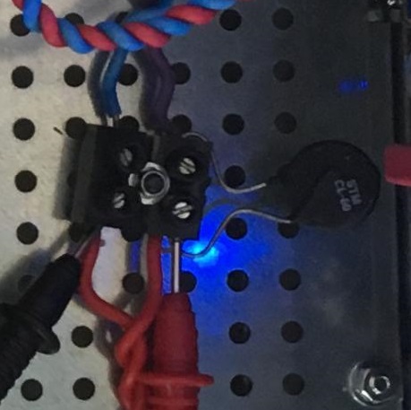

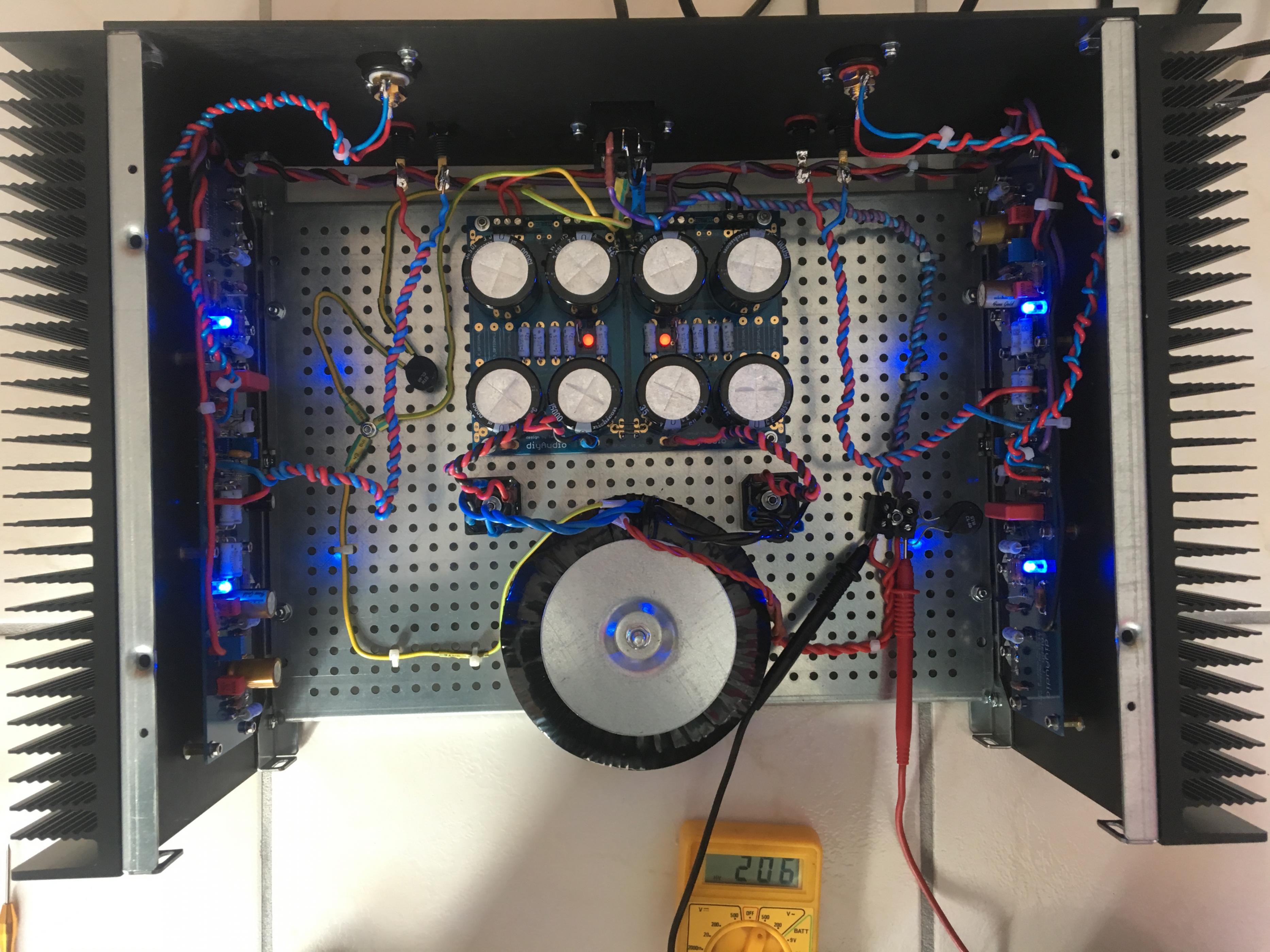

Hello,
My aleph J is finished and working, I am very happy, but I have one question :
On the picture attached does the CL60 thermistor is correctly positionned ? Is a capacitor in parallel necessary(like in the standard Pass PSU) ? It's because the amp make a big "pop" in the speakers when it is switched on or off.
Thank a lot for your responses.
which thermistor ?
practically - you need to have 2 of them - one in series in xformer primary , second between audio GND and chassis , and chassis must be connected to safety GND
Thanks, so i'm good with it, on the right down in the picture, near the wires of the DNM, one CL60 is in serie the primary, and a second thermistor (on the left up of the picture, with yellow/green wires) between PSU ground and chassis, which is connected to the Ground.
as I see it - that NTC in terminal block (where probes are ) is connected on one terminal , practically nonexistent in circuit
you need to connect it inline - in series with one primary wire
besides that , ensure proper isolation/distance to chassis - way you did it is dangerous - it can touch chassis .....
Ok, that's what I was thinking too, I will correct this wiring tomorrow.
Thanks a lot.
What benefit does this CL-60 in series with the primary wire brings when compared to the series with the ground? I see that almost all the builds use this thermistor in series with the ground->IEC earth rather than primary wire.

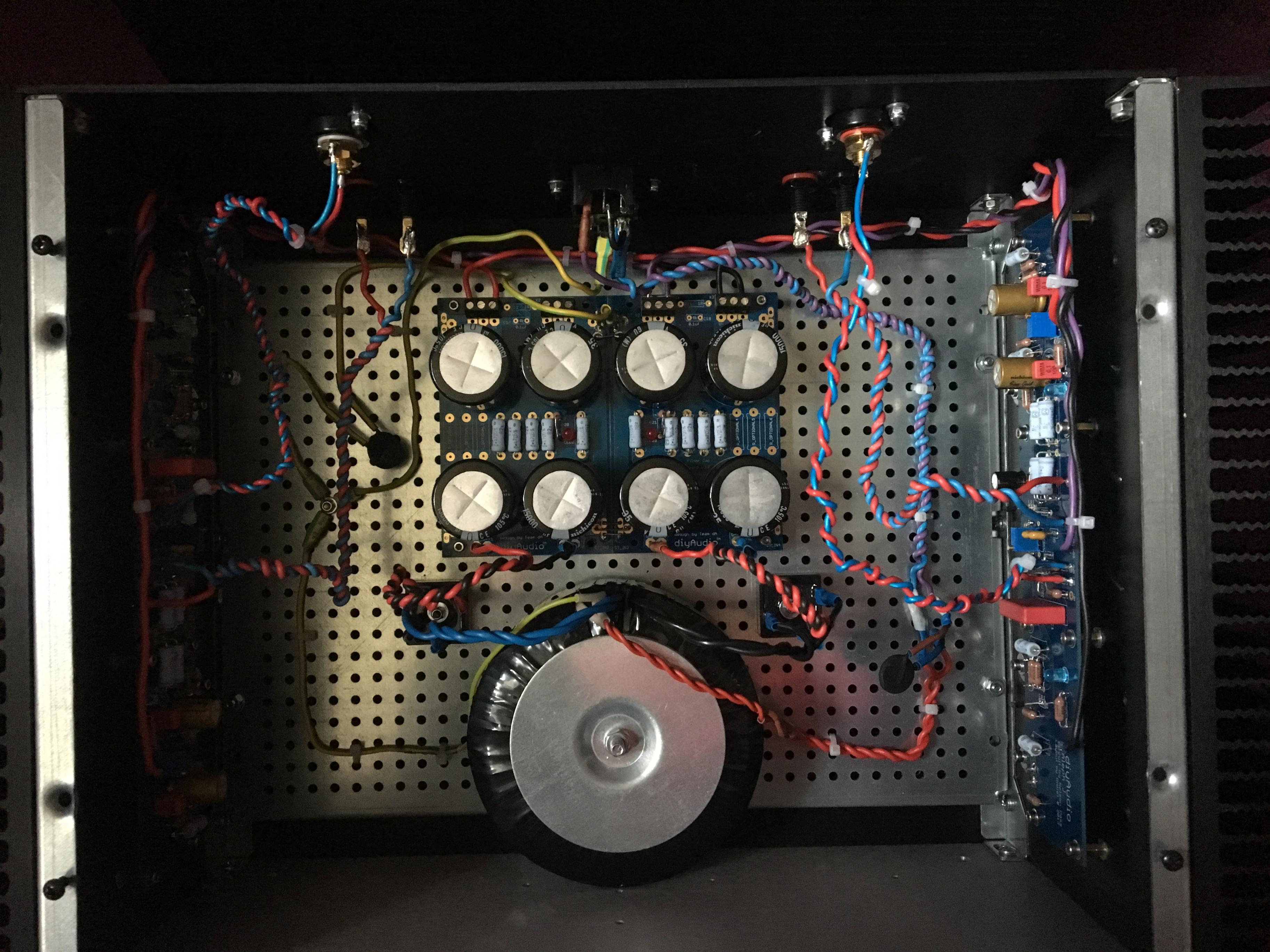

Hello,
after the modifications of cl60 thermistor, the amplifier is working, but I have a canal dead quiet, but the other have a weak buzz (of 50hz I think), as you see on the picture attached, it's the canal on the right, where the wires of AC (blue/violet) passed.
Can I put the AC Wire ((blue/violet) which goes to the red/red of the primary,) under the perfored steel plate to make a shield to avoid this buzz or it would be useless ?
Thanks.
Thanks.
Can I put the AC Wire ... under the performed steel plate to make a shield to avoid this buzz... ?
ofcourse you can ; but this would be best after doing the proper wiring arrangement as suggested by Zen.
it is even highly advisable to have all the harneses behind a steel shield; i do not know why everyone exposes his/hers wires
I have a 400va Antek in my Aleph J and have a CLC power supply with 25kuf 10mh 47kuf filter. I did not use any surge limiting. The amp powers up without any noises from the transformer and it runs quiet. I recommend the 400va Anteks. They are not expensive but perform well with no mechanical hum in the configuration I am using. I have the 20v version and I bias a little hotter than spec. Idle power consumption from the line is 270w so the trans runs quite warm.
So you may not need the cl60 surge suppressor at all. I also run with the audio ground connected directly to the chassis without any hum issues.
You might get away with not using a surge limiter , but I did not. I built four F5 mono blocks all tied to a common power strip which I used to turn them on, and constantly tripped a dedacated 20 amp house breaker. I installed the CL60's on each amplifier and have not had a problem since
