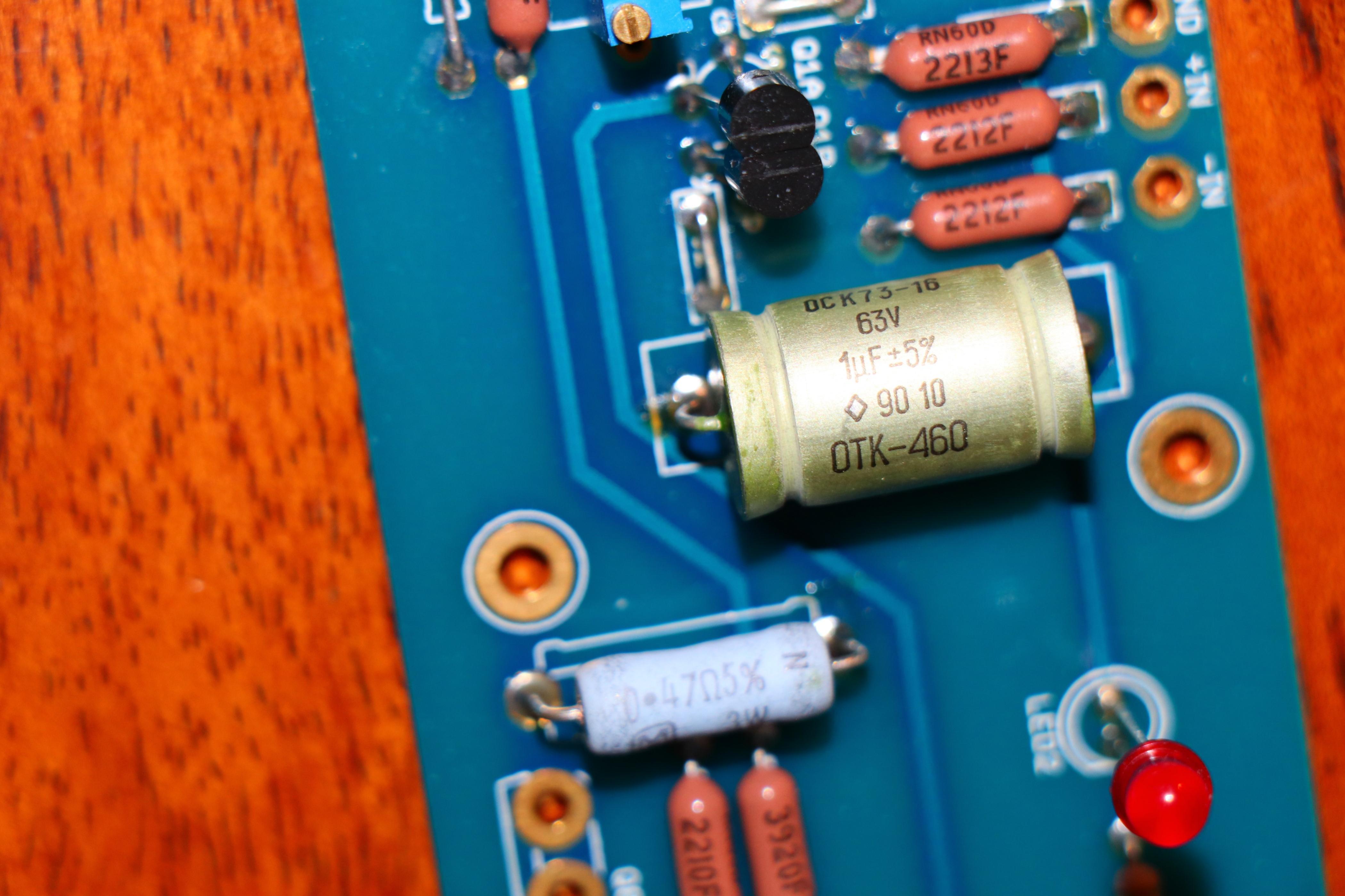

Finished my Aleph J boards, now on to the PSU.
I bought a matched 2SJ74 quad from Spencer at FET Audio | Hi-End Audio Projects when he still sold them quite a while back. They matched perfectly for Idss.
I changed C1 from Wima MKP4 to a Russian military/space/atom grade Polyethylene-Terephthalate (PETP) capacitor OCK73-16B 1uF 63V +/-5%. We'll see how it sounds, and if it is an improvement. Not only does it fit well, it also looks the part with the matte golden colour.
I also used a Nichicon Muse capacitor in position C4, and increased the value of C5 from 5pF to 10pF.
I have a question about the precious 2SJ74 pair: can I put a small piece of shrink tube around them, or is it better not to heat them too much and use a small cable tie-wrap?

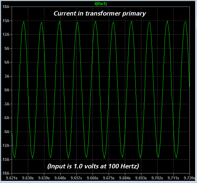

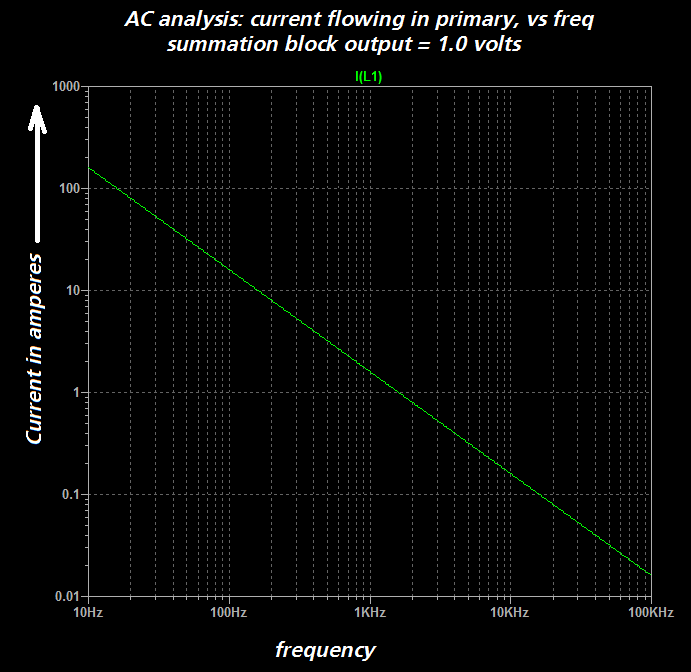

Hello member teodorom,
I think you may wish to increase the self inductance of the windings of your simulated transformer "L1 L2 L3". When they are 100 microhenries as shown in post #3237, the simulated currents that flow in the transformer are enormous! Almost ±15 amperes peak to peak, more than 10 amperes RMS at 100 Hz: wow!
I suggest you think about increasing the self inductances by a factor of 1E4 or 1E5, to make the simulated current values smaller and more realistic.
_
