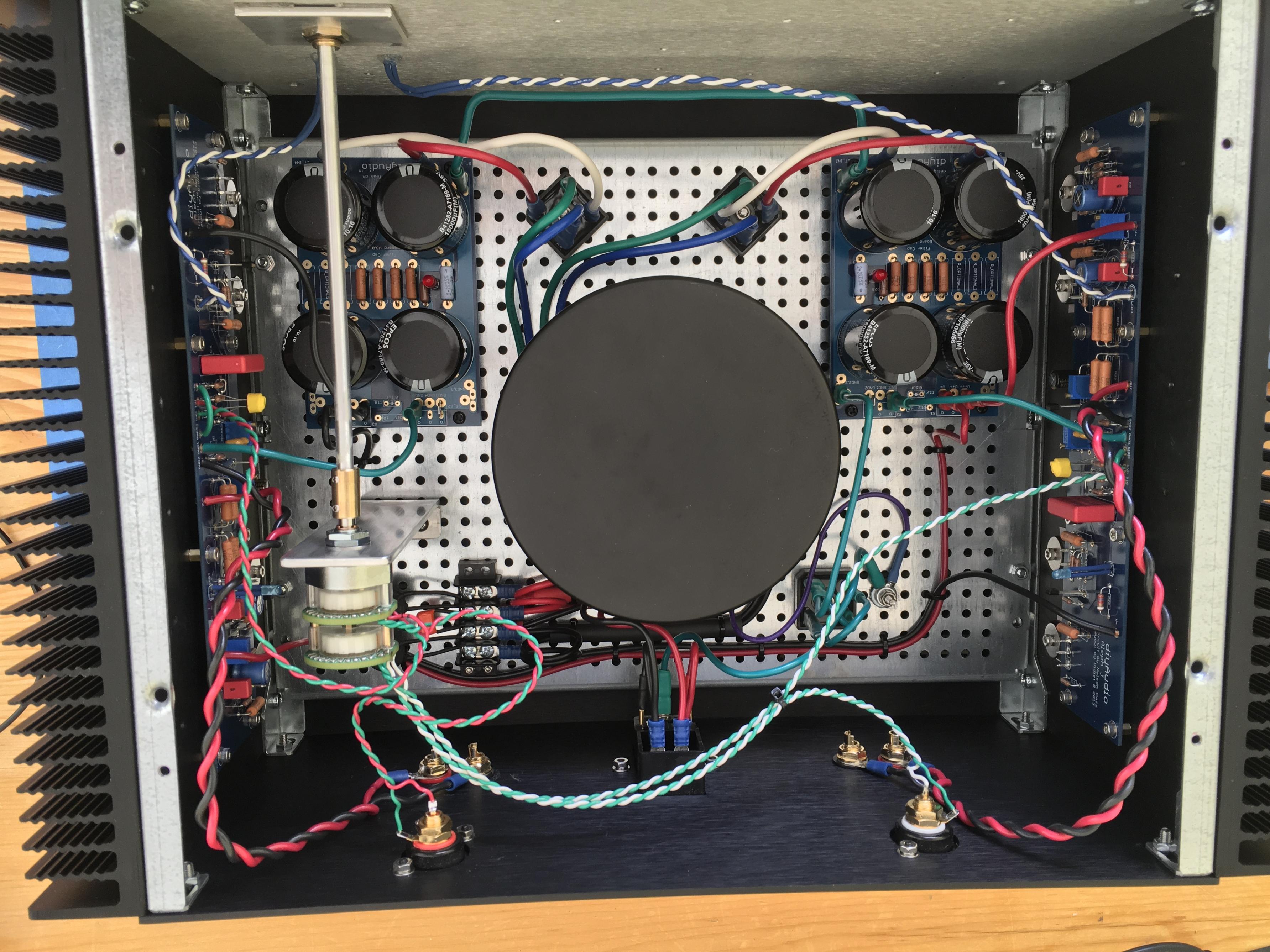

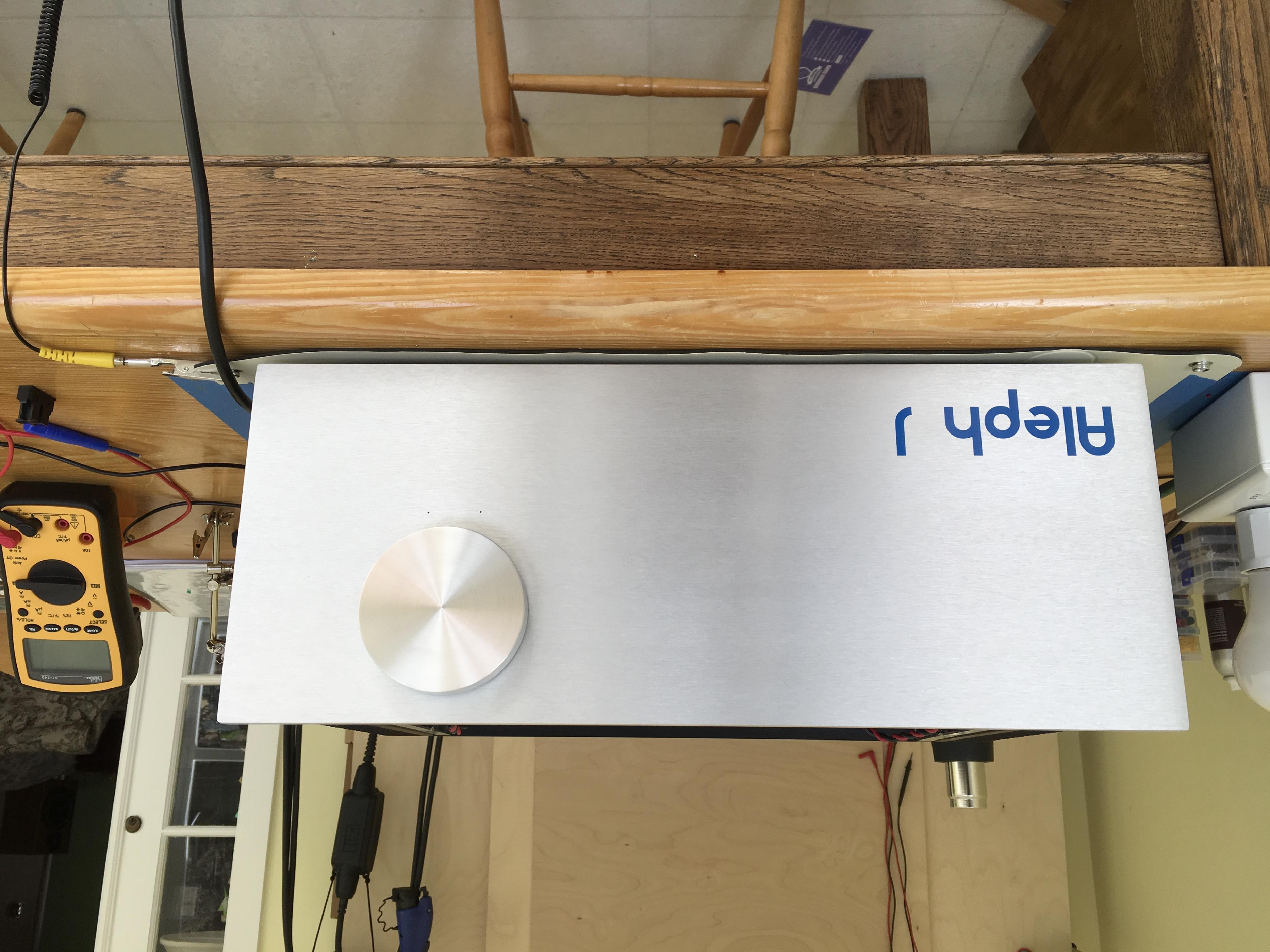

Just finished my first Aleph J build! It isn’t up and running as it’s blowing the .5Amp 250v fuse I had on hand. It did pass the light bulb tester.
Looking at the FirstWatt Aleph J manual it states a 4Amp 250v slow blow so I’m guessing that is what is needed. Is this correct? Anyway had to post a picture, just cause.
Edit: Sorry about the upside down picture, I’m a goof.
Nice work, Scott! Looks like you have some thermistors under your volume pot, so this should help with power inrush at turn on, but you do need a bigger fuse. A 4A fuse should do it, though you might get away with a 3A...
Whose transformer with a cover did you use? Is that from Antek?
Hi Eric, thanks. I’ve ordered some 4 Amp fuses and should have them Monday thanks to Amazon. I used .5 Amp fuses I had purchased for the Pearl 2 built last year without giving consideration to the fact they may not be the correct size. Pretty foolish on my part. Live and learn, the devil is in the details, absativly! Both the transformer (model 3218) and cover are from Antek. They make nice products.
