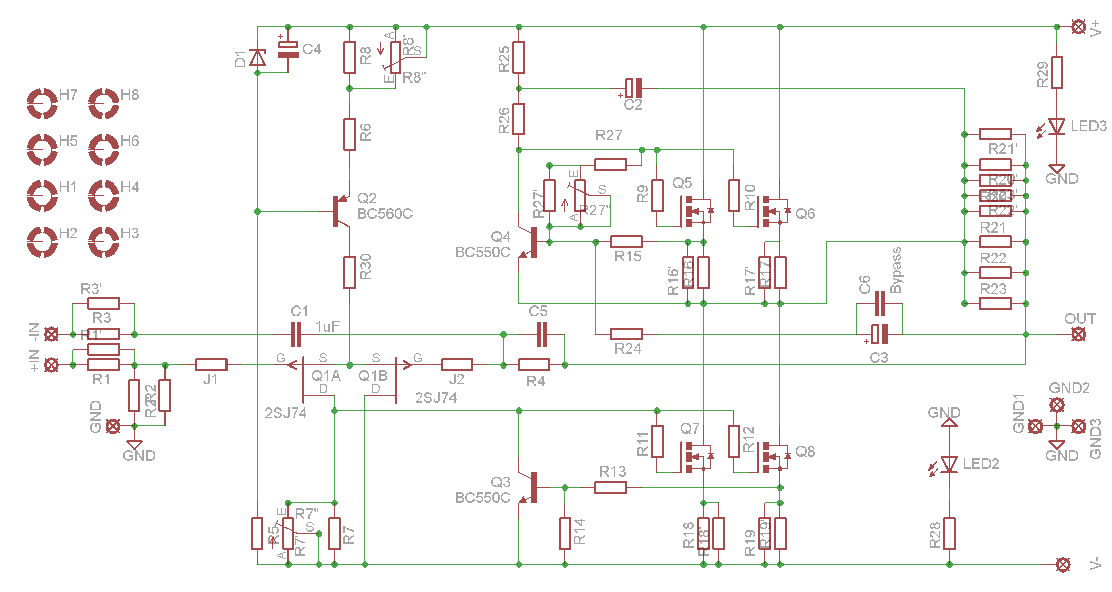

small resistors in Jfet gates are there to prevent any possibility of oscillations ; use them , or not , but it's always nice to have place for them
resistor in series with pot , in bjt emiter (input LTP CCS) is to allow usage of smaller value pot , so you have broader range (more turns) for fine setting .... in same time securing that you'll always have minimum (fixed) resistance there ;
resistor in collector side of same bjt - to burn some dissipation on it , not everything on transistor ; if voltage is Ub-9V , then it's safe to burn some 6-7V on it
bypass caps ( small red rectangulars) - obvious reasons
pot in series with fixed resistor in Aleph CCS - almost same reasons as for pot in LTP CCS
in your boots - I'll use small BF245C CCS , in series with R5
in fact , I already was in your boots - made Babelfish J ........ even if (today ) it would be somewhat even more complicated - more LEDs , LTP cascodes

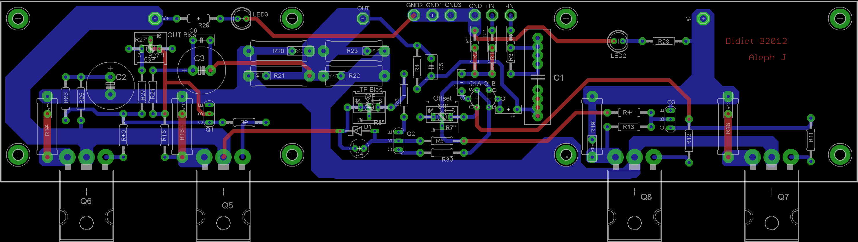

1. Is it possible to build Aleph J 60 with j74 in the front and 6 outputs?
Yes. Use the Peter Daniel boards for that.
2. If yes, why not make convertible boards like Tea-Bag's F5T with the same front end topology but optional number of outputs? Personally I think this is the way to go for DIYers.
There is already a board that can do that, Peter Daniel's, and there have also been conversions of the Chipamp.com boards to use the Jfet front end.
The other thing about lots of outputs is that you will need to start paralleling the long tail pair, to give more oomph. So now we need a matched quad of J74 per channel? That's a tall order. If Linear Systems ever makes their J74 replacement, then maybe, but as for now, it's simpler to keep it a set design.
The inclusion of the pots on the PCB and some other tweaks is still a matter of serious thought for me. I really wanted to keep it as simple as possible...
One thing that we, as DIYers don't have is access to a zillion transistors like Nelson does when building his circuits -- he was able to match his transistors much more tightly than most of us can, because he had access to so many. We will have to tweak the circuit with resistors and variable resistors to get everything tuned up and humming.
There is nothing wrong with that, and arguably it's a cheaper and more precise way to do it -- But it adds complexity to a circuit that is going to be built by enthusiasts of many different skill levels, and I'm hoping for many completions.
I guess when it's all done I'm trying to make the best board (and project) for the "Aleph J", instead of a flexible board for many versions of Aleph amps.

Another Update
- Add gate stoper for JFET
- Add Cbypass for C3
- Add Resistor for Q2
Didiet

I totally agree with 6L6 to limit options which are not directly related to the base Aleph J.
He is right, the base amp is an excellend sounding device, but depends much on the quality and matching of the active - and some passive - devices as JFET's, MOSFET's and caps. As we don't have the choice to select the devices with the right parameters out of a big stock as Nelson has the opportunity, we must build in the posibility for some tweeking but not much more.
But putting too much options into the new design increase the risk of wrong or insufficient tweeking.
Thus keep it simple as possible to allow the majority of DIYer to build and tweek this amp in relation to their possibilities.

But putting too much options into the new design increase the risk of wrong or insufficient tweaking.
This is my conundrum - as the board sits right now, the standard build is going to use 4 jumpers, and likely 2 resistors instead of pots.
That much flexibility is going to cause some confusion. Of course, the quality of the build guide will hopefully explain what all the extra options do and why you may need/want to use them...
