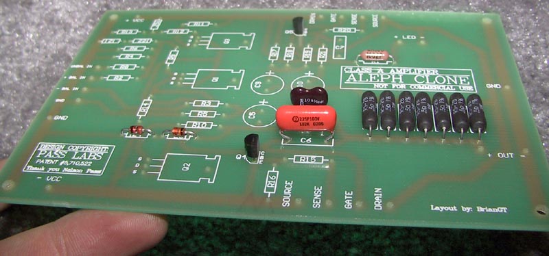

HUM GONE
MUSIC GREAT
ME HAPPY
I USED THICKER WIRE FROM THE INPUT GROUND TO EARTH AND ALSO A CONNECTION TO THE PCB GROUND.

Quote "............ AND ALSO A CONNECTION TO THE PCB GROUND"
Scott,
Are you saying that you did not have the ground wires to the main pcb all this time? Or you're saying you're using thicker ground wires to the main pcb?
I do remember there wasn't a ground "plate" for the Aleph 2 main board and thus requires two (input & output?) ground wires to the board ... or something like that.
Here's a pic of the board.
Scott - Did you have GND wires from each of the two GND vias tied to your star ground? It sounds as if you ran your input grounds only to your star ground and not also to the board. It shouldn't have mattered unless the GND wire on the input side didn't have a good connection or your star ground was floating... Is this correct? Lastly, was your star ground also earth (chassis) grounded?
I'm unclear on exactly what you changed????
Thanks,
Steve
Hmmm...... there seem to be two ground traces on the PCB with pads that would connect standoffs and/or mounting screws to the chassis ground. These grounds would only be tied together by
the mounting hardware unless delibrately and correctly wired together . Ground loops? Yes I think we can say that is a very real possibility......... Brian you want to help us out on the correct ground connections?

here's the current, and very quiet setup: (i don't know if it's correct, but if it's quiet it's good, no??)
- both ground busses on the main pcb are ganged and connected to the star, along with the cap ground, center taps.
- the negative, or ground on the amp input is tied to the board ground AND to the mains earth ground with a heavy cable.
this is for one channel, the other channel is wired the same.
and it is crystal clear. with only a slight hum with my ear to my test speaker.
hope that helps clear it up.
brian, i'll get some pix over to passlabs diy this weekend.
not really sure why it's working well. i do think that the thick ground going to my mains earth is helping rout any crap out, back into the plug ground.

ground scheme as it sits now is a littel diff than you posted:
-the input ground, at the unbalanced input rca connector, goes to the pcb AND to my earth/chassis ground (my ntc and ac ground is there as well).
-the input ground is attached to the pcb grounds in a sort of three-way, then a lead connects these to the star ground that is floating, along with the filter cap grounds and the center taps.
to be honest, i'm not completely sure why it worked the way it did, but unless there are any serious concerns, i'll let it be.

Scott -
As I read your description, your PCB and star ground are being tied to the earth ground via your input ground wire following back through the main GND trace on that side of the board then down to the star ground... Is this correct?
On the board itself, the input ground is tied to the main GND trace on that side of the board...
Why not just tie your star ground and your earth grounds together? I think your floating star ground was your problem. Have you tried this?

I believe we are having some confusion as to what certain terms mean. Earth ground is what would come from the wall outlet. Chassis (your case) should be connected to this Earth ground. This is where the thermistor comes in. The thermistor would be connected from Earth/Chassis (same point) to star ground.
It seems to me that you could move the connection that is between input ground and Chassis, If we are calling them the same. Install it between your star connection and the thermistor. Of course you would still have your input ground going to the PCB ground and then your PCB ground would be going to the star connection and star connection going to the thermistor.
How does that sound, maybe we are saying the same thing. Hope this helps.

I was under the assumption from looking at the schematic and other designs that everything on the pcb would be tied to the star ground. The reason that there are two seperate grounds on the board, is that I simply did not route the two ground traces together. With all of the grounds from the pcb going to the star ground, then the earth ground from the wall outlet goes through a the thermistor, TH1 and then into the star ground. I assumed that nothing was tied directly to the earth ground. This would mean the the chassis itself is tied to the star ground.
