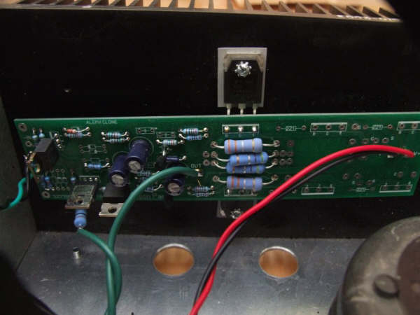

look at picture ;
gimme voltage across that resistor ;
one probe where one arrow is , other probe where other arrow is
I'm not interested in any voltage against the ground ( ie - where one probe is on ground )
in fact - you can measure voltage between speaker terminals ........ just to be sure that at least that is OK ;)

OK
That was the resistor I was measuring - sorry about the errors on my part.
On one channel is 0.439 Vdc drop and the other it is 0.423Vdc Across that resistor with the arrows.
Between the speaker terminals it's 38.2milliVoltsdc on the 0.439dc channel and 32.9mvdc onthe 0.423vdc channel
Thanks for your patience!

OK
+/-17V5
Iq 1,33A
13W/8E
14W/4E
7W/2E
dissipation 47W/channel
first - you need more power or just more quality ?
in case that you need more power , we must investigate can your heatsinks endure more dissipation ; for that we need more pics and dimensions of your heatsinks
if you need just more quality - than it's easier ...... more caps , bigger xformer ( same voltage , more VA)
