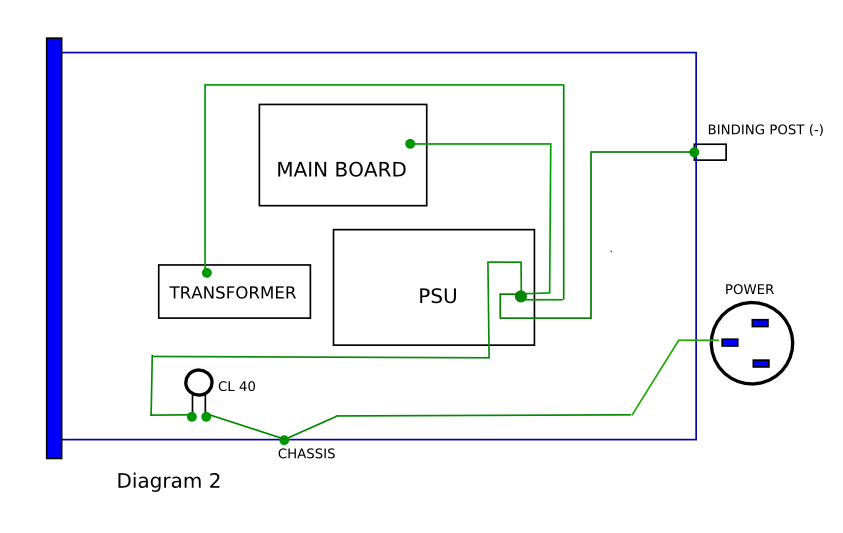

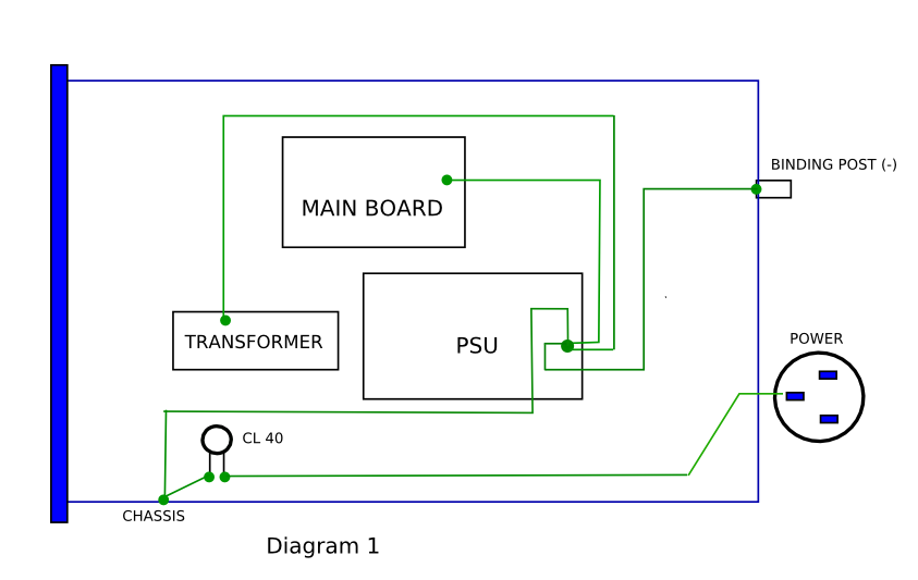

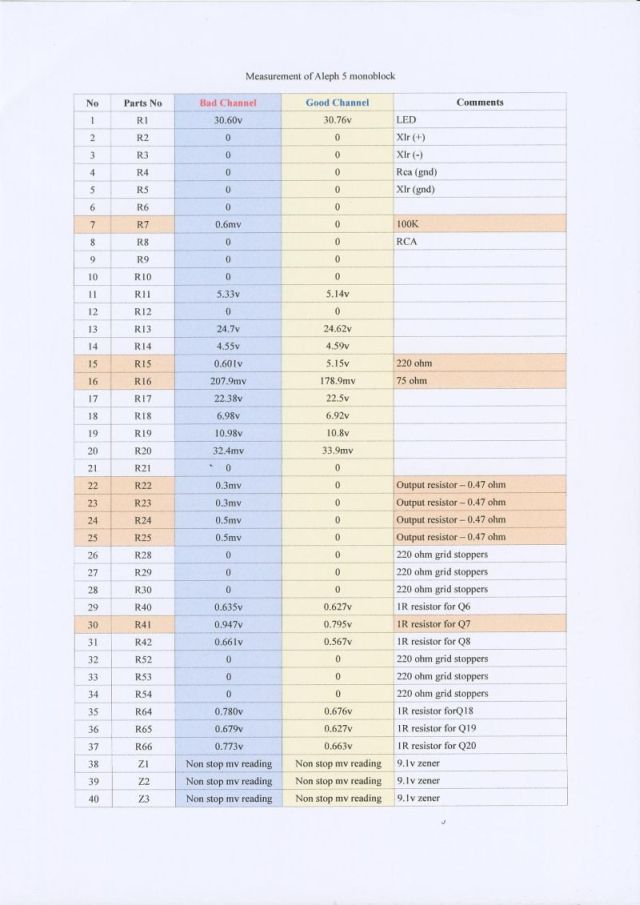

Thanks William, now I am happy that at least 1 channel is working. I have changed the layout of the gnd connection for the other channel (the one which sounds bad) but the problem is still there. The sound is just not clear, like static. I measured the output, 2.4mv. I have even changed the bad fet (0.901v) with one that matched to 0.01 but when I made the measurement, it reads 0.881v. The rest are as follow :
Z5 = 9.30v
Q5 from c to e = 4.68v
R14 = 4.65v
R11=5.32v
R40 = 0.636v
R41=0.881v
R42=0.661v
R64=0.722v
R65=0.635v
R66=0.716v
I am very happy about the output though, the speaker cone doesn't move at all when i switch on or off the amp. i can only hear a 'tick' sound. But when I play music, there's lot of static noise.
I am going to changed the other channel's gnd layout to see if I am able to achieve the same result.

Can you clarify that one channel is now working correctly, your post was a little confusing to me.
Your bias voltage of .88V is still way off of target, did you happen to check that source resistor while you were replacing the fet, seems like the R value must be higher than 1 ohm.

That's very good, your bias is probably fine, 1.1 ohms will read a higher V than .95.
Now that you have a good channel to refer to you can start trouble shooting by comparing voltage readings on the two channels. Do it without speakers for safety. When you find a reading that doesn't match you can start looking for the reason. Start at the output and work back towards the input.

With no connection on input and output turn the amp on and take all your voltage measurements over. The DC offset is the voltage present at the binding posts. Use a copy of the schematic and write down all of the voltage readings next to the component that was measured. Then do it on the good channel and compare them.
If we're lucky that should be enough to figure things out.
