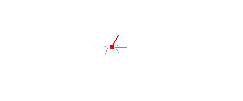

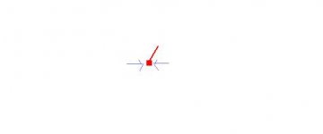

Confused.
The arrows (flow?) facing each other in different direction.
+- = 0 ?
Babowana said:
Confused.
+- = 0 ?
ZM:
just let it flow......
just let your mind flow....not arrows
erase arrows and tie ends of lines (wire?!! hehe) together
Babowana said:Hmm. . .
Upwards current thru one bolt and
downwards current thru another bolt. . .?
The two transfomers are arranged (connected)
to have opposite-direction current. . .?
Pls save me. . .
Papa is better teacher than me;
even in simple cases as this is........not to mention cases where I don't have a clue at all...........
forget two xformers-look at just one for moment,then realize what is happening,then realize that each xformer is in his own trouble
say- one rope for two necks

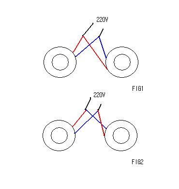

By the way,
just to kill my curiousity, I d like to give a question to Folkeb
whether transformers are connected to the 220V as shown in
FIG1 or FIG2.
Folkeb is on vacation for two weeks of Norwegian summer.
After returning back, sure he could confirm this. Hehe. . .

dunno-your line of thinking came also to my mind-does anti-phase connecting of two xformers have influence on induced current through short circuit loop ,in this case?
I presume that can be measured,but I'm not so sure that folkeb is willing to try this for us .......
Zen Mod said:... folkeb is willing to try this for us .......
Let's be patient on the tiptoe of expectation. . .
