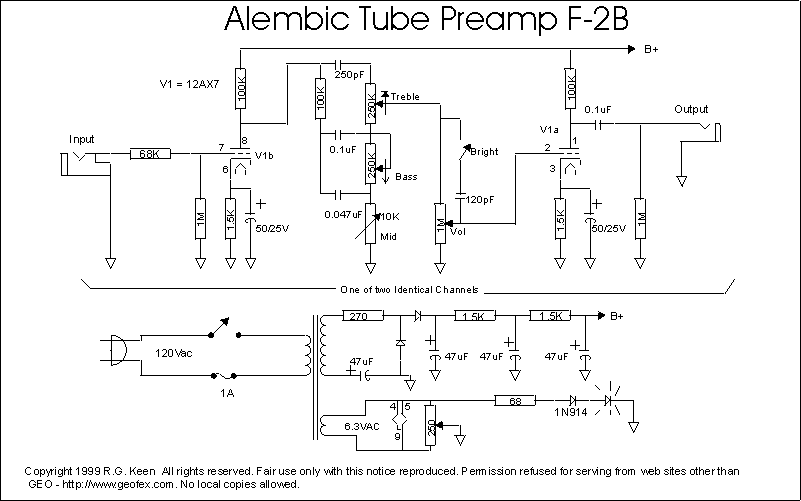

I'm new to tube projects,but i recently
found schematic of this bass preamp
and i want to build it for myself.
Like i said,i don't have experience with
tubes so i will be grateful if someone could help
me with this project. I found only this scheme
so i don't know some details...
in power supply i don't see gratz,just one diode.
is it ok to have only half-wave rectifier?
which power of transformer and voltage on secondary do i need?
thx!
here is the scheme:

Definitely a half wave voltage doubler, and I concur that the transformer secondary ought to be in the 100V - 120V range.
The pins on the first section of the 12AX7 are reversed, plate =6, grid=7, cathode=8 on a 12AX7A.
It is important to keep that power transformer away from the 12AX7.
Build the thing in a nice metal box, preferably aluminum as it is much easier to work than steel, and using a socket with shield for the 12AX7.
For this application I would recommend the Sovtek 12AX7LPS, it's quiet and the spiral filament construction cancels the hum inducing ac magnetic field around the filament.
