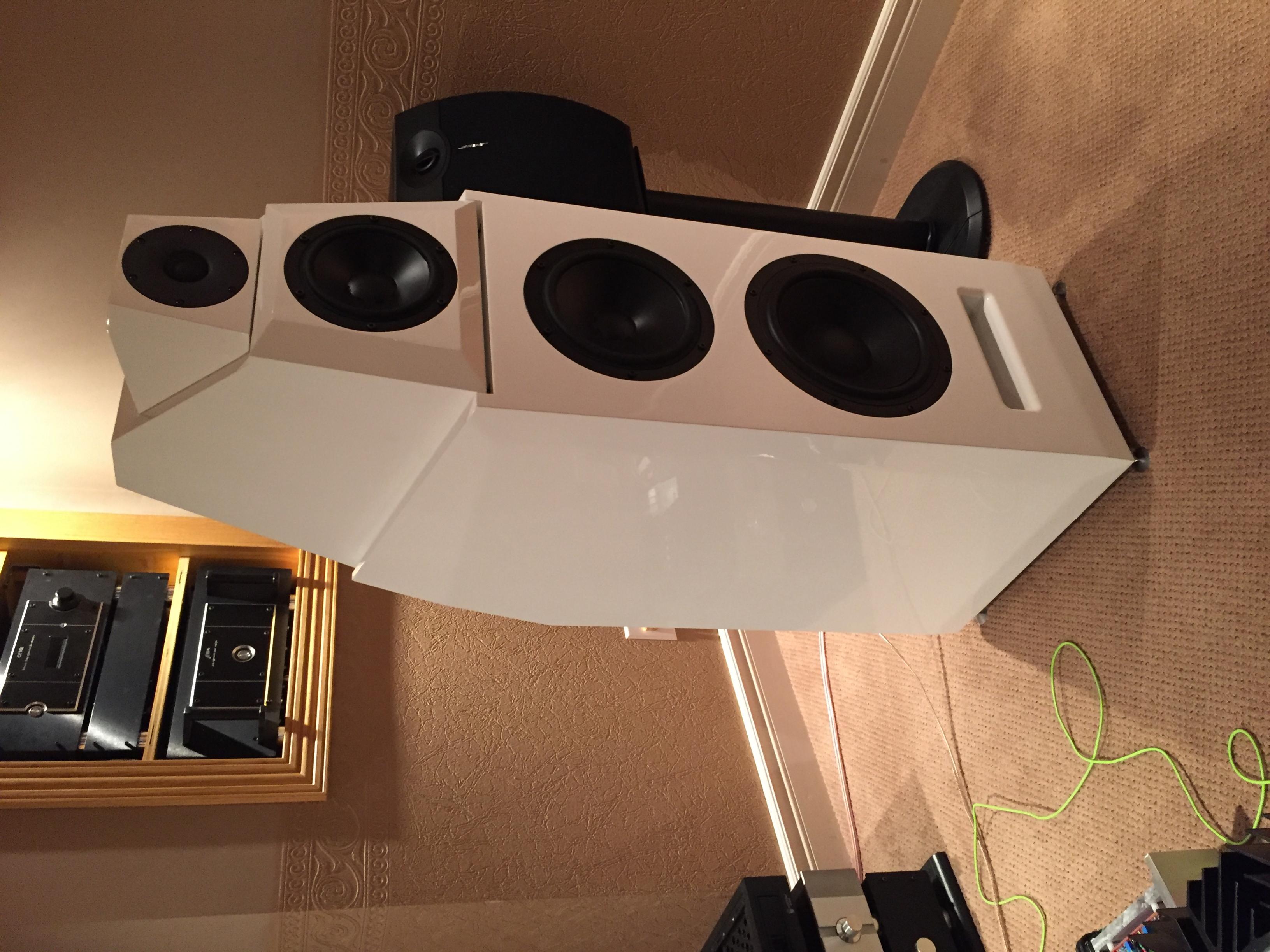

ATS-4 measurement:
Very impressive speaker you have there!
Zman has a point, if you make the Alpha 20, it is a relatively simple thing to install it in a swap with another 24v rail Class A. Especially if you already have a UMS heatsink case. You will be able to compare sound quality to other 20w-25w Class A amps you have like your favored USSA5? If on the other hand you go for BB, it is different enough that just the PSU and the cooling system will be different enough that you have to spend more time on them before getting sound. The ATS-4 probably is about 87.5dB sensitive, which is darn good for a big 4-way. It will be quite happy with the Alpha 20. But if you wanted massive sound, the 52w BB will be more suited. Pure Class A at 52w for some reason sounds more like a 100w Class AB.
ATS-4 measurement:
You use the Bose to widen image Nice speakers, the white ones.
LOL! The Bose are my suicide speakers for testing and also for home theater use and I'm surprised I have not yet destroyed them with everything that hit them, they're indestructible those Bose! The white ones are the ATS-4. Thanks!
Those are great looking speakers Pinnocchio!
Thanks X!

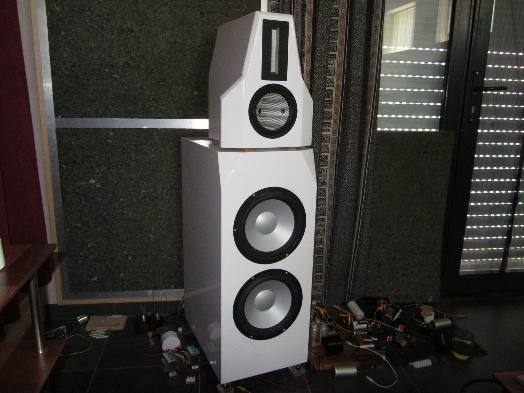

Looks great Do !Here's my version of the ATS-4
I just did the same finish on my RefSpeaker V2.

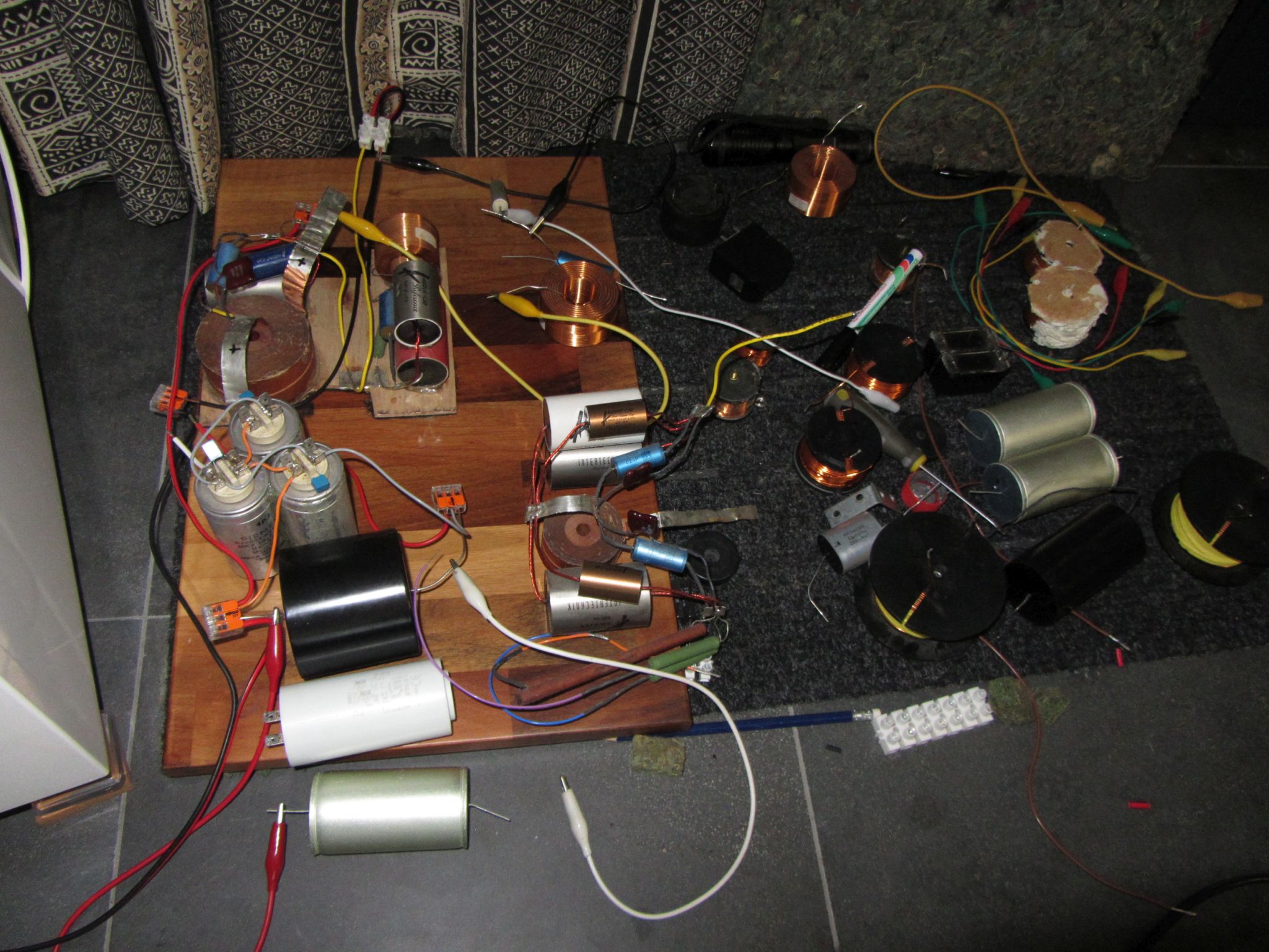

Now I'm tuning the crossover, after that: Alpha 4R
Yep, left side is for the woofer, right side mid and tweeter.
It's not so complex, it looks like it because of the spaghetti of wires and plenty of unused coils/caps for trial
Woofer: 2nd order + LCR 50Hz, Mid: 2x 2nd order, Ribbon: 3rd order
Still manageable

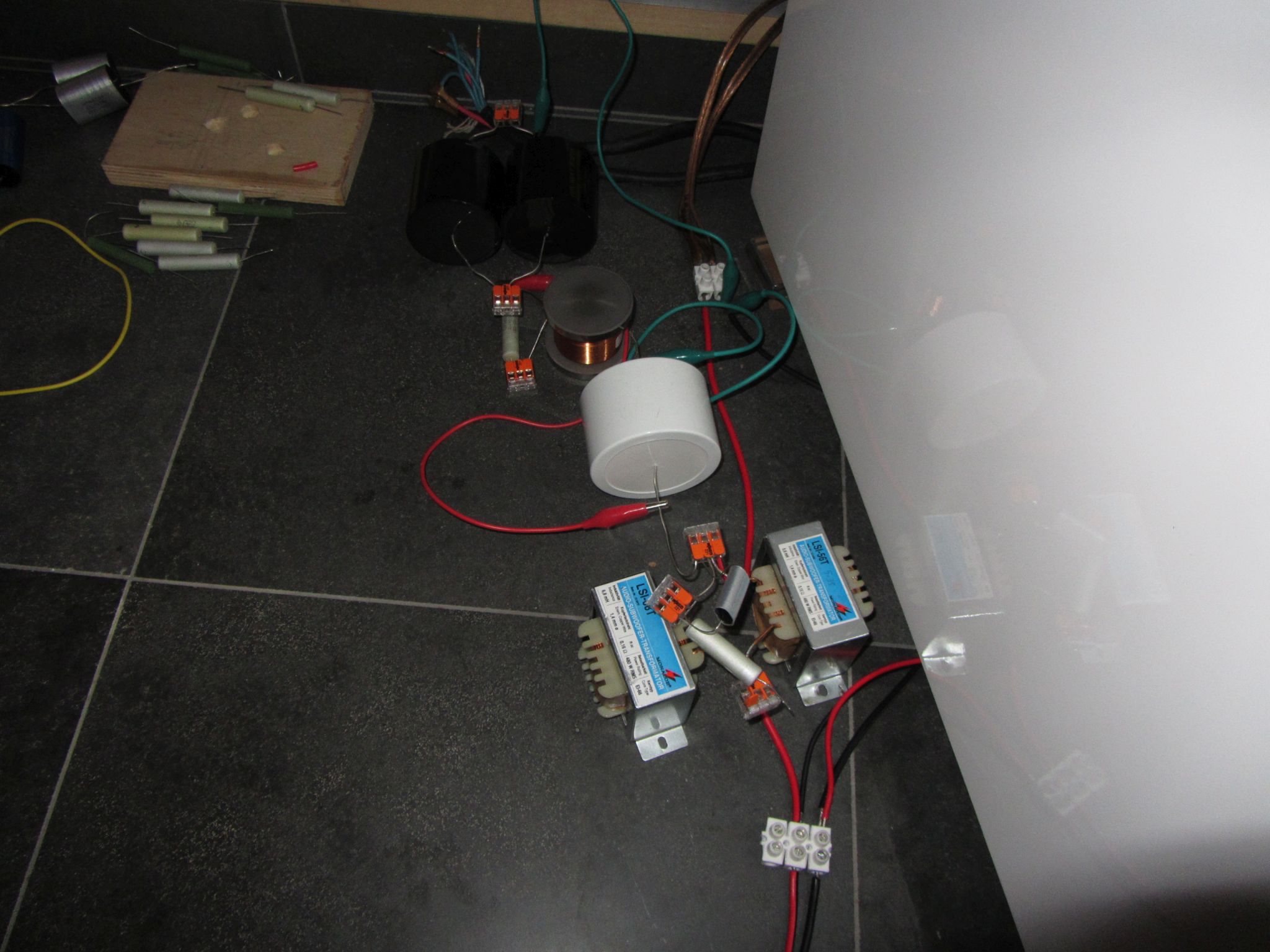

Those motor run caps are Siemens MKV and Icar ecofill
Still manageable
