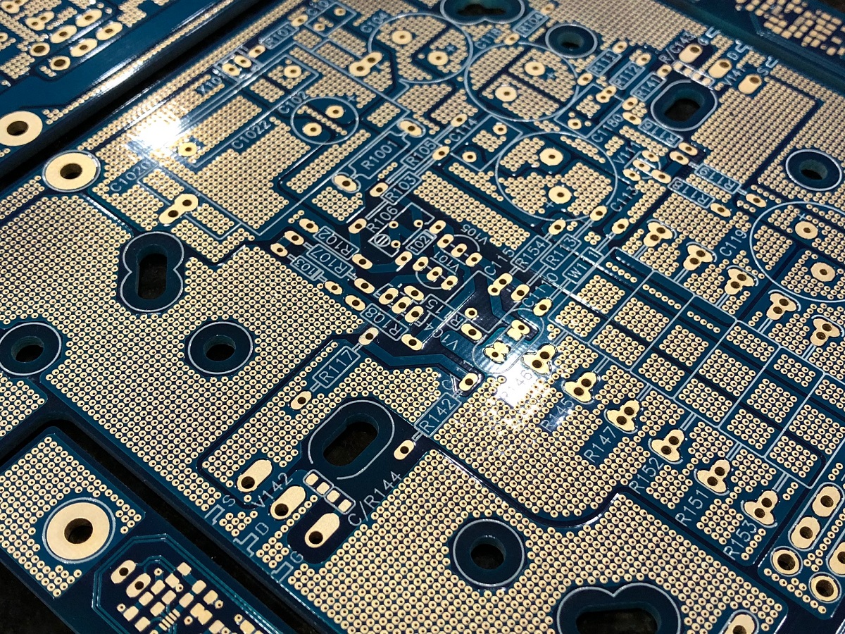

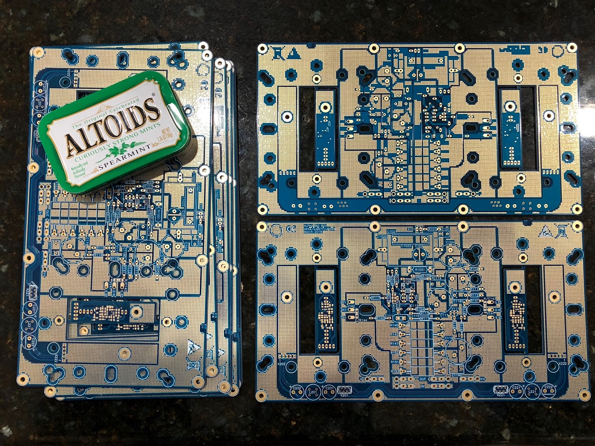

Big Boy is in the house, and boy, is he BIG!
Altoids tin for size comparison. That's a lot of vias. I also realize a side benefit of lots of vias - the copper trace cannot peel off - it is literally anchored to the other side.
Nice boards JPS64! Awesone layout! EPIC in proportions!

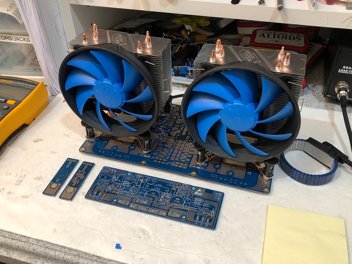

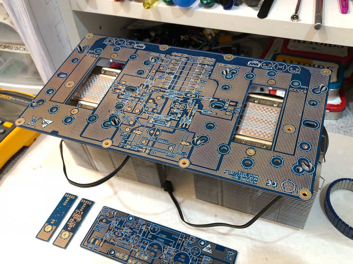

And they fit the CPU Cooler standard mounting hardware perfectly! Nice work there JPS64. :)
attachment.php
Now that's a cool looking and cool running Class A amp!
attachment.php
I would probably replace the plastic snap on clamp screw with a real metal bolt and metal wing-nut with a spring and washers.

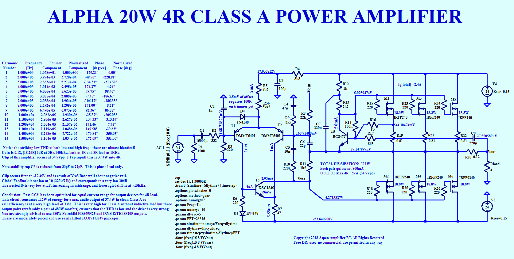

FINAL ALPHA 35W 4R VERSION
I have reworked the 4R ALPHA for 2.4A quiescent and 24V rails. Gain is reduced to Danny's preferred 18.2dB (9.12) and compensation has been amended at C6. All text and measurements on the simulation check out right and high pole is at 950KHz. I have reduced the fb shunt cap from 100uF to 47uF and it still gives superior bottom response due to the 2k7 shunt resistor.
LTSpice file and a gif of the working are attached. This 4R version mandates a pair of 480W mosfets; IRFP240/9240 are NOT recommended, even in triplets. I use the IRFPs in triples here on simulation because I do not have the larger mosfet models; three pairs is close to a pair of large 480W devices.
Hugh

AMENDED LEGEND FOR 4R ALPHA
I have amended the figures to reflect 12.5W into 4R load (1.7Vpk input and 20Vpk output) and give more insight to the profile of the harmonics.
As mentioned, with loading this amplifier tends to make more H3, but even at 12.5W H3 is -88dB lower than H2 -80dB and a very good H5 output of -111dB. I believe the 8R version will sound better but this low loading for ribbon speakers should sound very good too.
I am very pleased that XRK's measurements on the proto indicates that THD/harmonics in realitiy seem to be less than these simulated figures, which is an excellent indication!

Big pcb's! Feedback now is from speakeroutput I see, like the blue schematics. Unlike earlier pcb and its white pcb schematic that has feedback connected between "big" source resistors. Is that just a difference for damping/outputimpedance ?
I think the “white” schematic is based on this schematic and the feedback topology should be the same - although Hugh will need to confirm. The schematic with the three output pairs is for the B.B. and so these recent discussions of 4ohm output impedance appears to have been run on the model for the B.B. but derated to 12W and 4ohms?
Here is original blue schematic of 20w Alpha:
659376d1517198709-aksa-lender-mos-hybrid-aleph-alpha-amplifier-alpha-20w-pchan-schematic-png
Vs. the 4ohm Alpha:
669823d1521533665-aksa-lender-mos-hybrid-aleph-alpha-amplifier-alpha4r-gif
The feedback topology does look slightly different (on different sides of the Aleph sense resistor).
