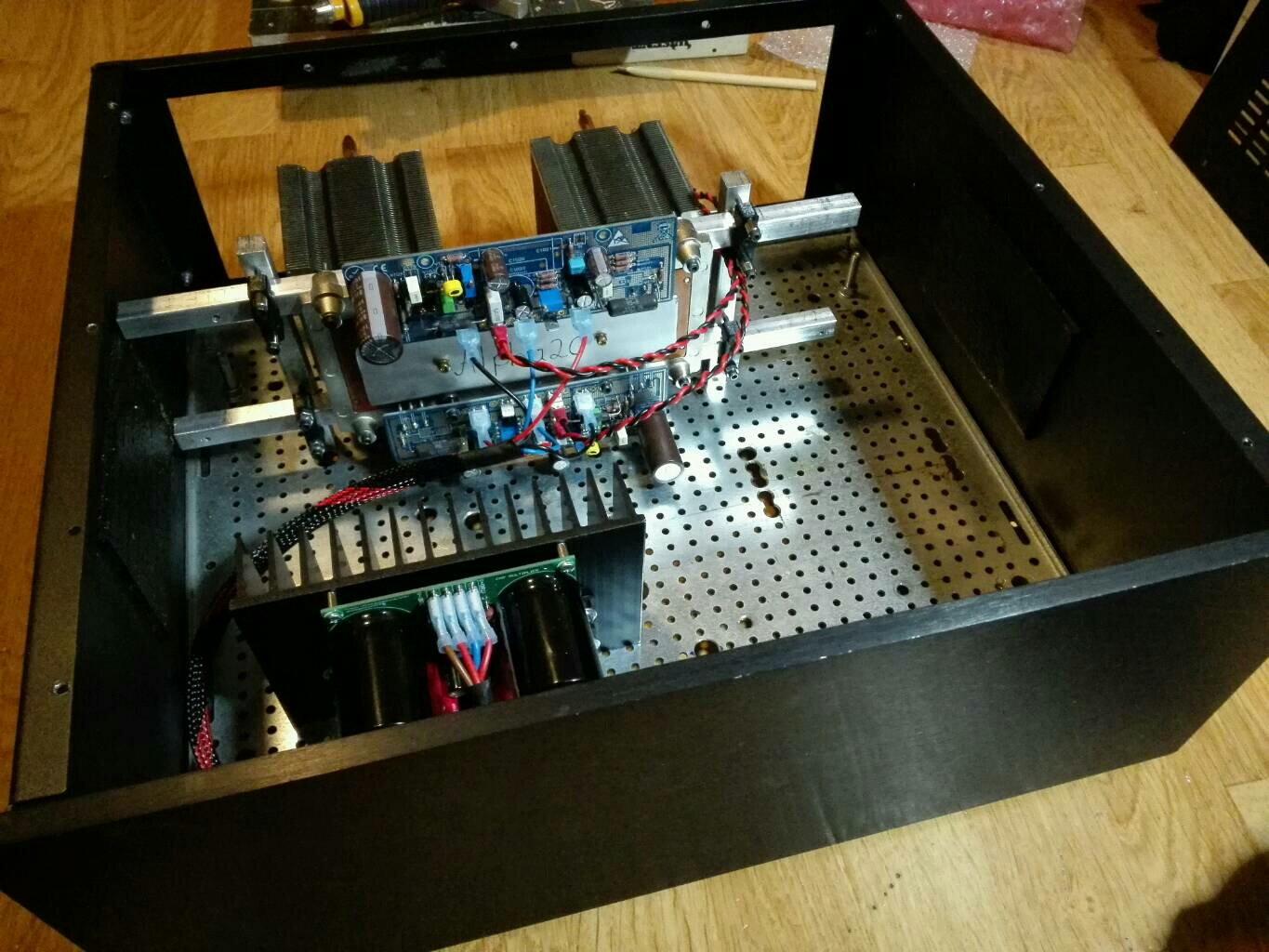

Some work done today, I just use whatever I have in my hands at this point, since I'm not sure that my creation even work after all :D
Have to redo about everything if it works as it supposed to.

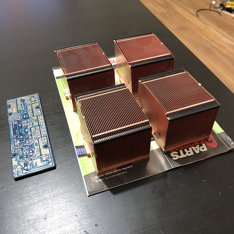

Beautiful sinks Aatto!
Aatto,
Those are nice - looks like CPU heat-sinks from servers?
Thanks :D yeah old school server heat sinks for xeon cpus.
technically it should be able to support xeon 7150N with 150w TDP, of course accompanied by noisy server fans.
Nice find though. Copper is almost impossible for amateurs to drill and tap so be careful.
yeah, i hate it, i did some copper cnc milling in the past and it is not fun, if it didn't work out i will use thermal adhesive as last resort.
but I know those servers are noisy. They sound like a jet airplane on a runway.
it certainly does, our blade server has 10 exhaust fans, each one rated at 16A ! (12v)
Tracked it down to a HP server for socket 604 Xeon:
that was fast !
