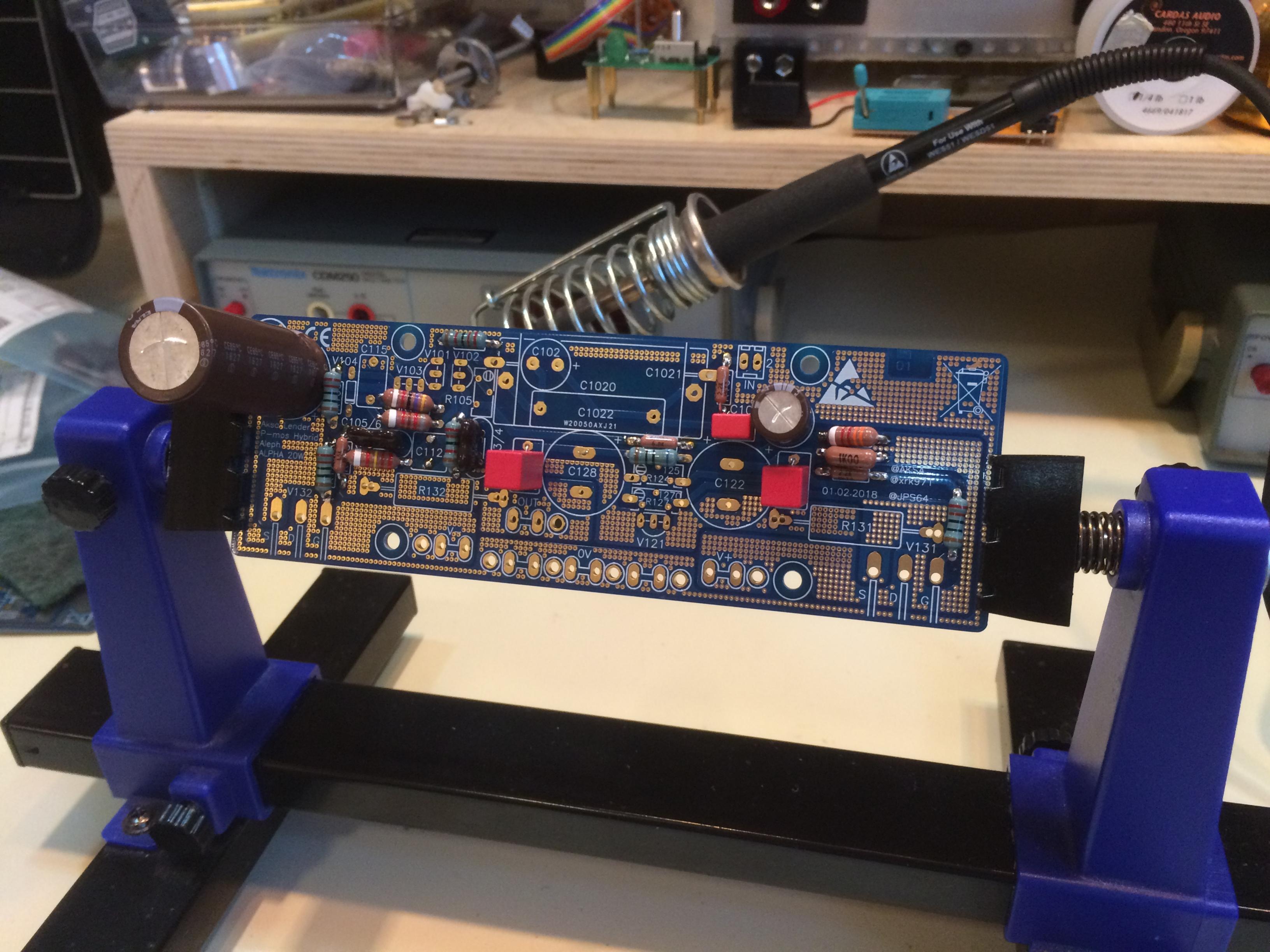

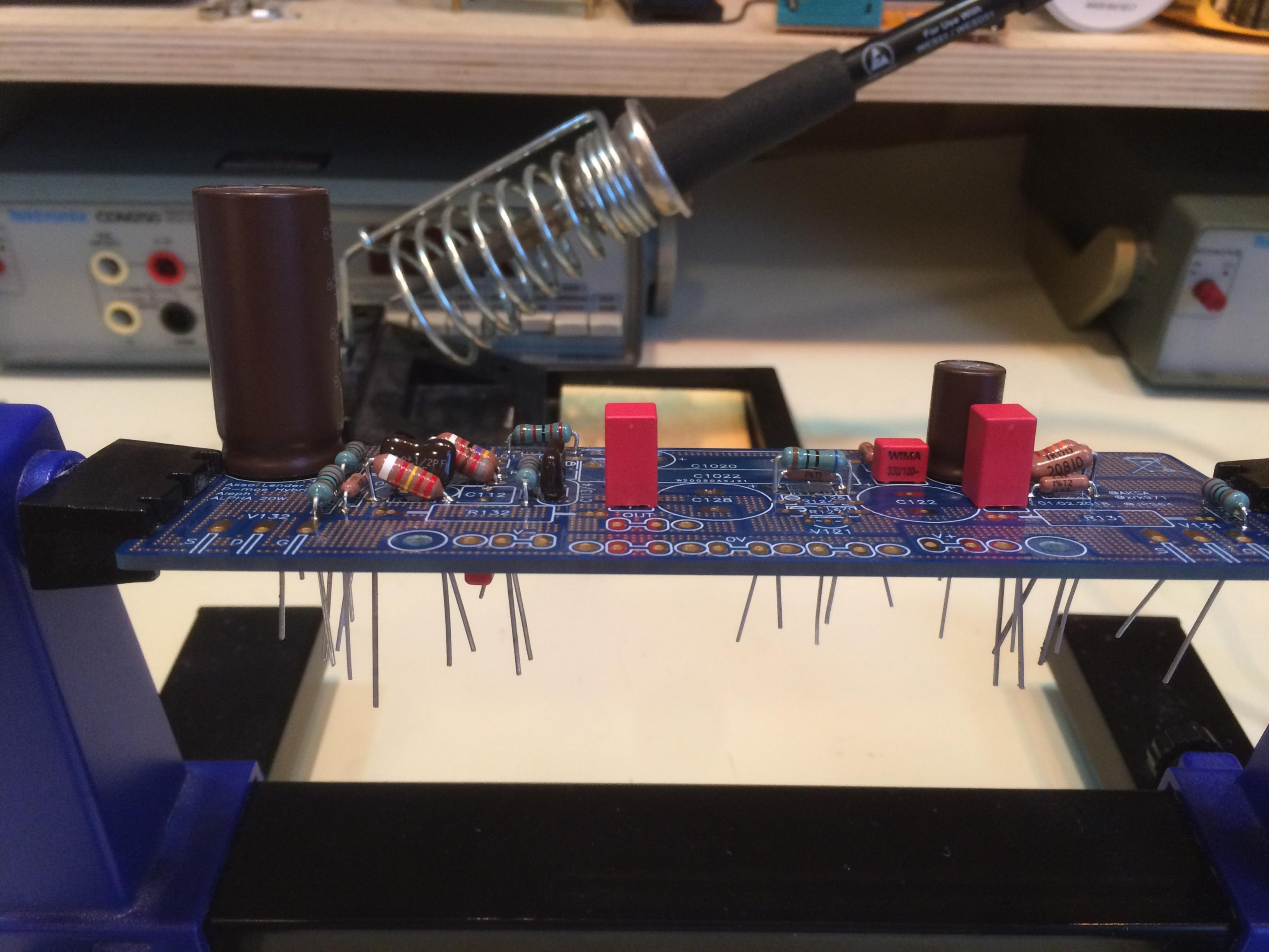

Was able to get a good bit of the first board stuffed and soldered during my lunch break.
I had to place one of the mks caps on the bottom as what I had on hand was a bit big. The 1uf wima's I had on hand are a touch big as well, but I think I can get them on with no fuss.
Resistors are Takman REY, Dale CMF, and some Vishay 2% RL(cmf). I may have to parallel a few resistors for the 0.22, and 0.12 positions to get it up and tested. I forgot to order the mills for those spots.

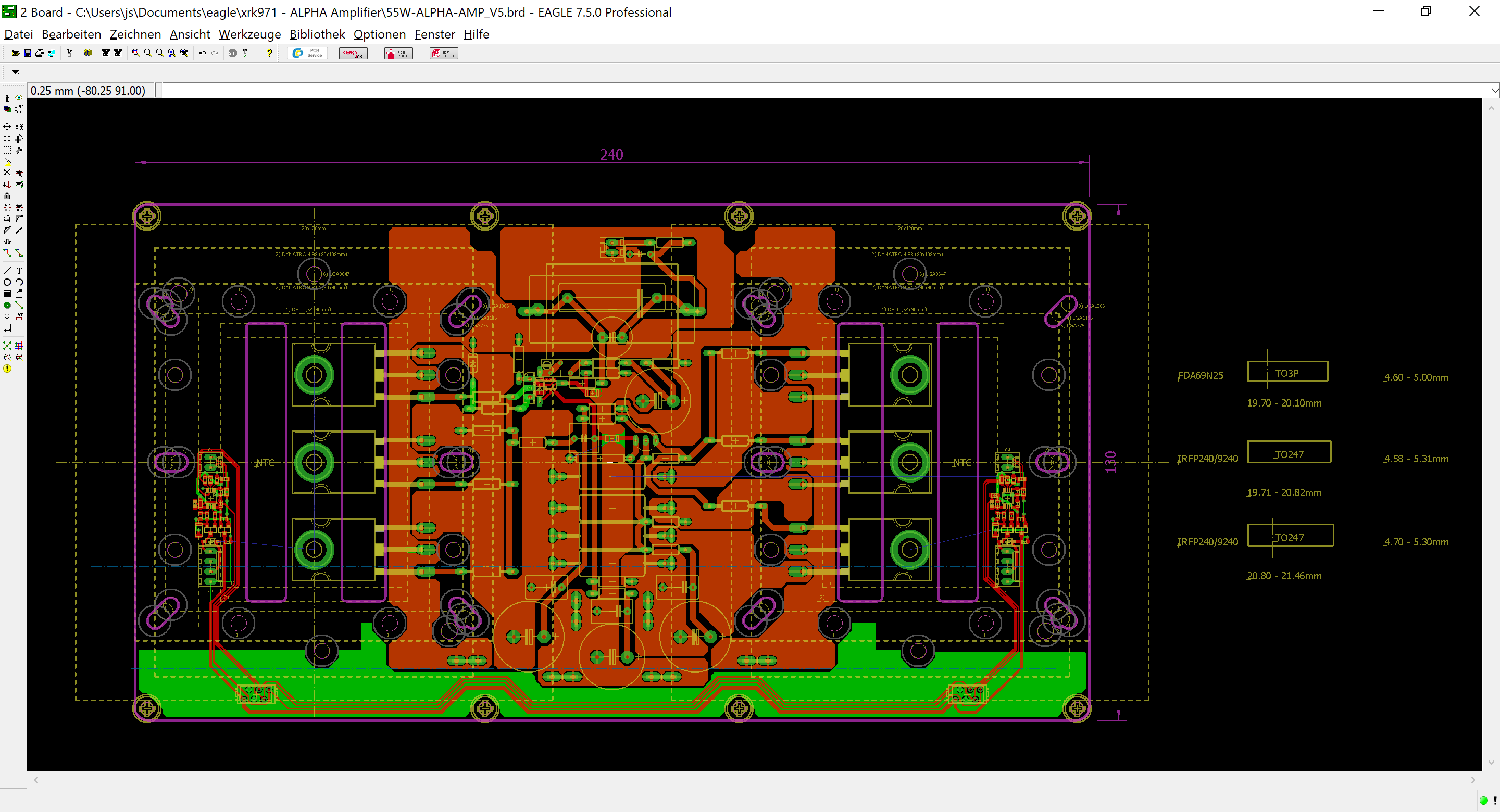

Yes, +1 to JPS64 for a superb design on the layout. The 52W Alpha also looks to be stunner, and looks unlike any other Class A amp I have seen on DIYA or otherwise. Nice job JPS64.
I assume the Alpha 52 will also have numerous vias and of course, we will make it in 2mm thcik FRP and double thick copper with ENIG finish.
