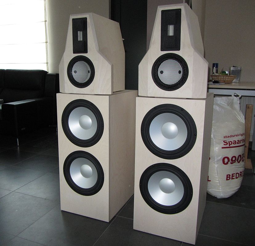

Any more progress on your beautiful Alpha? Will these drive your Accuton based Myref speakers?

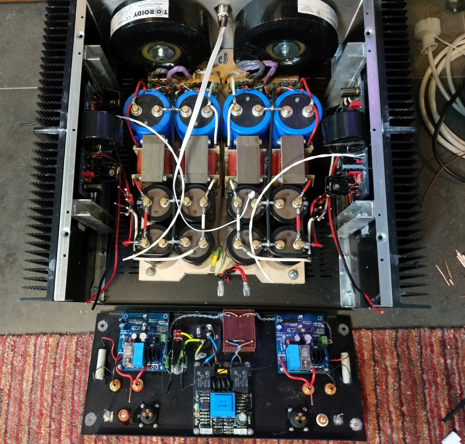

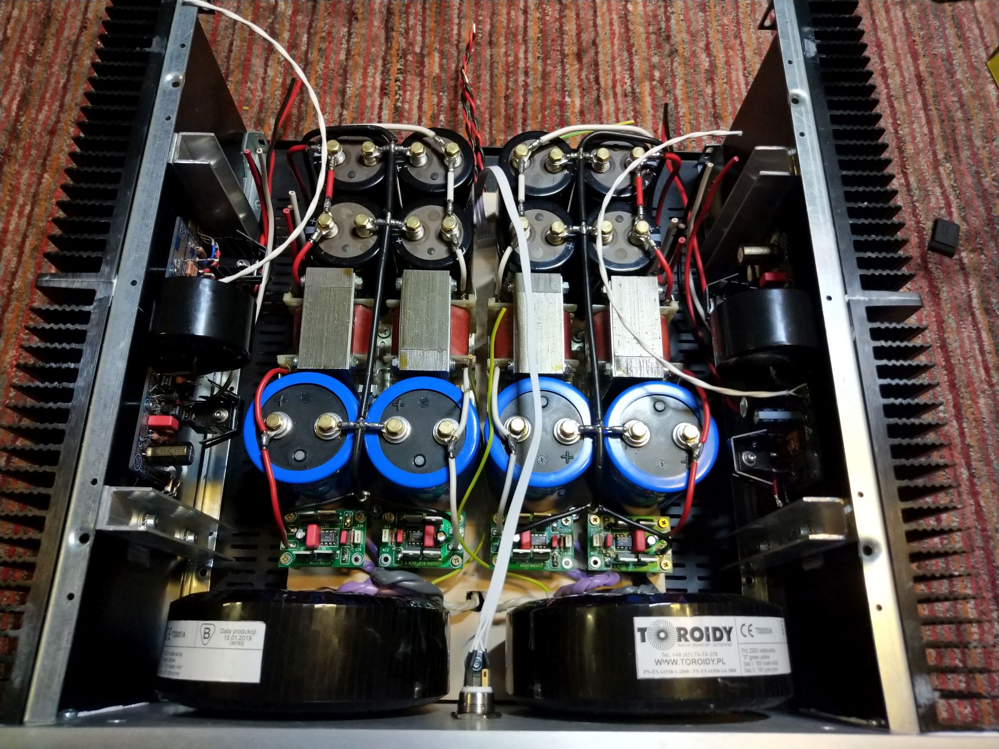

First test on right channel, succeeded !!!
Still no smoke after 5 minutes, let's keep it like this
Next step is the left channel: I still need to connect the left PS to the left PCB when the PS caps are empty,
it takes 30 minutes through the bleeder resistor/led.

Thanks for the compliments !
It is still feasible to lift this amplifier, another story is my RefSpeaker,
especially when I was tuning the port length that is on the bottom.
The bleeder takes only 30 minutes on the left PS because nothing is yet connected to the left PS.
The right channel bleeds much faster through the Alpha PCB.

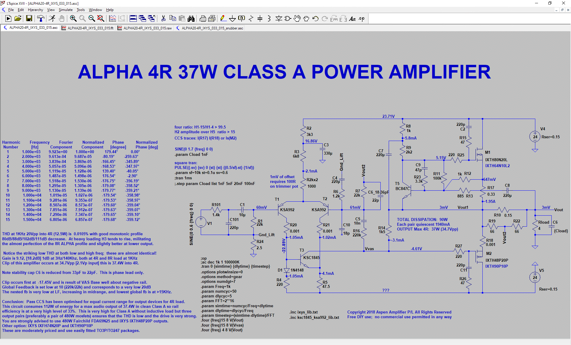

Normally the Alpha has a 820R FB shunt resistor, I've changed that to 1.8K, this gives less gain and lower THD on high 4R output.
But probably messes also with the phase and soundstage depth.
But here's the story, I don't need that high output, if I play crazy loud my 93db speakers get about 4vpp, that's plenty, 1-2Vpp is at normal listening levels.
So for 4R stability I can get away with a smaller FB resistor, let's say 1.2K

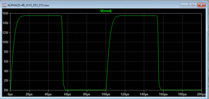

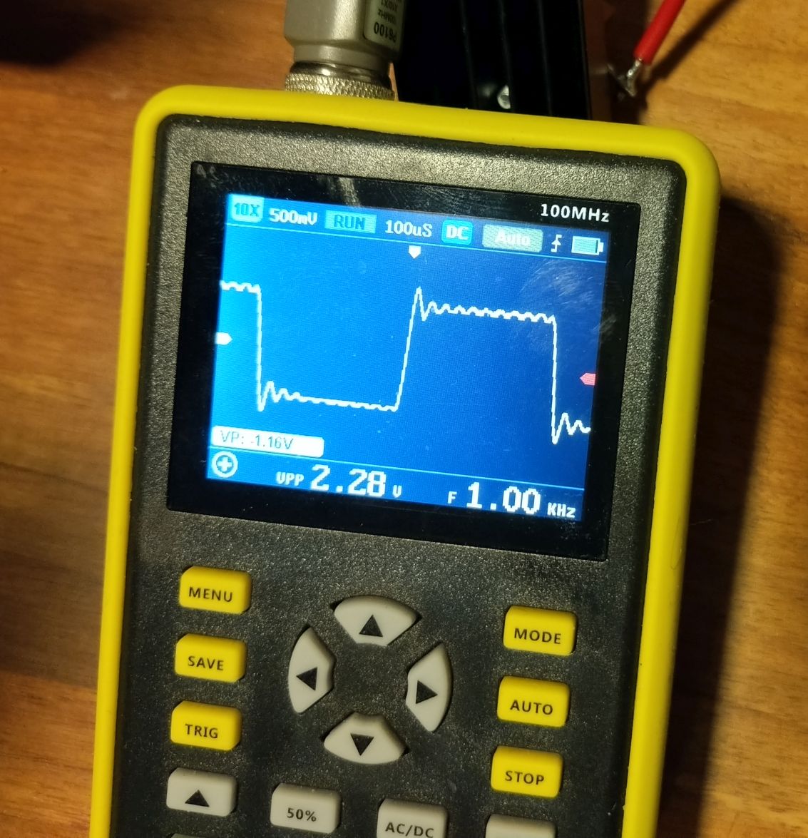

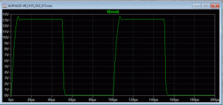

Something else that I noticed with that higher 1.8k FB is that the 1kHz square wave has some oscillation (picture 1)
When I simulated this in LTspice with 1.8k FB I also get the oscillation (picture 2),

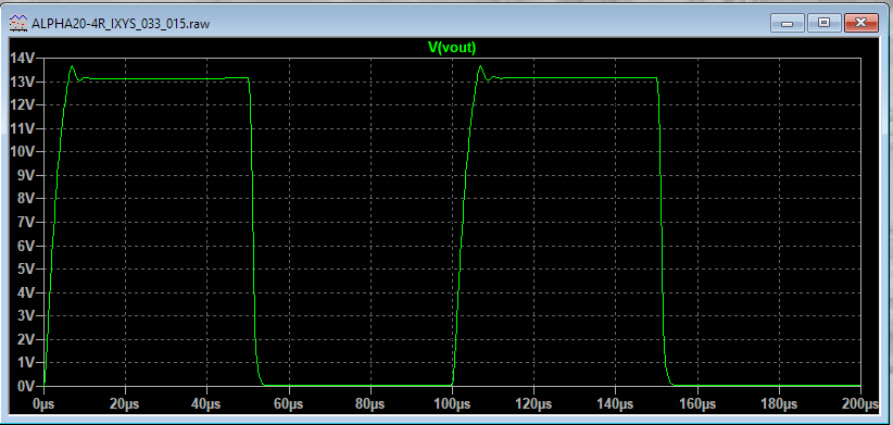

but with 1.2k FB that oscillation is gone (picture 3).

Change the FB shunt resistor to 1.2K, THD still looks great in LTspice at 20vpp for 4R load.

I suspect that the heavy ringing on square wave is lack of fb network control, and low current at the collector of the VAS driving the pmos gate. You could improve the ring damping by halving the fb resistors; so change R7 and R2 to 10k, then R6 to 820R, and finally R16 to 100k. That should restore the depth of image, a very subtle quality and worth having in any amplifier.
If you examine the Nirvana you will see that I set the VAS collector much higher at around 7mA, and this gives more control over the gate nmos (the output stage is reversed there).
I looked at Nelson's SIT/Vfet design. Very good design, but a lot of components compared to the Nirvana, and a lot of inefficiencies in the output stage with the IRF cascodes. He says that with more components there is less chance of the amp being built; absolutely, and the reason I kept the ALPHAs at low parts count.
