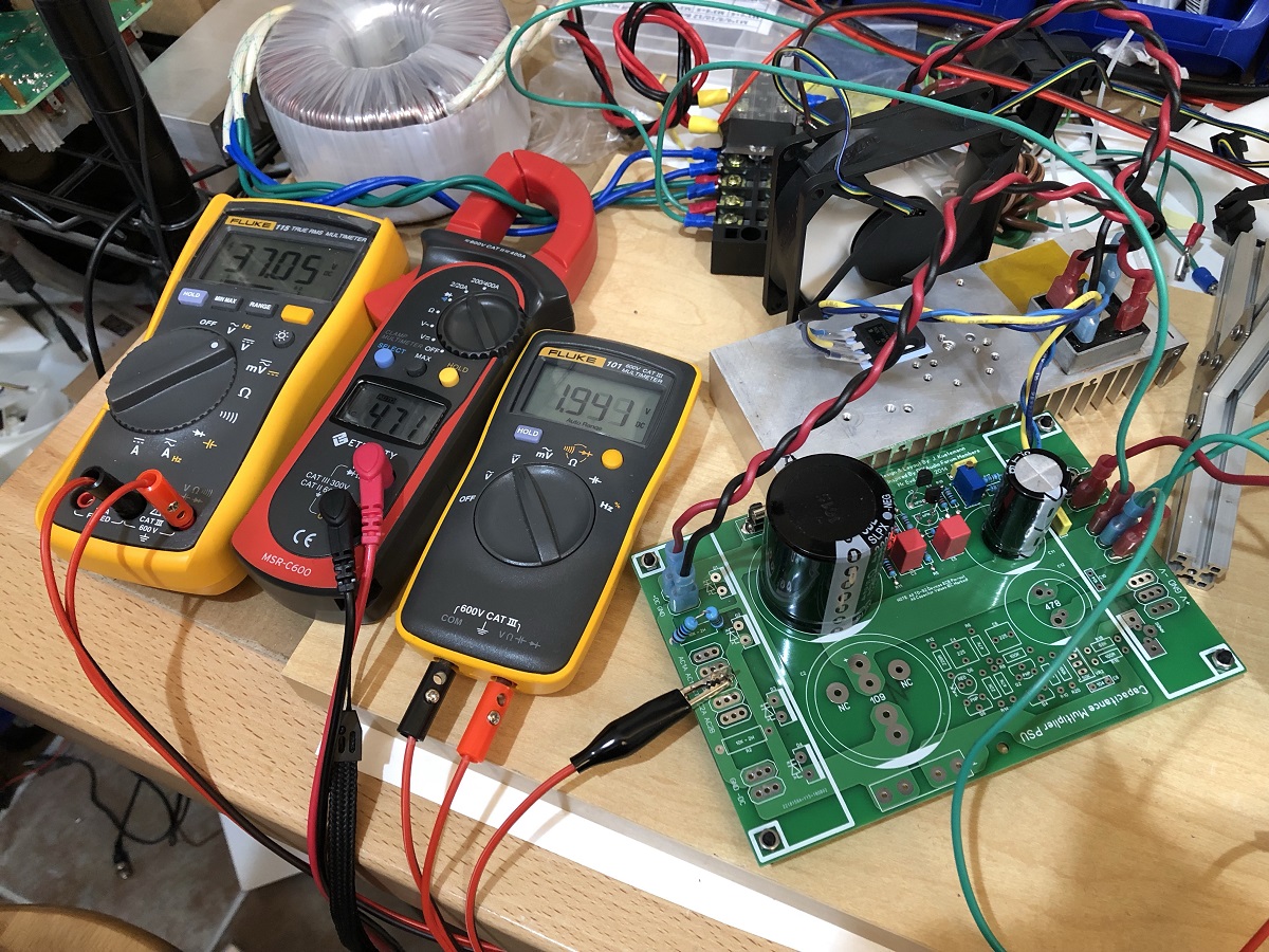

Regarding the trafo and caps you got for Krell, probably buy one more of the same trafo and use a cap multiplier and you will be good. You will need a double set of secondaries to generate the dual rails per channel. 22mF per rail per channel with cap Mx is enough but of you have 33mF, even better.
The Jason Keutermann MrEvil cap Mx has been used by Vunce, and I just built one myself - it is very good and suitable for supplying lots of amps continuously with a variable adjustable output voltage. My only changes to it are to use an external square puck bridge rectifier and external MOSFET (with flying leads) as the on board mounts do not have sufficient room for a decent heatsink. The bridge gets hot and so does the MOSFET. But you save from having to get only a pair of 22mF caps vs 8 so cost savings is substantial, and my measured ripple at 5 amps is 2mV. I don't think 8x33mF caps CRC can touch that.
Here is an example of my JK Cap Mx (only positive rail populated) undergoing testing at 4.7amps and putting out 37v for my MOAMOFO which dissipates 150w to 160w per IXYS MOSFET. You can see how I mounted the bridge and main MOSFET for the cap Mx remotely on a small heatsink. There is a fan there but I found it can work passively cooled if fins angled vertically.

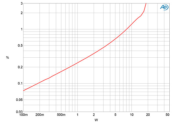

Just now I have read the review of First Watt SIT-3.
First Watt SIT-3 power amplifier Measurements | Stereophile.com
* 8 watts (8 Ohms) with THD+N 1%
* 16 watts (4 Ohms) with THD+N 1%.

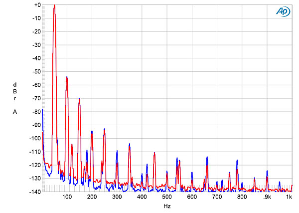

Fig.4 First Watt SIT-3, both channels driven, distortion (%) vs 1kHz continuous output power into 8 ohms.
Fig.8 First Watt SIT-3, spectrum of 50Hz sinewave, DC–1kHz, at 1Wpc into 8 ohms (linear frequency scale).

Nice results for the SIT3 from NP, and very good figures from XRK971 on the ALPHA 20. At the risk of boring you with information you know well, let me offer my thoughts!
Both are Class A, but the SIT uses a SOTA silicon carbide transistor which is unique, expensive, and difficult to source. The circuit is classic minimalism from NP, a very well designed amplifier of very different topology to the ALPHA.
I note that the H2 on the SIT3 appears at -55dB. This is about 12dB lower than a single ended triode amplifier, which many people really like for the rich, lush sound. The SIT3 would have a marvellous warm, rich sound and with the right speaker would sound wonderful. The harmonic profile is linear decreasing.
The ALPHA is a very difficult beast. Again, it uses a NP innovation, the active current source, but the output devices are complementary mosfets, cheap as chips, but running at high dissipation (40W each). The H2 is far less, -85dB, so it would sound neutral, not rich/warm like the SIT3. Those who like to hear no distortion, no addition to the sound, absolutely clean and quiet, would like the ALPHA, and those who like the tubey, warm sounds of H2 would love the SIT3.
Audio is as much entertainment as it is technical objectivity. You choose what you like, and make to apology to any preferences. If you do, then you might prefer to follow political correctness..... in both amplifiers, the harmonic profile is still linear decreasing, the way most Class A amps deliver so nicely.
For myself, I would like to own BOTH amplifiers, and switch from one to the other according to whimsy and my musical tastes. There can be no objectivity about the subjective.........
