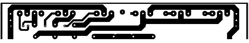

Few questions

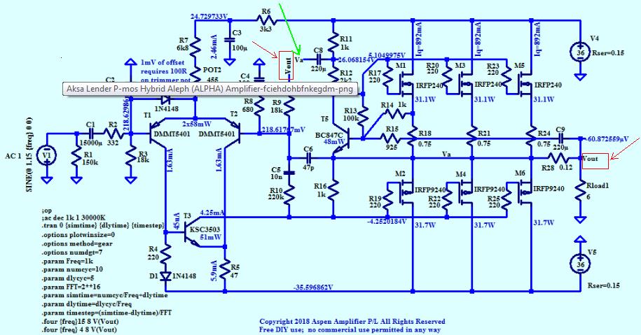

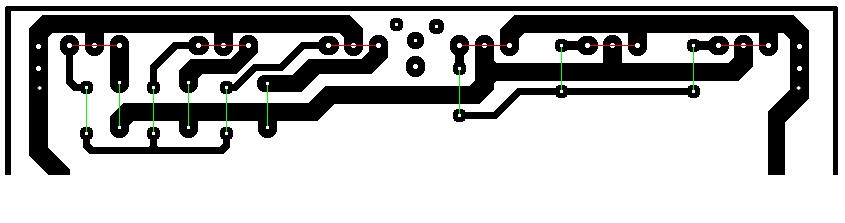

Hi X
I have couple of question to you
Please let me know if the 2 Vout is connected together?
Second question Va with the green mark were is connected?
I started to do my layout, to that I must know that answer to that two questions. I know you wrote you U will have a professional layout for the 3 pairs so for that reason I only draw these layout for myself unless you want me to post the final work. :)
I do not worried about heatsinks
I built amps like Aleph X 22V rail voltage 7A total bias per channel. So no worries about the heatsink. :D

Hi X
Va is connected to the Va node after the CCS source resistors (on the other side of of R28. Vout is connected to the output before the load.
Make sure you are you using schematic from Post 155 (latest):
660208d1517584966-aksa-lender-mos-hybrid-aleph-alpha-amplifier-fciehdohbfnkegdm-png
Also know that the Big Boy version is yet untested. So you may be the test builder if you move fast. I have not had a chance to build it yet.

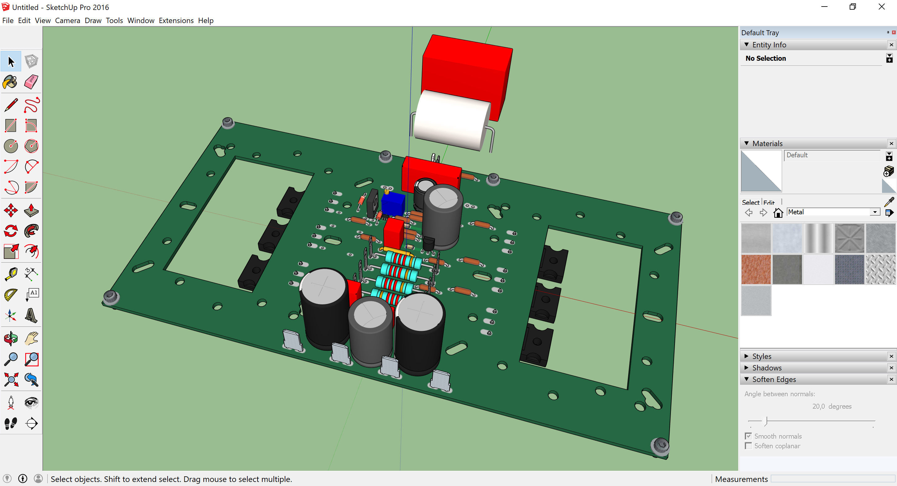

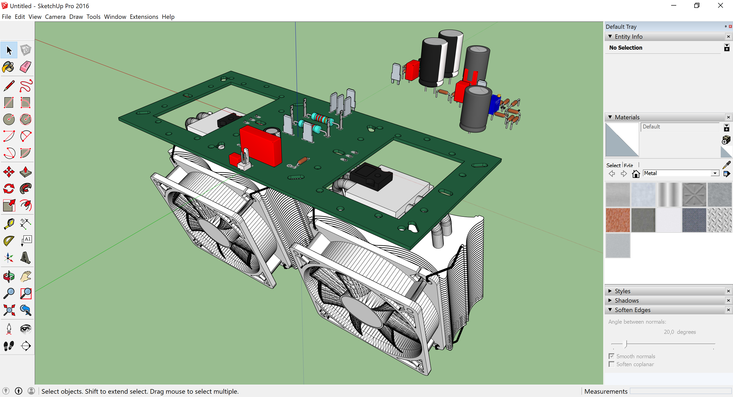

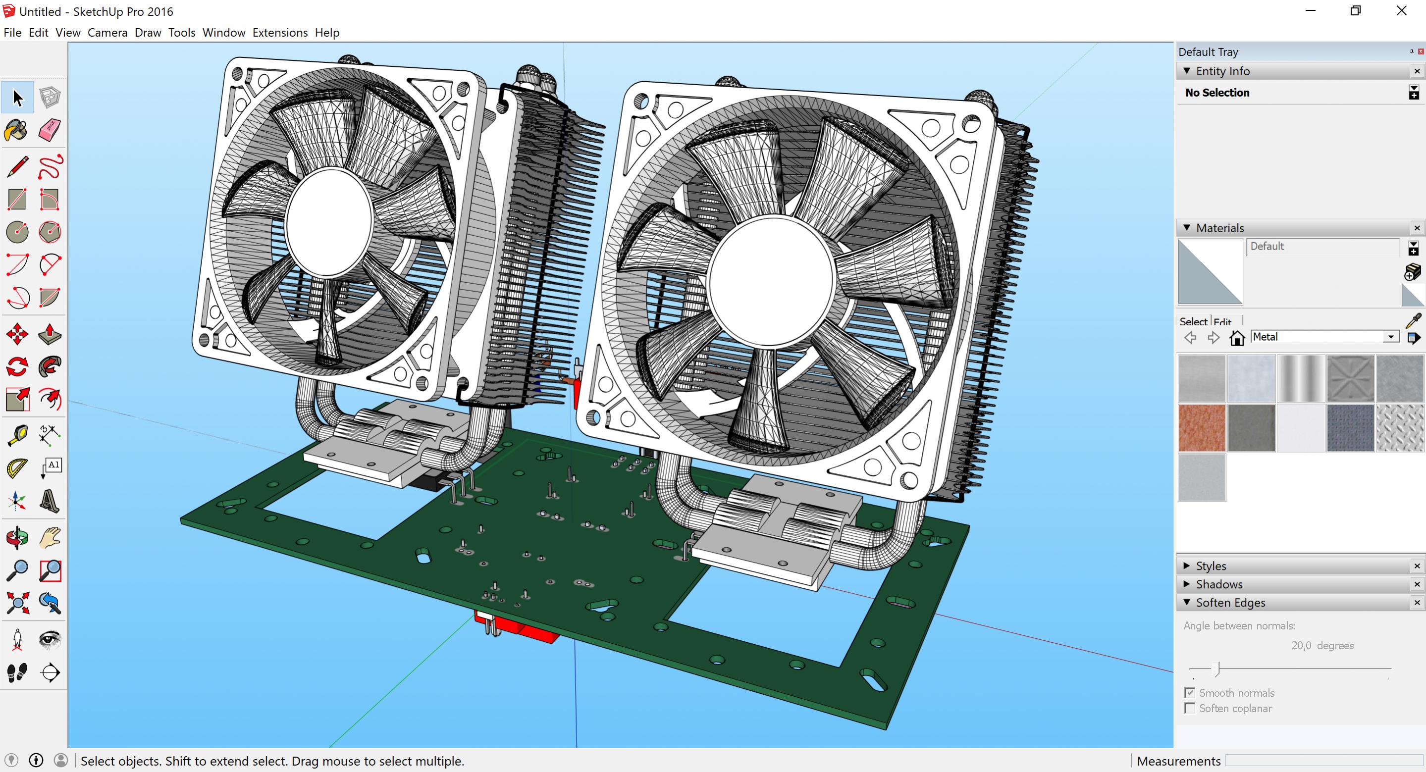

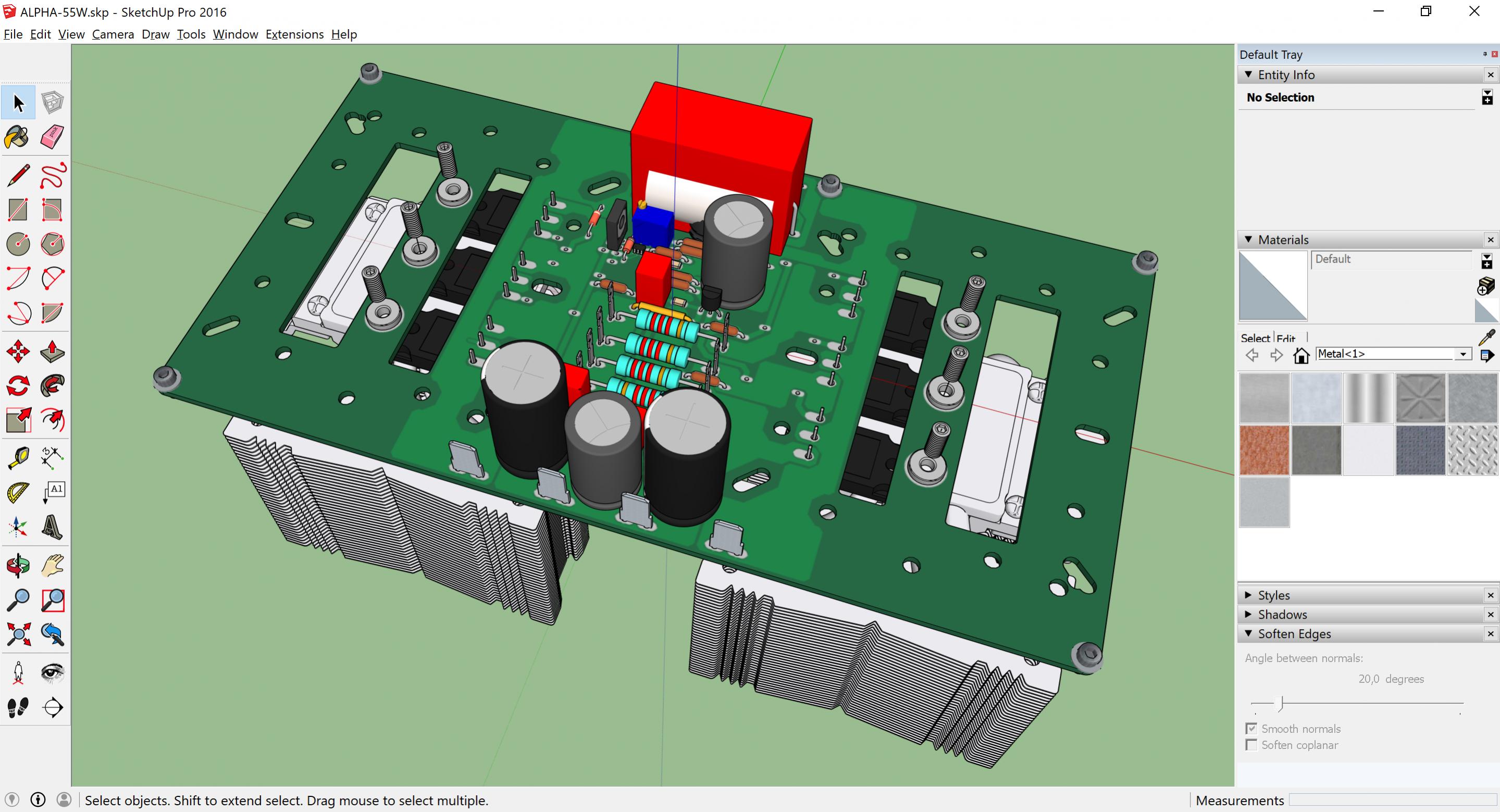

2 cylinders (LGA1366 cooler, ARCTIC Freezer 7 Pro Rev.2; board can accept many different CPU-cooler).
I´m braining about 3 Mosfets solution.
JP
That's a nice readily available cooler at a good price. Thanks, JP.
Do you know if it uses standard 12vdc fan or requires a PWM driver? Perhaps we can get a temp sensor tied to a safety shutoff relay logic signal to prevent fan failure blowouts?
How to clamp such a CPU cooler to PCB since it doesn't have a big plate? We could have a plate made out of a PCB material by the fab house too.
Amazon.com: ARCTIC Freezer 7 Pro Rev 2 - 150 Watt Multicompatible Low Noise CPU Cooler for AMD and Intel Sockets: Computers & Accessories
Edit: I see it is a PWM fan so requires a controller...

Cooler's
I noticed there were quite a few coolers listed below the Freezer 7 model, for not much more $$. There was a Artic Freezer 13 which came in 3 models that looked interesting.
I might have missed a point, "Are these coolers for the BB", or are you using on the 20W version also.

Temporary hold

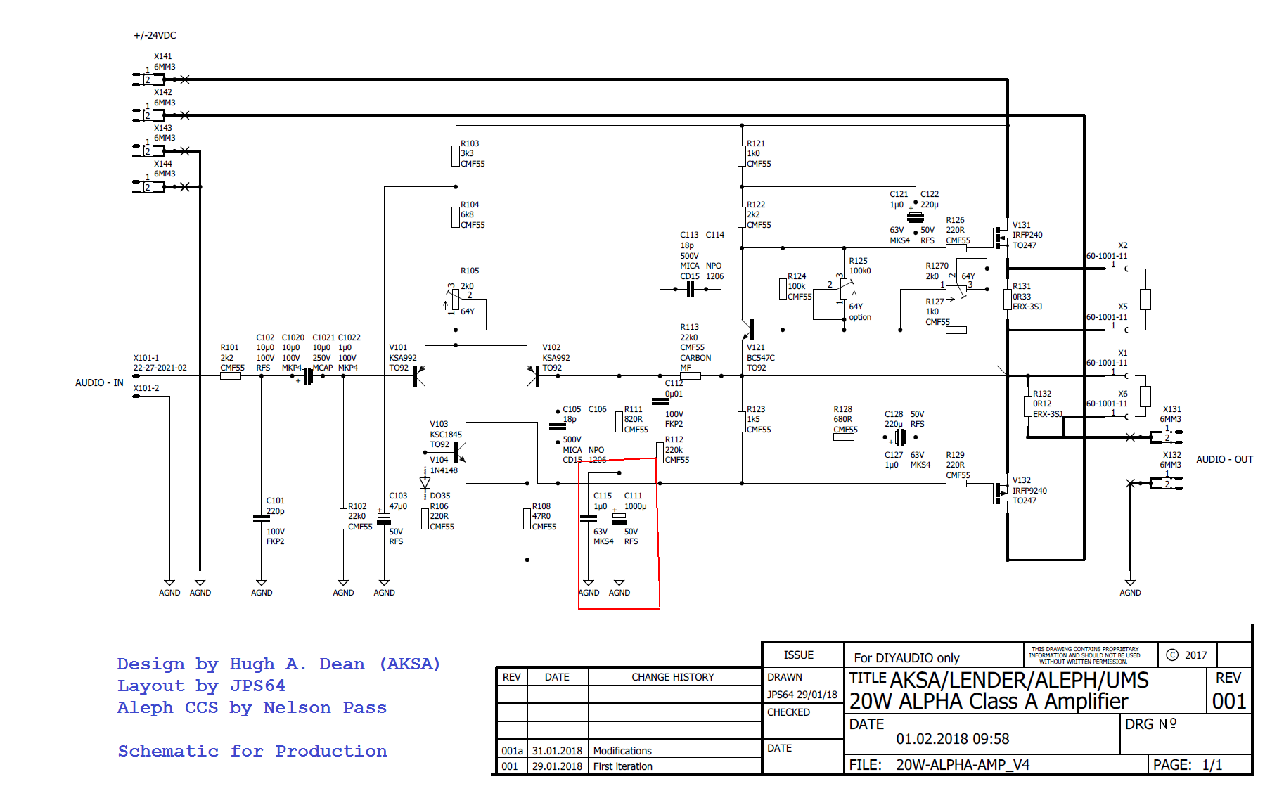

I have to stop with the Big Boy layout.
I see the 20W version circuit went through some (evolution) modification.
No reason for me to finish the layout until I do not see the final tested circuit, it is a lot of hard work to do a proper layout with the Paint.
I see lots of people ordered PC boards (I would love to get some extra power) for the 20W I hope someone can compare this amplifier to Pass Aleph #. I see some similarity between the two. I owned an Aleph 30 for a 6 months period, It was a great amp but I was not 100% satisfied (to me it was a bit bass shy) so I sold her. :) I only wrote I see some similarity, but sound wise definitely will be different than the Aleph 30. :)
The best would be to wait until someone build a BB prototype and test it in real life otherwise I will work a lot in wain.:D

Hi Gaborbela,
Temporary hold
This is good thinking. I agree. Let's wait until XRK has his holiday and then returns to finish the Big Boy.
JP64, again your layout is a masterpiece for the 20W. Thank you very much!
