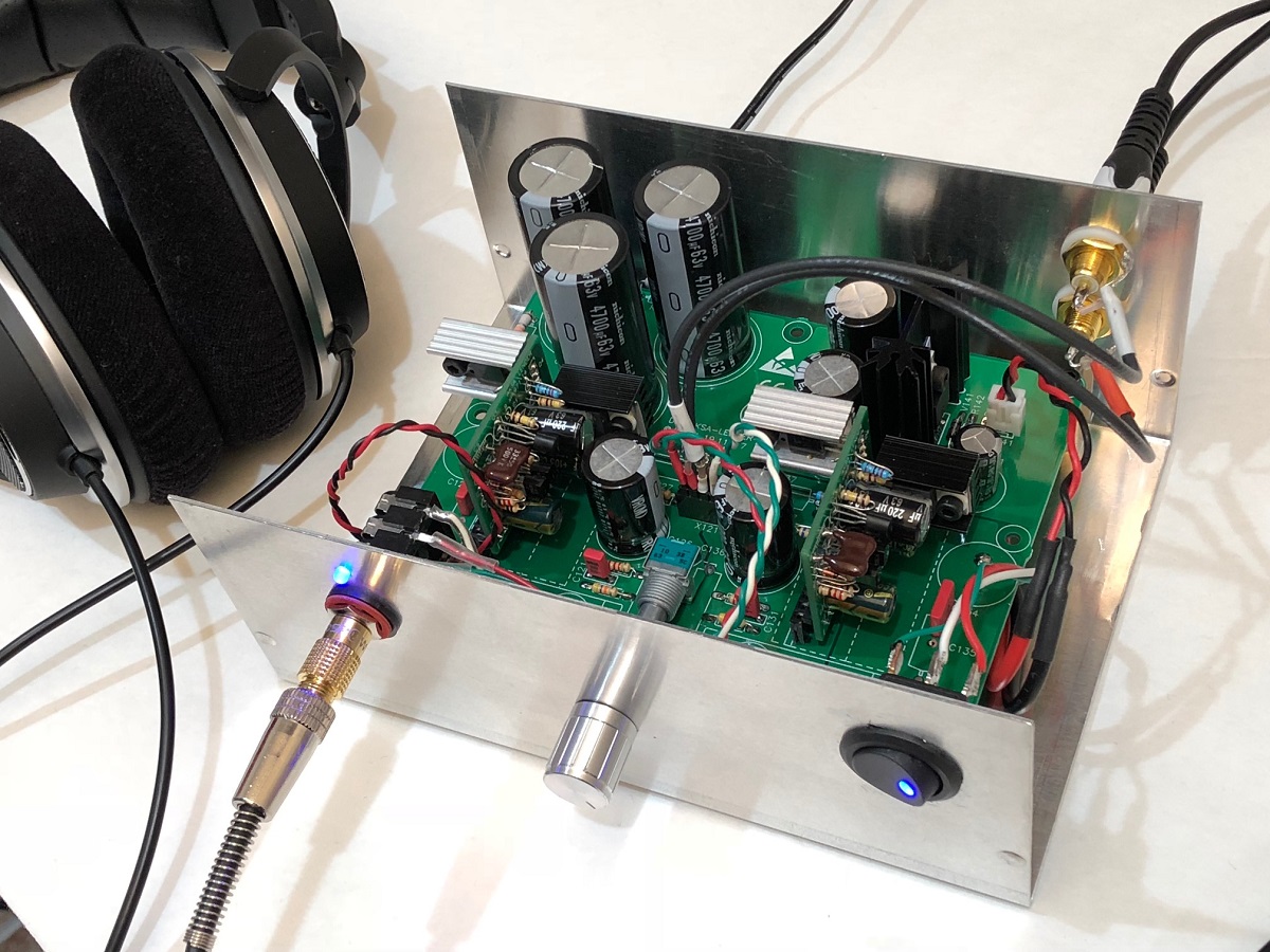

Attached is a pic of the preamp in its new home on top of my ACA.

Your wooden panel faced boxes look great. Very nice and you have something you made yourself and it sounds great. This is the satisfaction one gets that keeps us firmly planted in DIY.
:cheers:
Beautiful work!!
