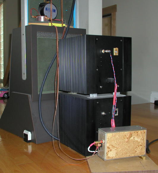

I didn't listen to AKSA, but having a choice between my AX and GC monoblocks, I prefer using the small ampsABO said:

I'm not Fred, but I have listened to Peter's amp and my AKSA 55N with the same speakers, in the same room. "All amps are different" is a nice way to summarize things. Speakers were VMPS RM2 and 626R, and the other amps were Ampzilla monoblocks.
The AudioZone GC didn't do very well with the VMPS, and clipped fairly easily. There just didn't seem to be the grip, even at low volumes. The AKSA did remarkably well compared to the Ampzilla -- very good speed, imaging, detail, but not the same bottom end control as the Ampzilla.
That's NOT the end of the story: the GC was tried on Meadowlark Kestrels. Voila! This combination worked very well. The Ampzillas was good, but not special with the Kestrels. Didn't have time to try my AKSAs on them.
Beautifully built GC v. humble 55W kit amp v. rock solid monoblock: which is "better"?? YMMV! I have tested my AKSA v. amps ranging from Krells (incl. FBP650cx) to Classe (monoblocks even), Accustic Arts, MF and others. It holds its own pretty well. For me, the key advantage is that I can tweak and tune it to my needs. Of course I can do the same with my Krell, but it would be a financially questionable venture.
Oh yes: I've also ventured into GC land, with a TDA7294A amp. Not pure 'GC' in construction, but with short signal paths, and components selected for sound. It offers great price/performance, but won't drive my main system speakers as well as my AKSA. For a smaller setup, with tuning (esp. a buffer after volume control), it's working very well.

Paul Ebert said:
I'm really stretching to save money here. My thought is to build the amps into the bottom of the woofer cabinets. That way, I may save on casework, cables and connectors. My current pricing has the P3A route costing me less than $1200 and the ASKA route between $1100 and $1400.
Paul
so if I understand it correctly 3 or 4 channels built into each
wooofer cabinet.
What surprises me is a lack of discussion of the power supply
for the said 3/4 channels, and any "rationalisation" possible
here.
For example one big transformer is an option, for 4 channels
seperate rectifiers and smoothing capacitors ?
Using a common supply I'd be tempted to add a little RC
filtering to the mid amplifier and and a little more to the
treble amplifier PS's as the power lost would not be an
issue.
An amplifier with doubled up output devices and the
woofers in parallel should be as good as two seperate
amps ?
Or would they be built as seperate "monoblocks" ?
sreten.
I would not put the amps in the speakers boxes
The vibration will affect the sound ( as it also does to the Xover )
better to put the amps in one big box with the X over aswell or even better have each amp and X-over it their own boxes fairly close to the speakers.
you may be suprised how much having the X-overs close to the amp improves the sound. It is much better that regular bi-wiring.
If you using one tranny this will unavoidably compromise your earthing scheme unless you have a tranny with multiple secondaries...
just a few thoughts
hope it helps
mike
just a few thoughts
hope it helps
mike
Sreten,
Power supplies. Ah, what a question!
An amplifier is a modulated power supply. Consequently the supply must be absolutely clean, no ripple, very low impedance, and completely free from intermodulation between channels. We are making malt whisky here; crystal clean, stream water is essential.
Therefore for any multichannel amplifier, as far as practicable, the power supplies should be independent. The AKSA has two completely independent power supplies, one for left channel, and one for right.
If you are making a five channel system, some economy is possible. You can use one supply for left front and left rear, and another for right front and right rear. The center channel should have a power supply of its own, since speech intelligibility is enhanced if there is absolutely no intermodulation with other channels.
Hugh
