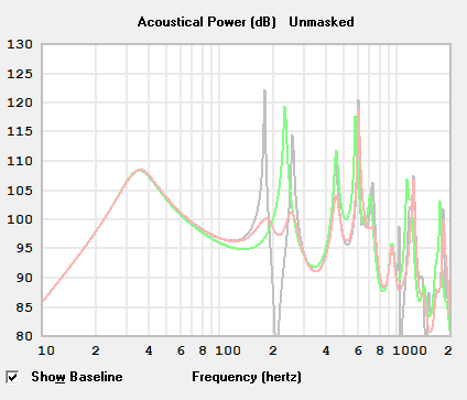

Hornresp already allow to use stub to damp port resonnance. Green without stub, grey stub without damping material, red stub with damping. It totally works experimentally.

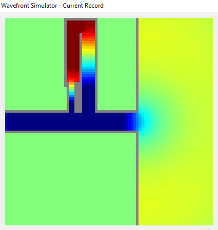

The only difference between this sim, and what i try to achieve, is the use of another stub, larger but longer, to be tuned at same frequency, and connect first to second stub end, maybe at a common chamber full of damping material, don't know yet. It's a re-entrant stub. Nothing that much fancy compared to tapped horns yet well simulated, and all the others re-entrant typologies for wich real life result have confirmed.
I don't master at all hornesp wavefront sim. But picture 2 gives a idea of the re-entrant tube at port and the nulling effect where red pressure is nulled (somewhat) by blue pressure from first small tube. Very bad sim, but it's the idea. Tuning it, trying, playing around volumes, to see how it turns on port response : i imagine that it's not a simple notch filter contrary to stubs.
