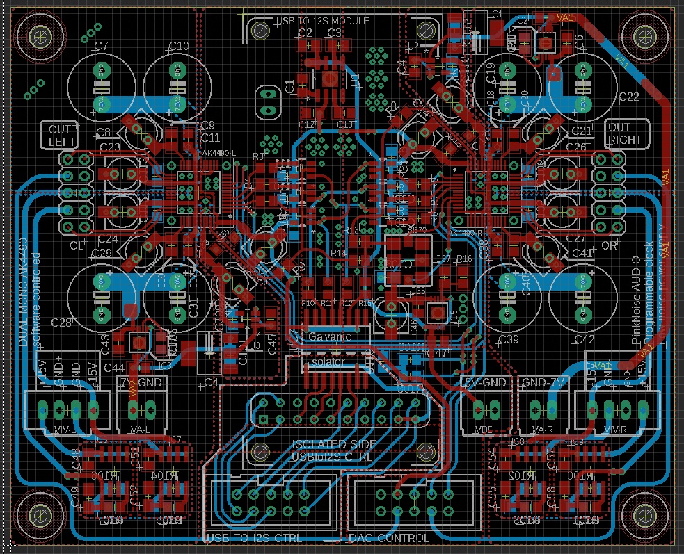

Hi
It's been a while. I actually had this project parked for quite long time in terms of AK4493 (just went forward with the AK4490 version) but as I've just got back to it in last two weeks, here is some update.
I got lots of issues with AK4493 version and got very frustrated. I saw performance peaking at -115 dB THD+N (or even -116 dB) but results were not consistent. My test board measurements were very promising I had posted here, but in the actual small form factor application PCB they were not. Or if I got one board working well, and made two more, results were all over the place.
One major difference in the test board was separate power supplies for all four VREFL, VREFR, VDDL, and VDDR. In my application board VREFL/VDDL and VREFR/VDDR shared regulators. Anyway, capacitors were the big headache. And a note here that this has been purely technical analysis from measurements perspective.
I've tried different sorts of caps: ceramics in different capacitance and case size, electrolytics, polyelectrolytics, polytantalums.. Some work better, some worse. Overall, with LT3042 I did not measure improvement when using large (hundreds or thousands of uF) electrolytics or tantalums; in fact performance often got worse. But I know some others have used them successfully.
The oddest thing was that just by moving a 100n or 10u ceramic from a placeholder to another (I have several onboard), in some cases THD+N swinged by 15 dB. I thought maybe there was something odd in my supply impedance and tried to carry out supply/plane impedance measurements. Learned a lot about that but unfortunately measurement conclusions were not so clear; maybe I just didn't measure it correctly.
Went back to trial and error method, just trying loads of caps and measuring audio performance. I did find a combination that gives solid and consistent -115 dB THD+N (around -121 dB THD) across five boards I used for tests. Not a huge sample size still but definitely a lot better and more consistent result than before.
Maybe there is something in my board that makes it so sensitive to the capacitance, I don't know. But it wasn't easy to find a solution with LT3042 and AK4493. With AK4490 I didn't have such issues when tried it.
I have attached some measurement results. Now THD+N vs level is straight line almost until maximum level. Also THD+N vs frequency is almost straight line which wasn't the case with some other LDOs I tried. You can find more measurements here W-DAC 4493 – Very high performance compact DAC – nihtila.com
Oh yeah, the killer cap combination in this case? 10u ceramics directly at LDO output, then 2x 10u 0603 ceramics at VREF and 100n + 10u at VDD. No fancy large caps.

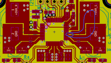

Let's see my board, pic attached. I've drawn a loop for the closest ceramic decoupling cap and for large electrolytic (if it was used). As can be seen, these current loops are not in the planes but on local top layer traces. The group of four vias you see are then connected to ground plane and power plane. I guess if I wanted to use a ferrite, this point would be suitable. But even like this the loops should remain local.
Even if the return currents would be on planes, it's unlikely they would cause much issues for audio signals as they are differential. But of course minimising loop area and keeping them as local as possible is one of the main PCB design guidelines.

I agree with the PDF you've linked, at least mostly, although it seems it was written a long time ago. Physical scales are a lot smaller now, but so are frequencies higher. It mentions decoupling cap to IC trace lengths as 2cm but for example mine are closer to 2mm. I'm also not sure how likely these large loops are to form, after all the current will choose the lowest impedance paths. But true, there will be some resonances.
It certainly is quite old. Guido wrote it in the late 90ies for philips (as stated in the document). Physics don't change though. Technologies do though.
I don't really look at the actual numbers. They do seem outdated.
The point is that we now know how to use ferrites and how to lay out our circuitry with proper emc performance and the document explains it well in my opinion.
Proper EMC doesn't require ferrite beads on every line. It's just at levels of -115dB, many things become relevant. I'm rather safe than sorry in this case. Especially since ferrites are cheap cheap.
I wouldn't both with such a big electrolytic. The largest current the dac consumes is 50mA on the VDDL/R. The LT3042 or any other proper regulator should be able to do that if you have good decoupling techniques.
I would also place the via's near the close decoupling capacitor. It makes the current loop much smaller. As I said before, at -115dB strange things start to become relevant. Moving the via's might be a solution that comes free of charge!
You assume here that all stages are perfectly balanced. An impedance imalance of 1-5% isn't strange. We also don't know how the dac itself operates internally. Maybe it's two single ended dac's with a differential outputstage.
Personally I think it's better to prevent the problem at all. Especially at the cost of 10 ferrite beads (or whatever amount of power supplies you use).
Electrolytics are part of decoupling techniques. They help in supply impedance especially in mid frequencies, and losses of electrolytics may be useful as well (although such large have low ESR). LDOs like LT3042 themselves can push the impedance low in those frequencies so it may not bring much extra. And that is the case here, and that's why the large electrolytics are not populated with LT3042. However, the difference in supply impedance is clearly measurable.
Vias are not part of (AC) current loops between IC and decoupling. They are deliberately kept out of the current loops formed through decoupling caps. Think of them similar to your ferrite beads in terms of placement here - and they do have small inductance as well.
