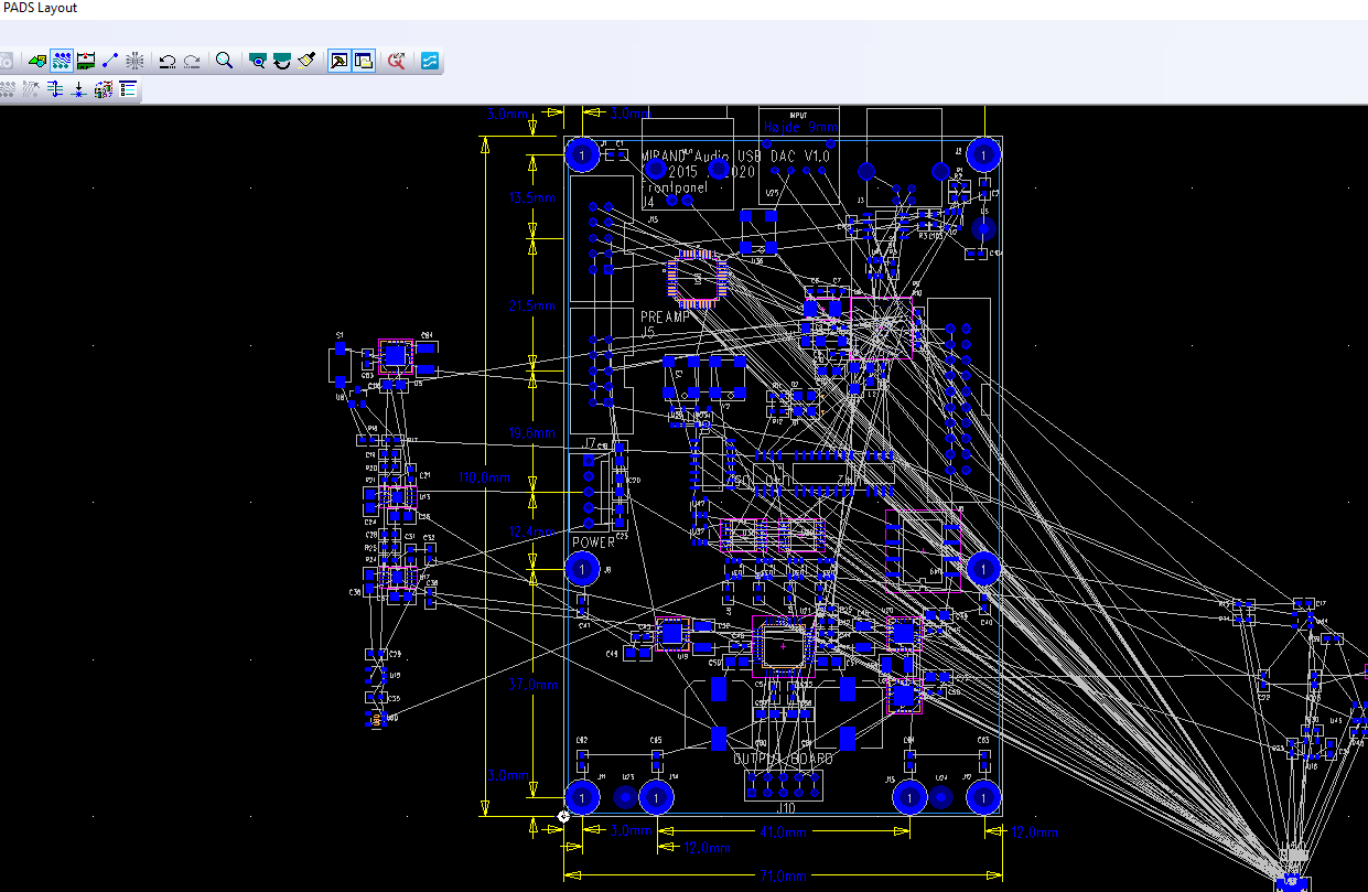

Well i did start on it today.
Until now it looks like the picture we have attached. The difficulties for me is to get all the parts down on the same footprint.
It will have 1 pcs of SPDIF RCA and 1 pcs of OPTICAL input.
It has the same clock oscillators but now it is galvanic isolated and has reclocking.
The DAC board will need some kind of frontpanel as we need it to switch sources.
The XMOS has never been powered from the USB. We only power it from an internal +5V supply
