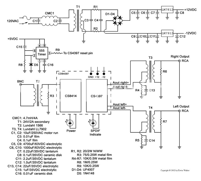

Thanks ChuckT. i will experiment a bit more. which transformers are you using? Can you share the value of the RC network in your setup?
I just use what I had on my hand at the moment, a cheap and really odd Nihon Kohden 37+37+37: 87+37 , probably for telephony. But interestingly it works nicely, I will of cause try out other more "suited" transformer.
The RC I just follow Joe Rusmussen values, around 1K and 20nf.
Hi Quantran,
I am planning to try using the same transformers as yours on an AK4490, could you post a schematic of the way you have yours hooked up ?
Thanks,
PJN
I am using the following schematic now.
Hi Quantran,
Thanks,
PJN
I only connected the transformer primary pins directly from +/- pins , nothing else. I added snubber across secondary pins and plan to add one more filter caps across.
Note that snubber is required (value depends on particular transformer) to reduce ringing as I was testing varous transformers with square wave and scope and see some ringing.

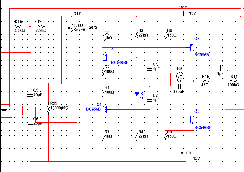

Old thread but, I have been using this with regulated power supply with AK4396(not too bad distortion). *BTW* you can use this circuit without any filter and coupling caps form the dac + channel, the - is left disconnected.
AND BTW, this can be used with TDA1541 with great success by skipping R10, connect direct to R11, important: set the trimmer to nul out the DC offset at the end of the TDA1541, best with OSx4.
If anyone want to improve this circuit or use it as is. I use BC546C in matched pairs instead of the BC546B.

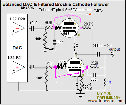

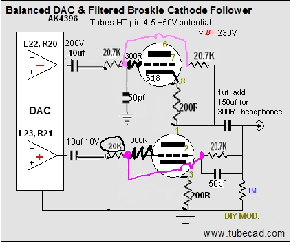

The best solution would be tubes.
Thinking of 12au7 input differential amplifier and Broskie unbalancer with 6DJ8.
Along the lines of a 230 - 245 V power supply depending on the chokes and current around 40ma for stereo.
Still to determinate... dual chokes power supply or single choke.
Input resistor, 330 to 510 ohm Not sure why or not.
10K to ground after dac V out
From page 2 of the schematic:
R1 R2, uncertain 10K to 1M ?
R3 R4, uncertain 300 to 500?
R6, 7R
R7, R8, 24K
R9,R10,R11, R12, 20 to 27K , uncertain
R13, R14, 150 to 250, uncertain,
R15 1M
C5 and C6 filters around 50pf to 60pf
One big question is why not bypass the Rk of the unbalancer?
From page 2 of the (internet available, I/V unbalancer) schematic:
R1 R2, Set to 3.3k I was going to use 10K but I found other builders and other schematic with a 2.5K to ground. 3.3K is the ideal resistor that I found by trial and error to load only one side of the signal into a transistor I/V (symmetrical cascode?) and unless the distortion is too high I will keep this resistor, maybe 6.6K would be appropriate too.
Note10 on the manual of AK4396 specify 1.5K minimum for DC load. at 3.3K should keep the dac happy!
R3 R4, Set to 300R
R6, = 7R or a little higher
R7, R8, = 24K (2watts at least)
R9,R10,R11, R12, Set to 20K or a little higher
R13, R14, set to 200 or a little more
R15 = 1M
C3 output cap, = 3uf to 5uf with bypass

Hi Zoran, did you built an output buffer for the dac ak4396?
I posted this schematic, in all honesty, because it 'bests' unconditionally anything I have heard in opamps.
I have a schematic with BCs transistors, not jfet.... I might share if you would like to show you what you have in mind for the dac. I am not an electronic engineer and this is time consuming for me to design something from scratch from your instructions.
I will not use a transformer in the signal path... no time no money for that.

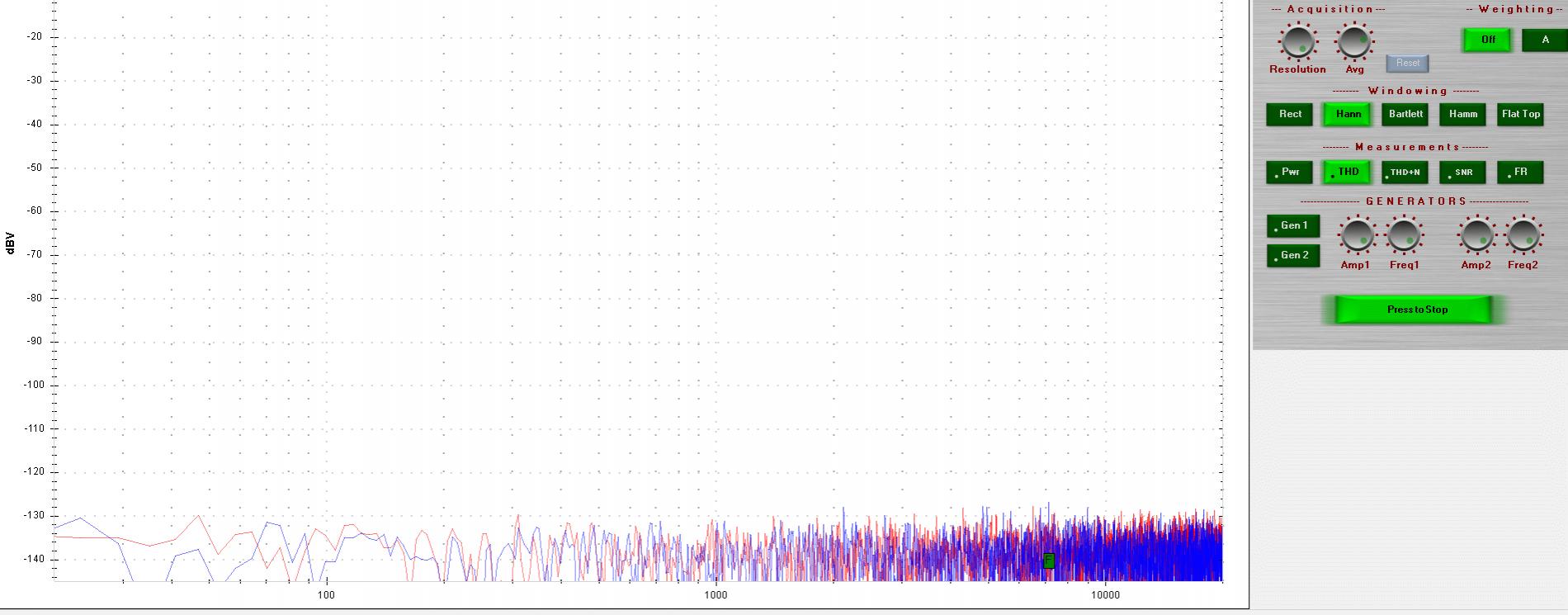

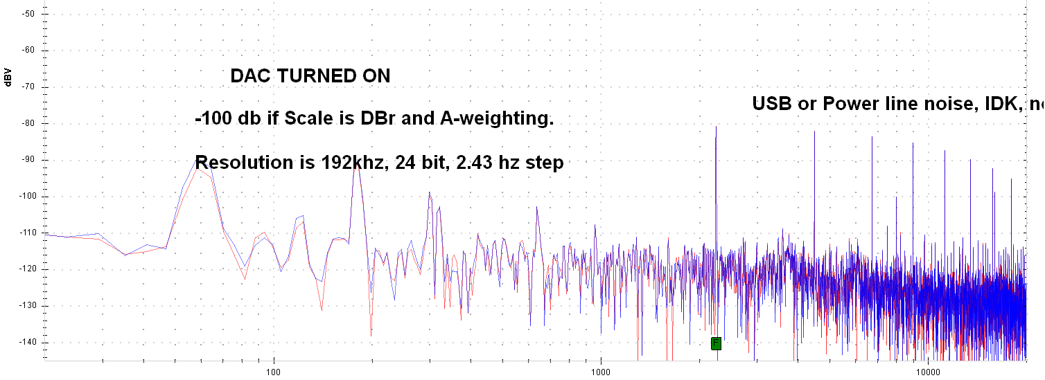

I will measure my dac, which I only listen by ear so far, the sound was good enough, I trust my ears for that, but I will take some THD and bandwidth readings for your intention.

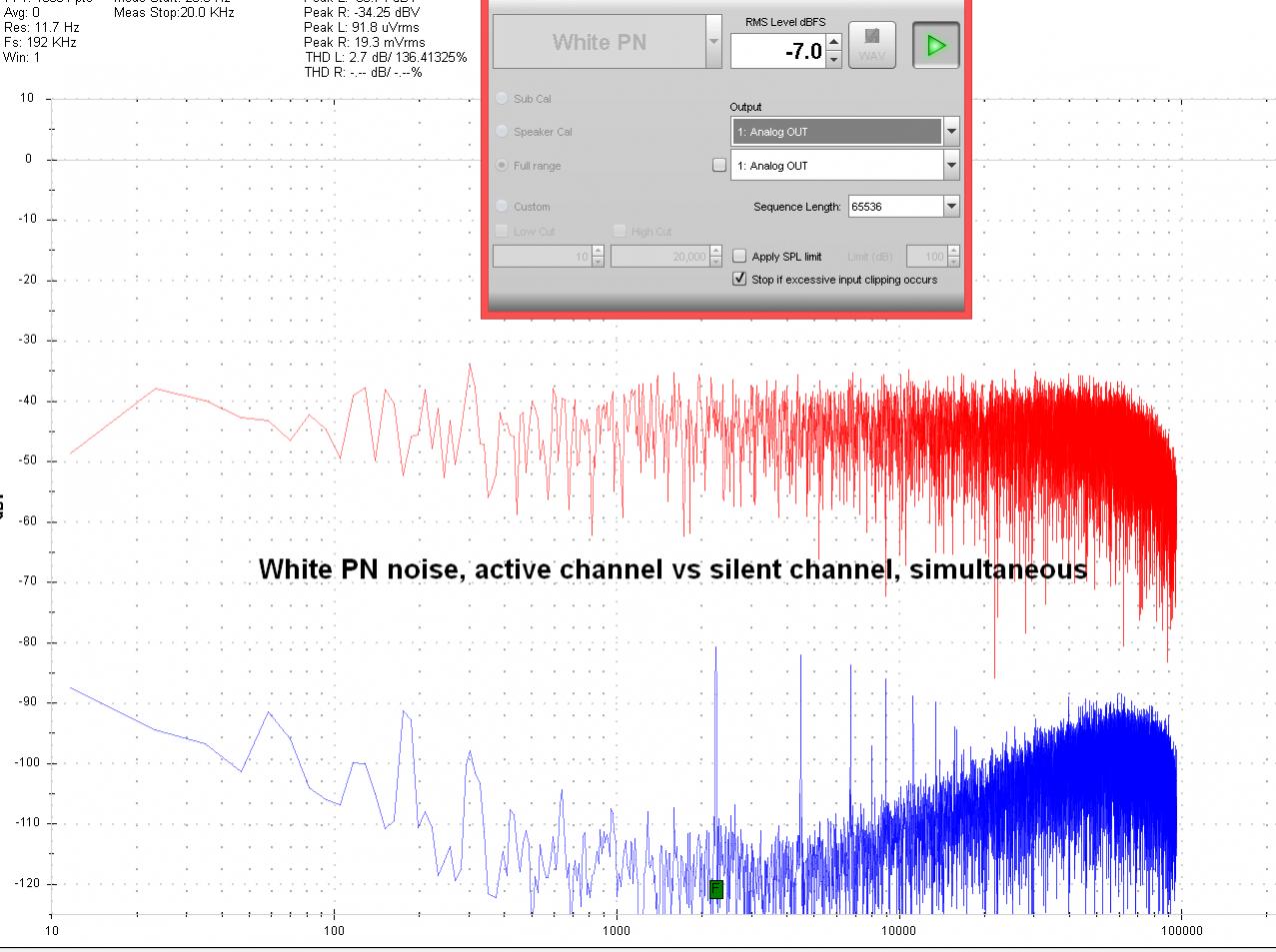

I tested with 13 different tones from the online webpages generator, opened 13 pages lol. and it looks like the resolution is high in the high frequency and around 50 db in the low-midrange. This is not bad at all!
I did then more serious tests, the output is at max around 800mV.
at 750mV : bandwidth (-3db) 7.8 to 68500 hz , THD 1khz 0.010% (+Noise non-A, dBv, 0.023%) at 100hz 0.021% and 0.020%, THD diminish to non-measurable over 5000khz +

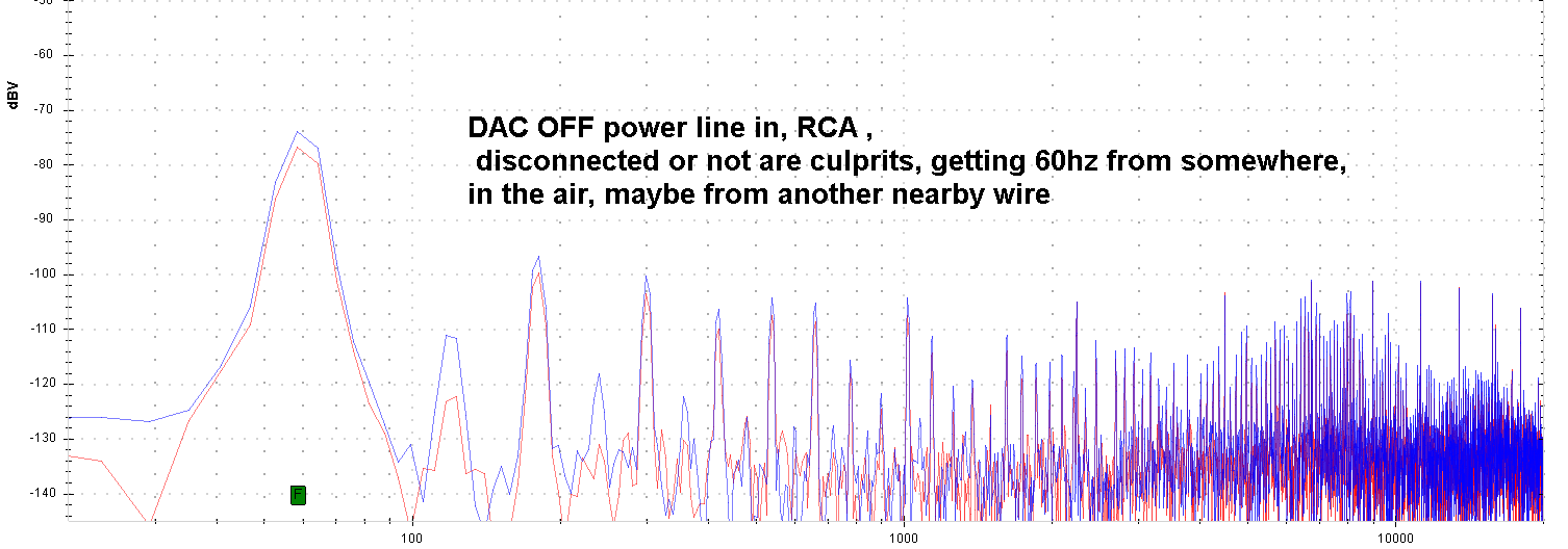

Note that the dac even disconnected has some 60hz interference, it is not in a box
60 hz is air-borne antenna effect of the RCA wires. Even with disconnected power cord it has it as soon as I plug in the measurement tool.
The spikes is from the 'dirty' house electricity, I guess my neighbors CFL, and all the ClassD wall adapters, and fridge motor... They disappear if I disconnect power cord to dac. They go into the rectifier and are amplified in the tube output stage, I guess a power line conditioner would help a lot in a permanent build.

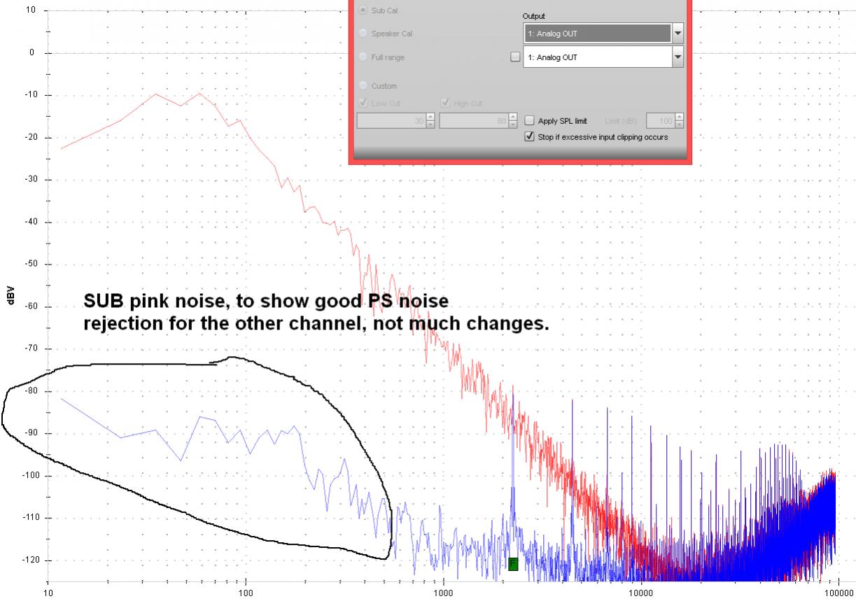

O. more important not to forget, Both channels are the same!, same thd, same response, etc, pretty cool, and almost no cross talk, due to one 10H chokes and 220uf in each tube. hurray, nice work!
