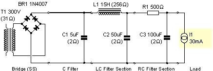

Hi !
Thank you, you were right, adding a RC section made a noticeable difference ! Ripple have lowered even more. (Around 2mV).
The RC values you mention seems to be right on target. I found a choke from Hammond which gave nice results but I needed to lower a bit the L value (15H) from the 25H suggested.
Beside that, if my calculation are correct, the resistor will need to dissipate something like 30watts with a big rush during 200ms on power up so I'll probably go for something like 50watt resisor depending on size.

Elkaid said:I found a choke from Hammond which gave nice results but I needed to lower a bit the L value (15H) from the 25H suggested.
That looks fine. The 25H was just a ballpark guess. You don't need to worry too much about the short inrush current for the resistor. The ratings are determined for steady state conditions. It won't heat up fast enough with a brief inrush to matter. The 500R resistor will dissipate about 1/2 watt at a steady state. A 5 watt there will be more than adequate. You can use larger, but there is no benefit.

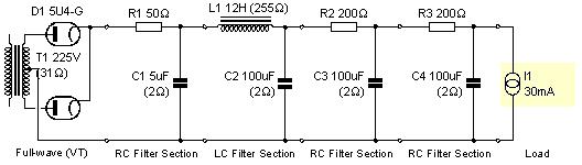

Hello everyone again !
I was playing with PSU Designer lately and came up with the following power supply.
I have never built tube-based power supplies and your comments would be very appreciated (again !)

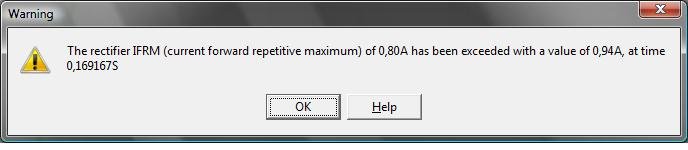

Btw, is that normal that the software returns an error message box if I increase C1 to let's say 10uF ? I'm asking because my current value (4-5uF) is relatively close to 10uF.

Here's a screenshot of the error
I assume the error is within the first second of the simulation? something like a high spike on the graph?!
You're right, it's a spike lasting 0,0000000000000001 second dropping rapidly right at the power-up (0.00 sec)
(well, it's a bit longer than that, but let's say that the current is over rectifier specs during 100-200 ms max)

Elkaid said:Well, my error sorry, I was getting the message with the schematic I posted but with a single rectifier tube. (I added the second rectifier tube to get rid of the error message)
Can I conclude that if I get this message during the first second following power-up I can "ignore" it ?
I think Erik hit it.
I'm curious; when you say you did it first with a single tube, do you mean you simulated it with a half wave rectifier, using only one diode? The full wave rectifier you show would be the typical usage.
Yes, you can safely ignore it. As Erik said, that spike will not occur during normal operation because the filament heats up gradually. The closest you would come is to shut the supply off long enough to drain the cap, then turn it back on before the filament has cooled too much - don't even know if you could do it under your load conditions and reservior sizes.

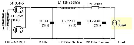

Also, I managed to decrease ripple even more with the following schematic (now ¼mV):

Elkaid said:Also, I managed to decrease ripple even more with the following schematic (now ¼mV):
I would think that something along the lines of your previous model would be more than adequate for an Aikido line stage. One of the key features of the Aikido is outstanding PSRR, or noise rejection. I think you are well into the territory of diminishing returns with the latest version. But by all means, model away.

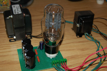

Hi everyone,
I just finished the prototype of my first power supply using tube rectifier and I thought some of you might be interested in some pictures so here they are :
(Here's the schematic ) I get around 350Volts wihtout load but should go down around 260Volts once the aikido connected.

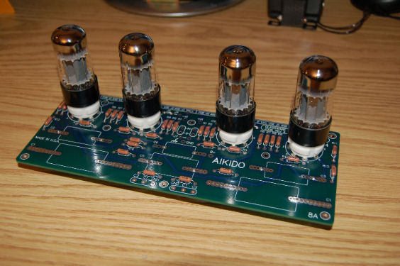

Hi everyone,
Since my project is almost completed (chassis not completed yet), here's my results.
As many diyers here, I experienced 60Hz hum. It wasn't that much but enough to make me wondering. I knew that I could do better.
I was using "cheap" Electro Harmonix 6SN7 for both input & output tubes and AC heater. I tried "grounding" filament supply but also referencing filament supply to ¼B+ without any success.
The only solution left was to use DC filament supply. I made a quick experiment using unregulated DC filament supply and "grounding" it through a 0.1uF cap. All of a sudden, the hum disappeared. The Aikido is now dead quiet.
Well, right now, I'm putting my efforts in completing the chassis.
I hope this will help anyone interested in Aikido building.
