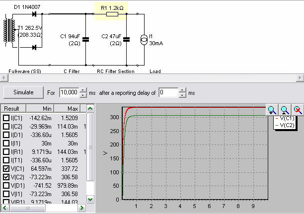

How about just a simple power supply with a Hammond 269JX > A Full Wave Rec, pair of Paralleled 47uF caps, and a 1.2k-1.5k/47uF RC filter. Draw your B+ from the RC filter which is pretty clean and with the noise rejection of the Aikido should be plenty decent for a Simple power supply... (figure a 30mA draw as above post indicates)
A simple bridge rec + 47000uF cap to get DC heaters...
Very low tech but... I don't see how it'd be a bad supply as this is not a Power amp so current demands are minimal.

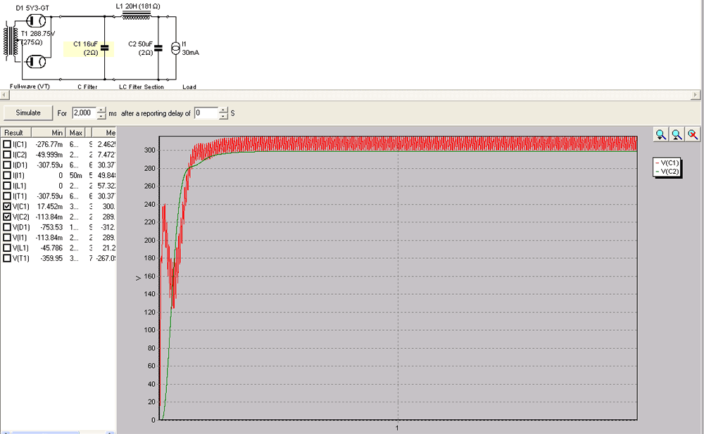

Well, I finally seem to have things figured:
Hammond 270BX 275-0-275 50mA for the power transformer
Hammond 167L12 12.6VAC 2A heater transformer
Hammond 193C 20H 181 ohm choke
16uF for Cap1
50uF for Cap2
5Y3GT rectifier
12SN7 preamp tubes (I may swap the outputs to 6DJ8)
I'll use secondary filament (5V) from the 270BX for the 5Y3GT
The 12SN7's require 12V, so I'll give them 12.6V AC from the Hammond 167L12
What size fuse should I use for the IEC socket????
The schematic from PSUDII is attached.
Please, please send me comments.
Thanks,
Charlie

Awesome project. Having designed a number of PSU's from scratch,
I think I can save you money...
I'd go for the Triode Electronics ST35 replacement power transformer. This is 330-0-330 180mA plus two windings that each do 6.3V / 2.2A.
I'd use 1 6.3 winding to power a 6V rectifier of your choice... I like
the 6X5, EZ81/6CA4, 6BY5. You can pick up the 6V full wave rectifiers far cheaper than vintage 5V rectifiers. Plus, you can use the small 9-pinner (6CA4) to keep the overall size of your PSU managed.
The important design parameter to manage when modelling is PSUDII
is the Peak Current through the choke.... Select I(L1) and look at the current pulses.... Do any of the pulses exceed the mA rating of the choke? If so you choke is not going to cut it. You choke needs to be rated much higher than the idle draw of the load. That's because of charging pulses of current that are drawn by the capacitor when the rectifier switches on.
The Triode Electronics transformer is really nice, and its small, and it will provide way more B+ than you need.... With a second LC filter stage, you will also be able to power a nice phono preamp too!
-- Jim

I think I can beat your design proposal in cost, performance and parts.
Try this; its a choke input supply (use an LC filter)
Triode Electronics ST35. T1 = 346V 91 ohms (for 330V / 180mA)
Pick a 6V rectifier: 6X5GT, or EZ91 (6CA4)
Hammond 195L Choke: 10H 155 ohms 125 mA
50uF cap (just parallel up the 25uF section of the JJ Electrolytic)
You'll get 1V ripple on 299 VDC. I(L1) < 125mA which is great.
It will be much quieter than a CLC supply...
Use 1 6V winding to fire the rectifer, the other 6V winding you can use at your leisure.
This supply will let you draw more current than 30mA (!). With
an additional LC stage, you can also power a phono preamp which you can put in the same box as the Aikido preamp.
-- Jim

The important design parameter to manage when modelling is PSUDII is the Peak Current through the choke.... Select I(L1) and look at the current pulses.... Do any of the pulses exceed the mA rating of the choke? If so you choke is not going to cut it. You choke needs to be rated much higher than the idle draw of the load. That's because of charging pulses of current that are drawn by the capacitor when the rectifier switches on.
Does it really matter if the choke saturates while charging the caps? Handling post cap charging peak AC + DC aggregate current should do, should it not?

This seems like a lot of ripple for a preamp. Of course, the Aikido topology may help, but why not shoot for an order or two of magnitude smaller ripple. It isn't that much more difficult or expensive (e.g., another LC or RC stage).
Yeah... look back at my post #7... Dirt simple dirt cheap and a ton less ripple... and no droopy a** 5Y3 (Hate that rectifier), no choke...

As it turns out, I am building an Aikido-based phono preamp right now. Here is the power supply (300V, 50mA):
Hammond 270DX (275-0-275, 90mA)
5U4 rectifier
20uF ASC oil polyprop
Hammond 193C choke (20H, 100mA)
50uF ASC oil polyprop
Hammond 158M choke (10H, 100mA)
300R resistor
Ripple is 6.5uV according to PSUDII - not sure how much I believe it, but it will be considerably lower than 1V.
