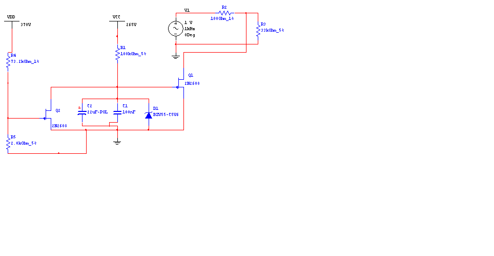

here is a quick idea for a p-channel JFET muter for people who want to use tube regulated supplies like me.
I dont know if it works yet as my sim doesnt like it.
It should also mute the output on turnoff too but it depends on how much capacitance you have in your supply.
The 100 ohm resistor represents the output impedance of the aikido (just a guess) and the 33K is the input impedance of the power amp.
will it work do you think?
Craig

Will the muter work? Don't know, looks strange to me - like it would
turn on when it should turn off, possibly. Are those P-channel FETs?
No - I don't get it. Sorry.

They are P channel jfets so they are in full conduction when there is 0 V between gate and source, so charging up a cap at Q1's gate will bring it out of cunduction. Therefore at start up the output is shorted until the cap charges to about 5.6V then the FET should be off completely allowing the music though.
Discharging the cap via the other p-channel fet (Q2) (assuming its gate can be brought ot 0 V before the thump) will bring Q1 back into conduction shorting the output again at turnoff.
As you said at the end of your post the tricky part is getting the voltage to the mute circuit low enough before the transient at the output caused by the regulators dropping out :scratch:
I dont really have room to use relays unfortunatly.
Craig
