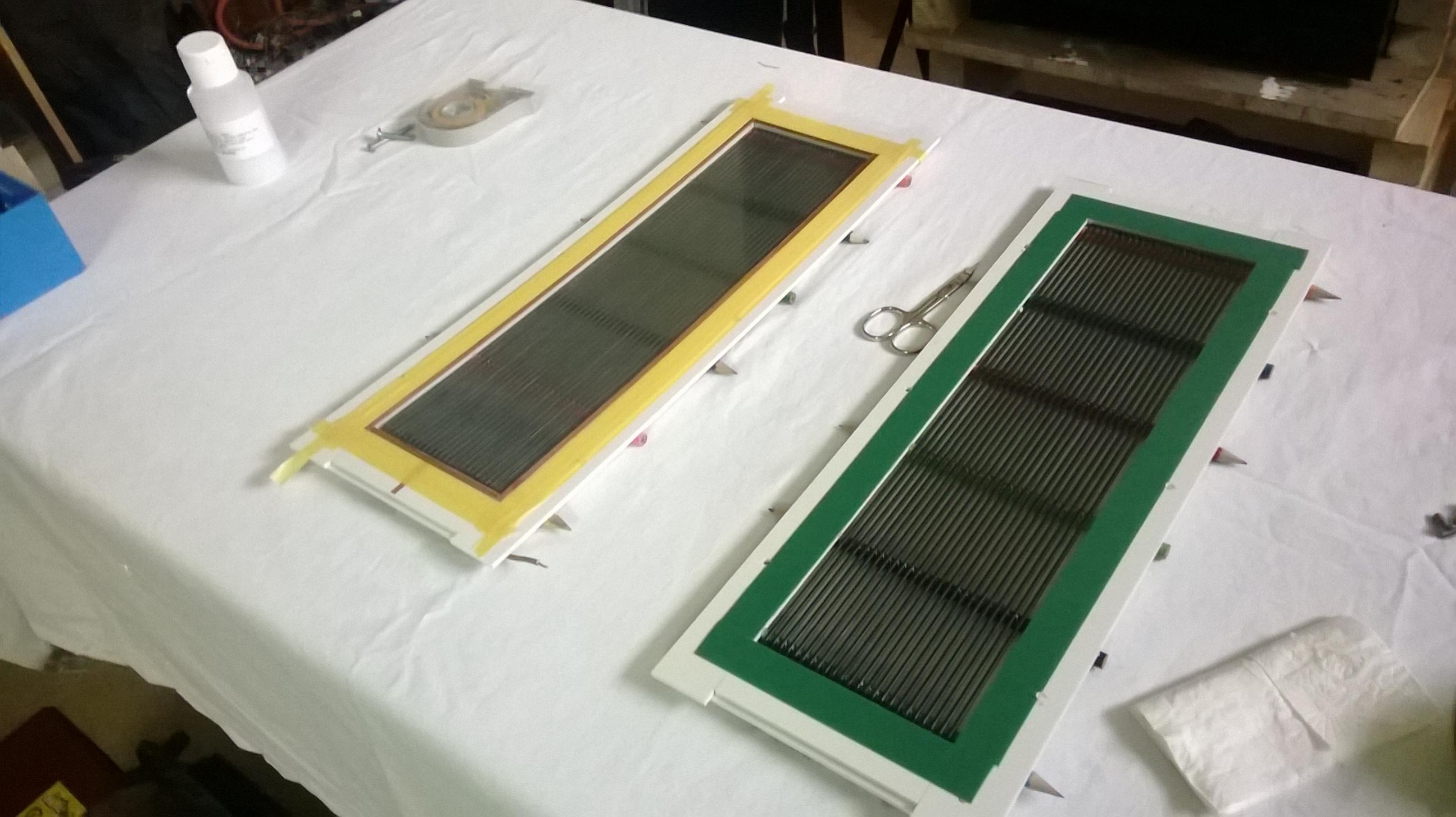

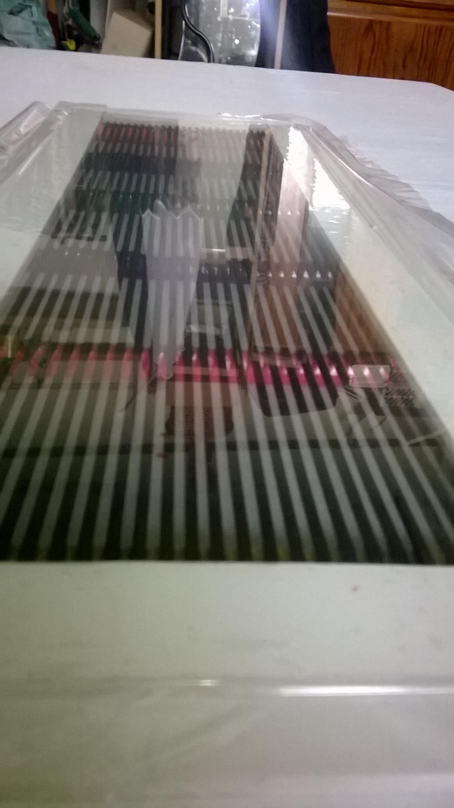

Hello,

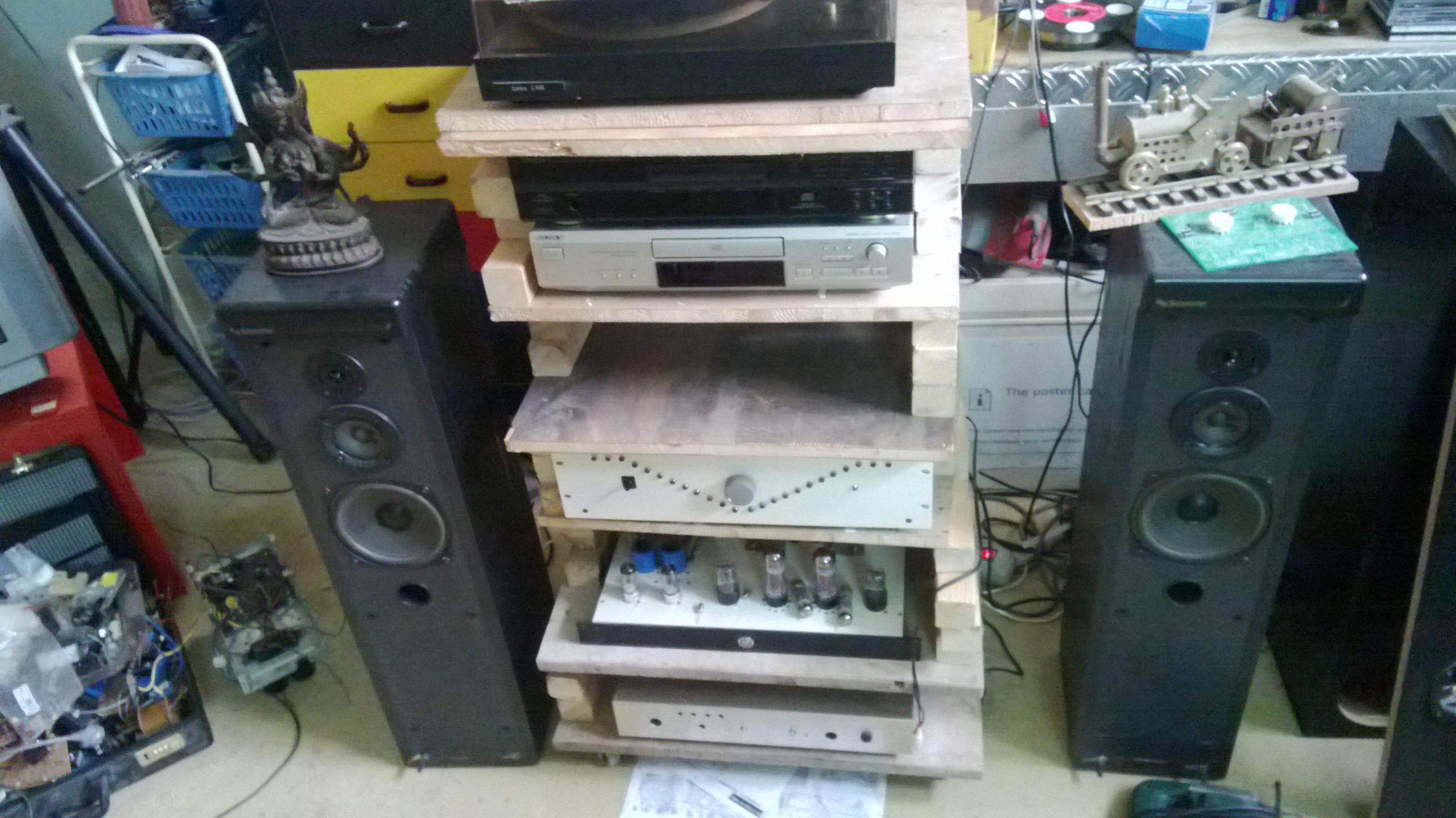

my name is Christoph and I will build an ESL right now after thinking about it the last 10 years. I want to build a wire stator (1,1 mm diameter wire), about 3 inch wide and 31 inch high. It will be a hybrid. I have no questions so far, but I have been reading this forum for days and weeks and I would like to thank you all for your input, it is the best forum for ESL-DIY I know. The only thing I can give back are some pix....
The pictures just show some of the material I have gathered so far. The last pix show my "equipment", nothinmg special, just a SE amp with EL34 and a simple Gainclone. I love both, never owned a comercial amp until now, and I am 37 years...... Sorry for my bad English, school is far away

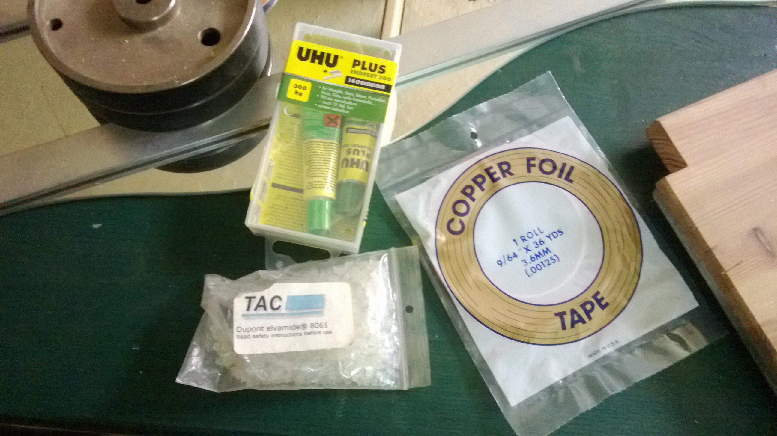

Starting with the Stator, the Pix show some small parts, elvamide and mylar that I bought from the audicircuit (Hans Zeuwe) 10 years before, my homebrew "rack" and my preamp, work in progress.
Thanks to Jazzman, Calvin and all the others!!!! If the ESL will play, good! If not, I will start all over again, its a hobby in the end.....

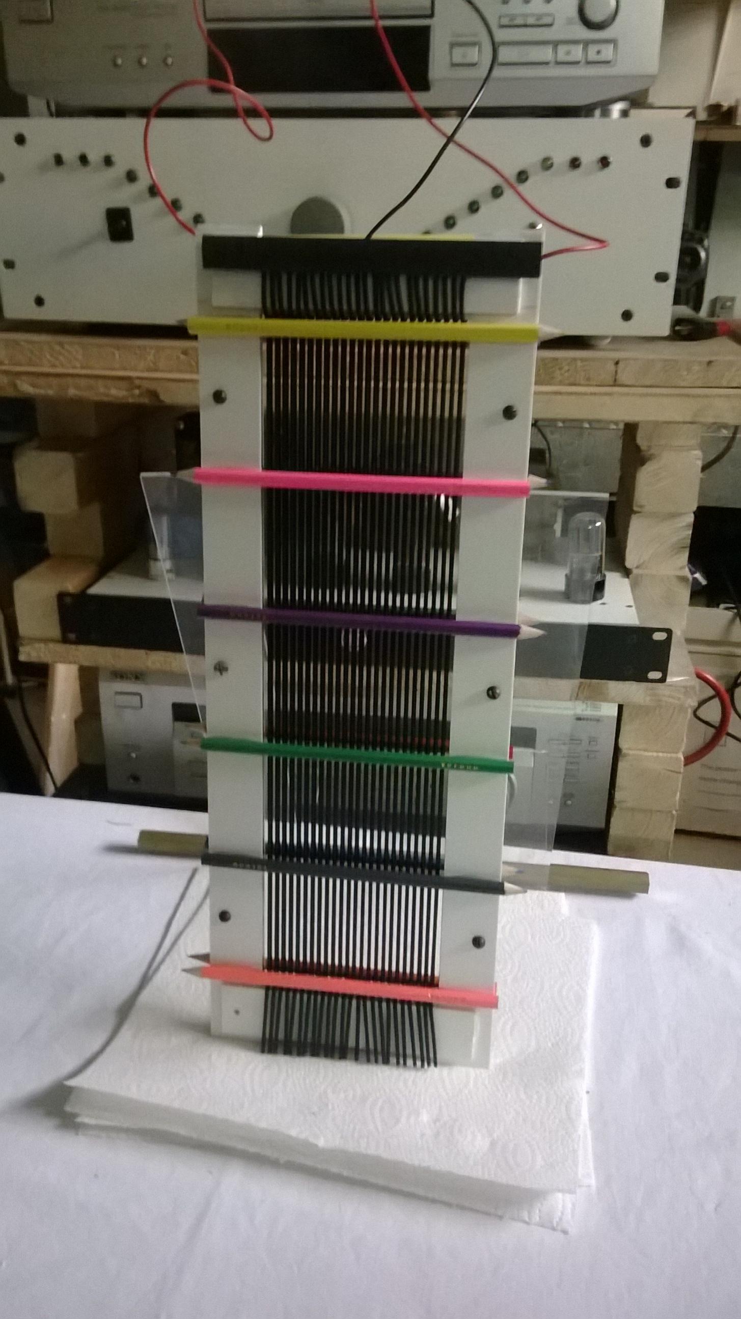

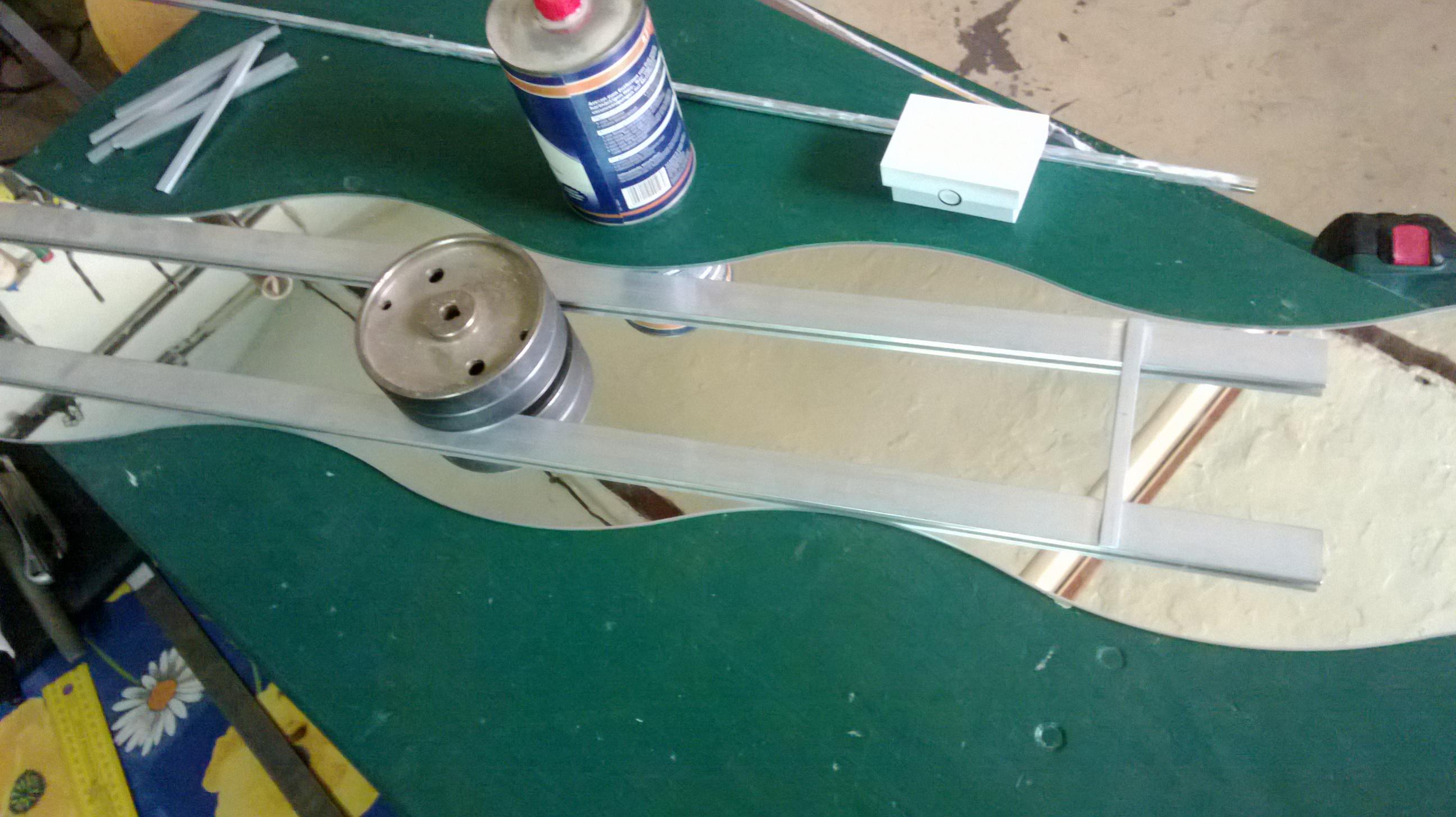

My "first contact" was the "Audio Circuit", at that moment I started collecting all the information I could find about ESLs. I will keep you informed about my progress, but my problem is huge, too many interests, too little time .
In the moment I am building a simple stretching frame for the Mylar and a even simpler stretching frame for the wires...

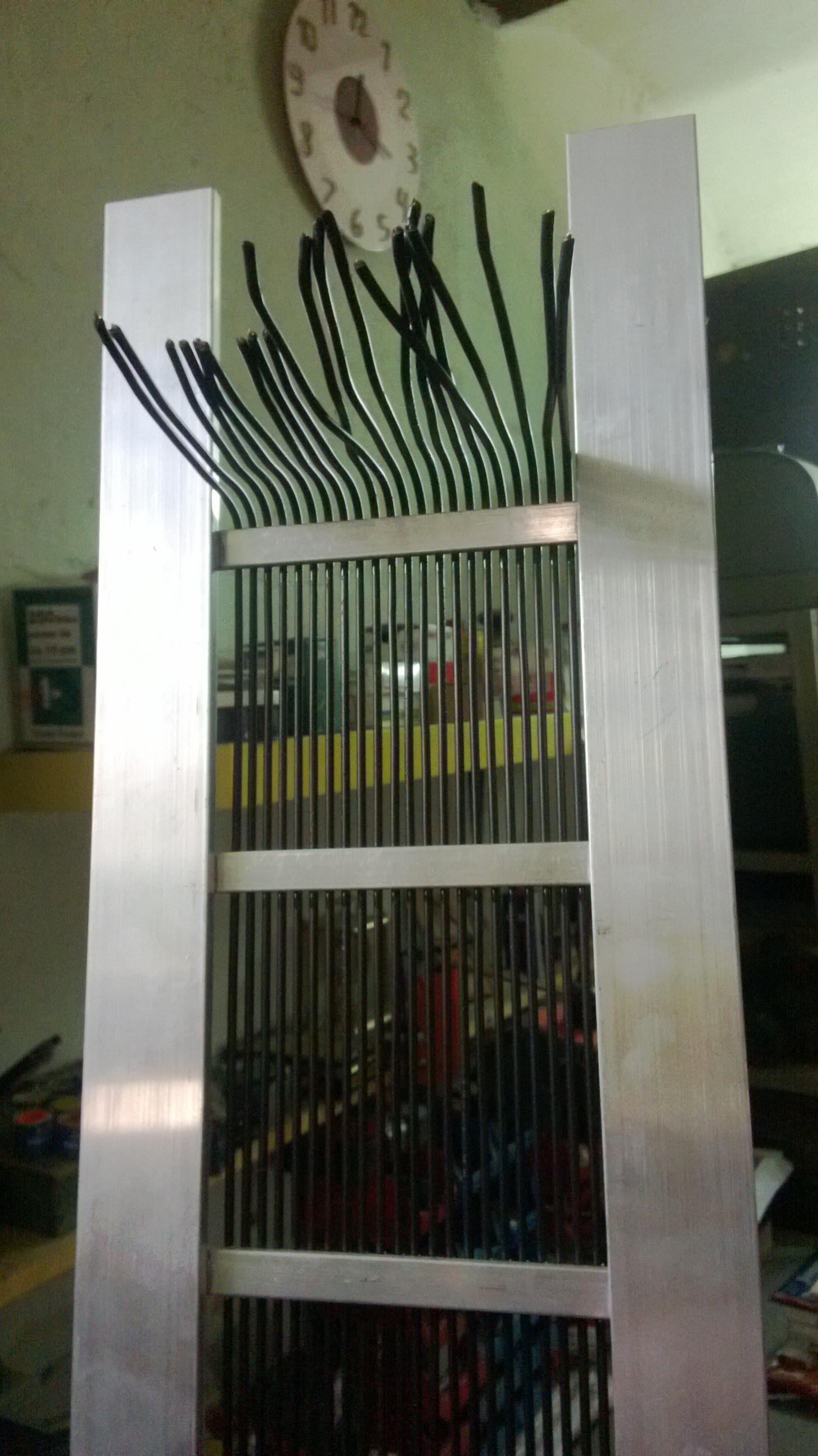

The frame is best made out of a highly insulative material.
There was a thread discussing the issues of the effects of using conductive support bars for the wires and how they can/will cause issues with the electrical segmentation,~I.E. capacitively coupled AC Shunts if you will between each (and all) of the sections.
jer
P.S I would definitely consider coating the frames with about at least 10 mil of some clear laquer of some sort.
Clear Acrylic Enamel is my choice and I have found it to work very well, with as much as 1500v to 2100v per mil of dielectric strength.

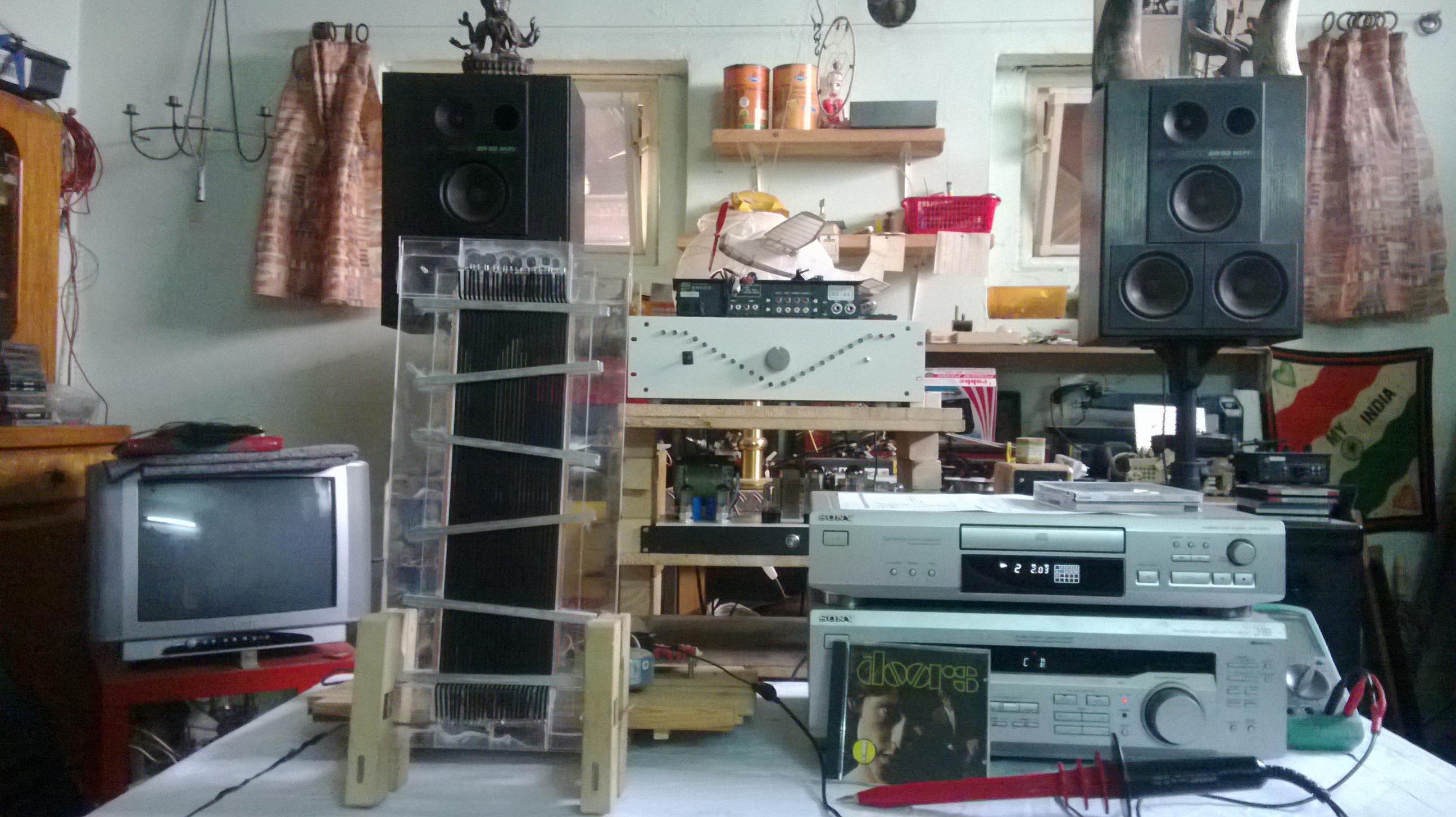

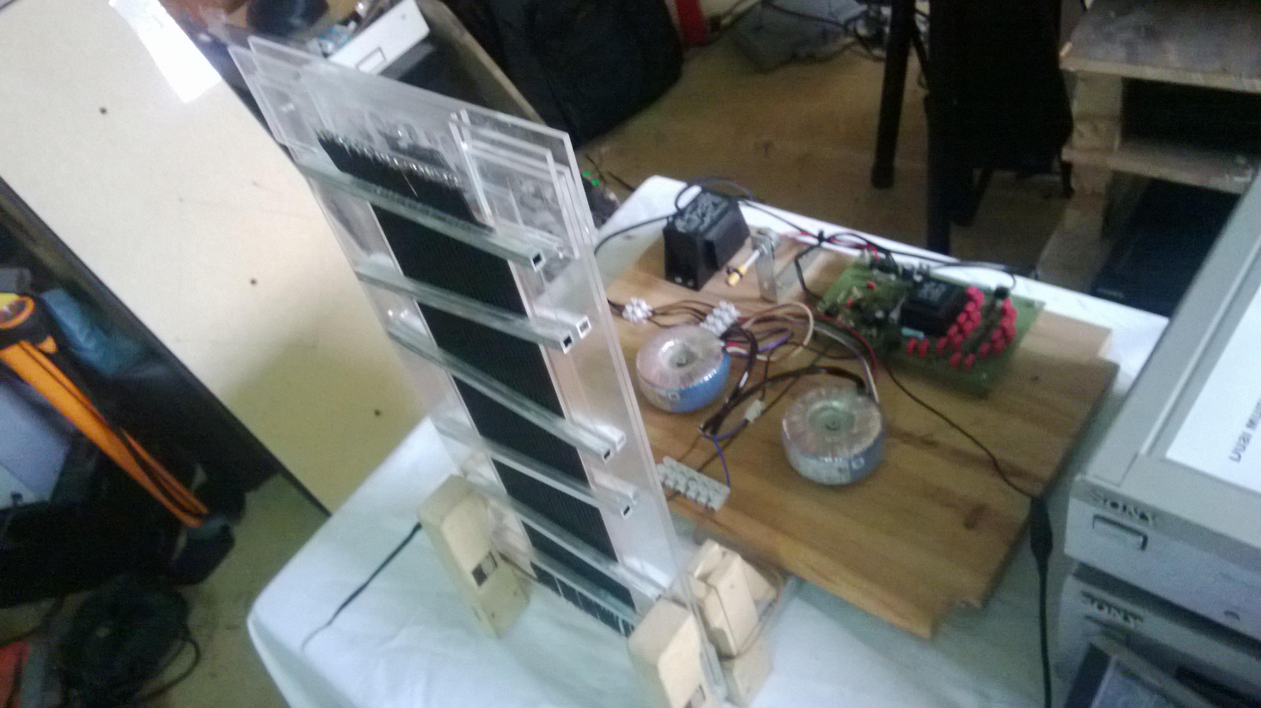

Done!
It is alive!!!!!!! No stereo, just one channel, still waiting for the second pair of transformers.
It is loud! No crossover, but there is bass!
Feels like christmas and birthday together!

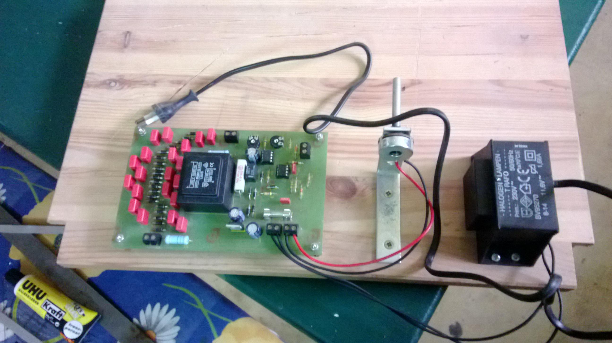

Hi tyu,
I use two trannies, 50VA, 230 primary and 2 x 6V secondary, just like Charlie describes it
Jazzman's DIY Electrostatic Loudspeaker Page: The Electronics Package
The cheapest source for me was this company in Germany:
IT-Tronics - Ringkerntrafo Sedlbauer: 50VA 230V -> 2x6V / 1x12V ; 2x4,17A / 1x8,34A
Greetz,
Christoph

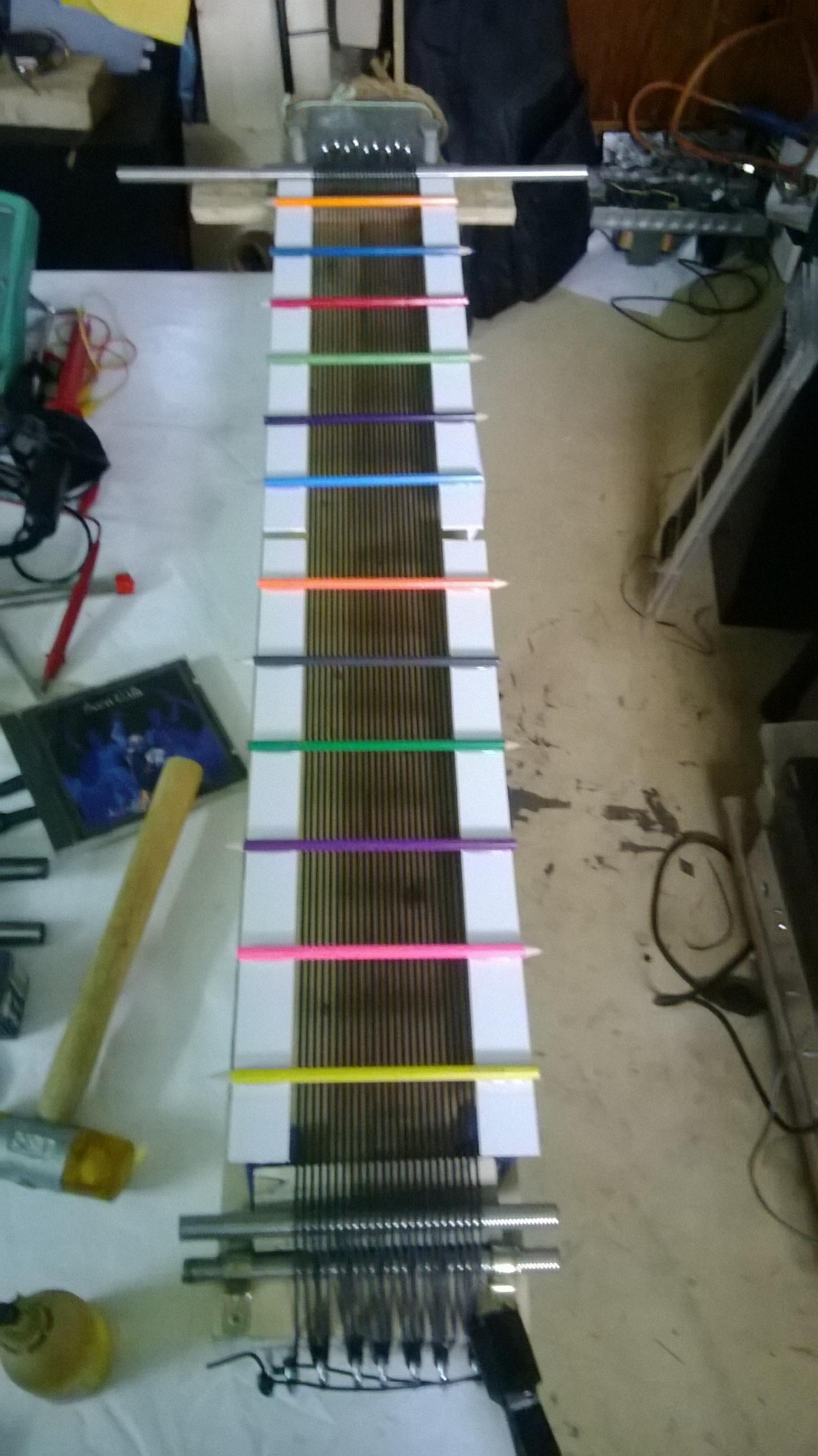

Thanks, I am at the beginning now, there is a lot to learn.....
In the moment I am building 4 Panels, 10 cm x 80 cm, 1,5 mm Spacing, same hardware. I am stuck to this dimension, because the stretching frame und the wire stretcher is limited in size.
In the end I will have 4 ESLs, 2 per channel, what could I do:
1) two panels one at the top of the other (160cm x 10 cm)
2) Two panels next to each other (20 cm x 80 cm)
3) stacked Panels
Could anybody kindly explain me the consequences?? I know, all the information is available here, but for me it is hard to put it all together..

Thank you very much for the answers!
In the meantime I have build another panel, just for training
Sound is good, coating works good (thanks Jan), sound is ähm....colorfull
Jer and all the others, indeed I have some more questions
- I will build bigger Panels in the future but I don´t want to waste these small panels, so I need a kind of woofer to mate with them. I have no possibility to measure my panels and most information about woofers and subwoofers in this forum are about much bigger ESLs, so what to try? I would use these speakers just for casual listening... I am looking for a cheap solution, I will spend my money with the upcomming bigger panels
- Second, could electrical segmentation help to "optimize" theses little panels?
Thanks a lot,
Christoph
