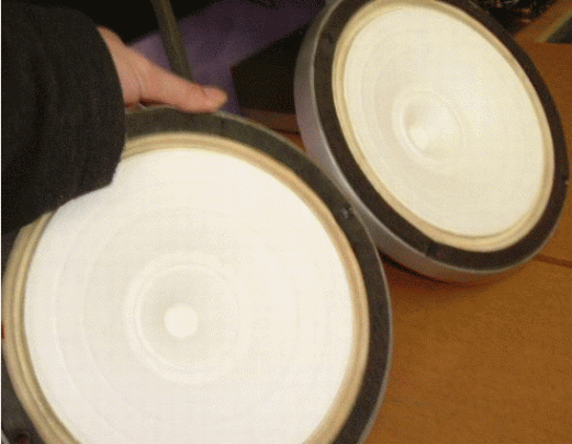

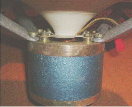

The Hartley 220 MSG 25cm 20-22k, almost got a pair on ebay Aust with 24" and tweeter, but I was to cheap to go over AU$1,000.
The Visatons are available in Aust from sound labs group
regards
James
