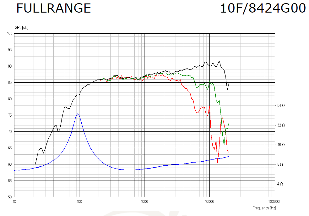

Here is my take on DDR: it is present in a driver because that driver has HF peaks which result in ringing. The ringing produces a lengthened duration of sharp transients and this is then perceived by the human auditory system as a heightened persistence of low-level micro details not originally there in the source material. Take a driver with reportedly high DDR like the A7.3 and EQ its 10 to 15 dB peaks flat. Is the DDR still there? A neutral intrinsically-flat response driver will be deemed lifeless by proponents of DDR-seeking listeners. If this is what you want to hear, by all means, get drivers than ring.
Here is the response of the SS 10F (~1dB to ~2dB peaks at 0 deg and 15 deg, data presented on graph with 5dB major divisions and 50 dB vertical scale, not 110 dB vertical scale and 10dB divisions like A7 or A10 data):

As far as measuring resolution quantitatively, it can be difficult. I find that waterfall/CSD plots are a pretty good indicator, especially for mids and tweeter. Good impulse tends to correlate also.
BTW, take a look sometime at how bad small drivers are at CSD below 500Hz. It is usually edited out. Metal cone drivers, despite their drawbacks, seem to do much better in equivalent sizes. Certainly the Seas and other good metal woofers I've heard bare this out.

ScanSpeak 10F/8424G00 or Visaton B80.
Both 10F / B80 review data found here post #343 http://www.diyaudio.com/forums/full-range/268626-vifa-tc9fd18-08-best-bang-buck-35.html#post4250353.
