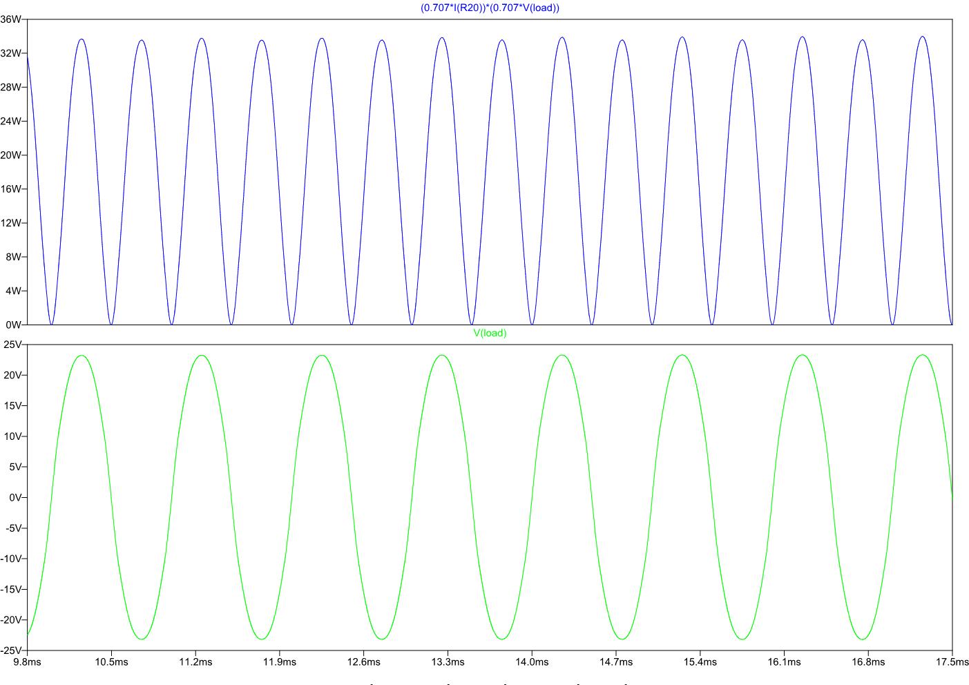

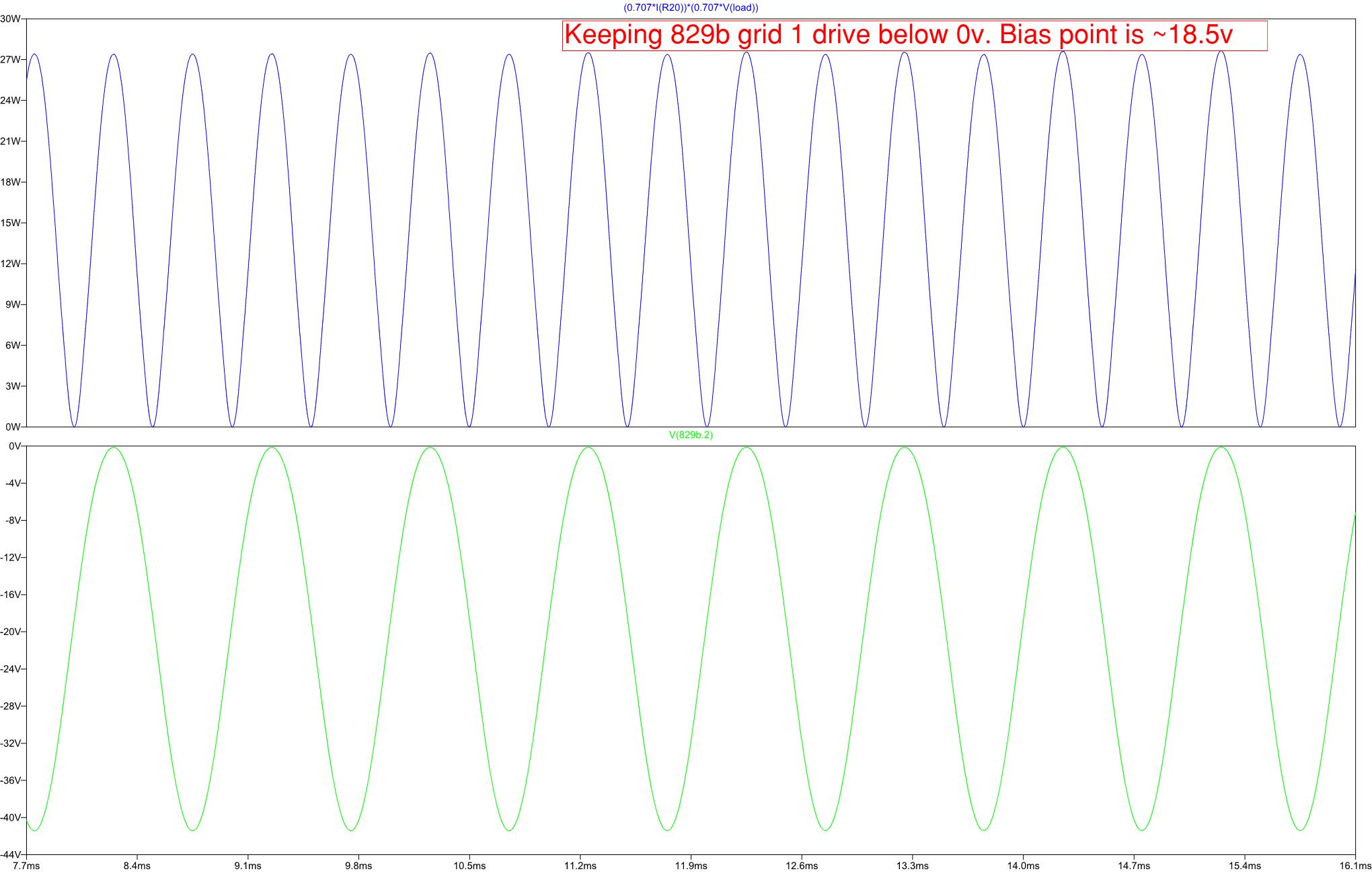

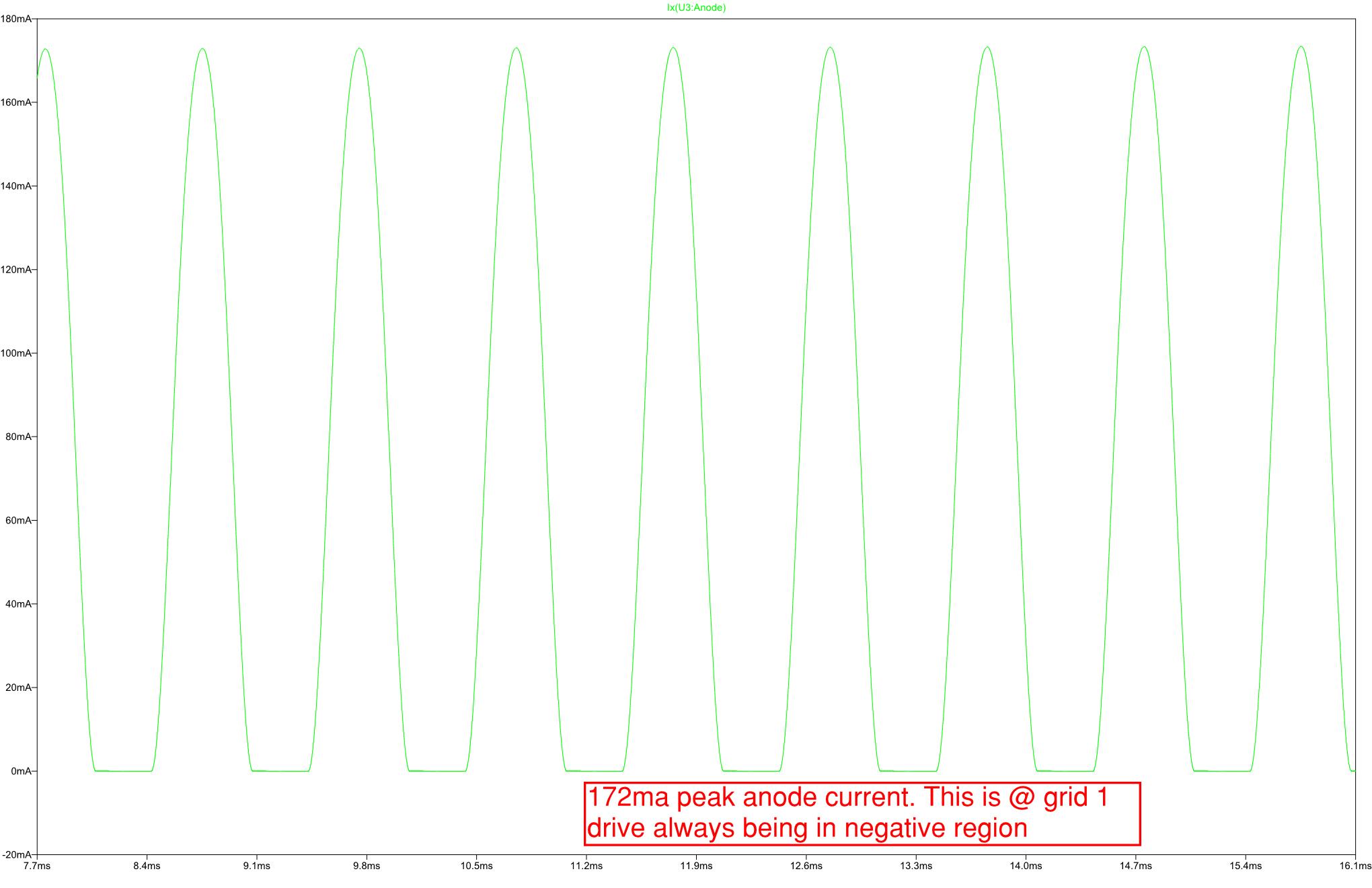

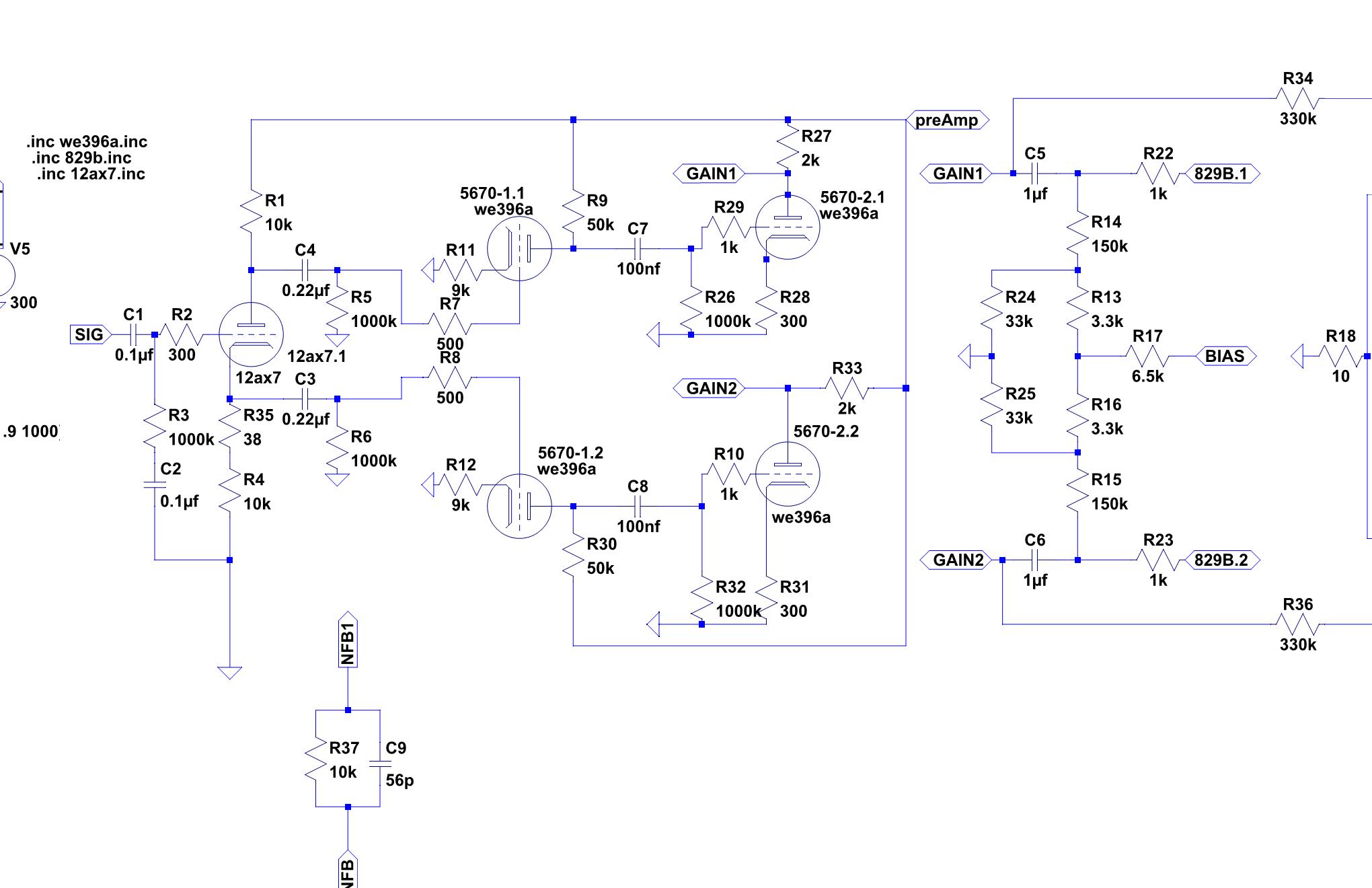

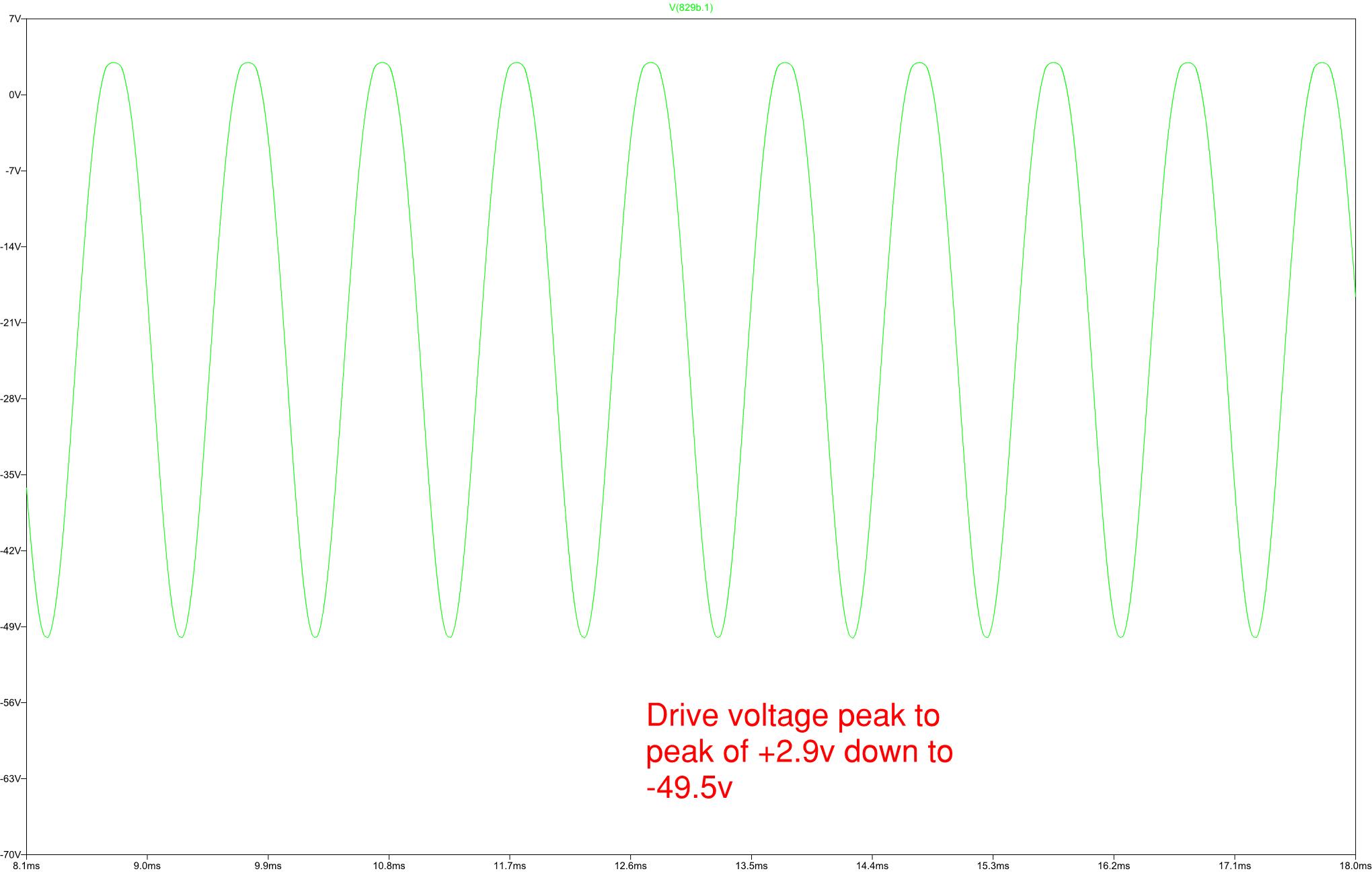

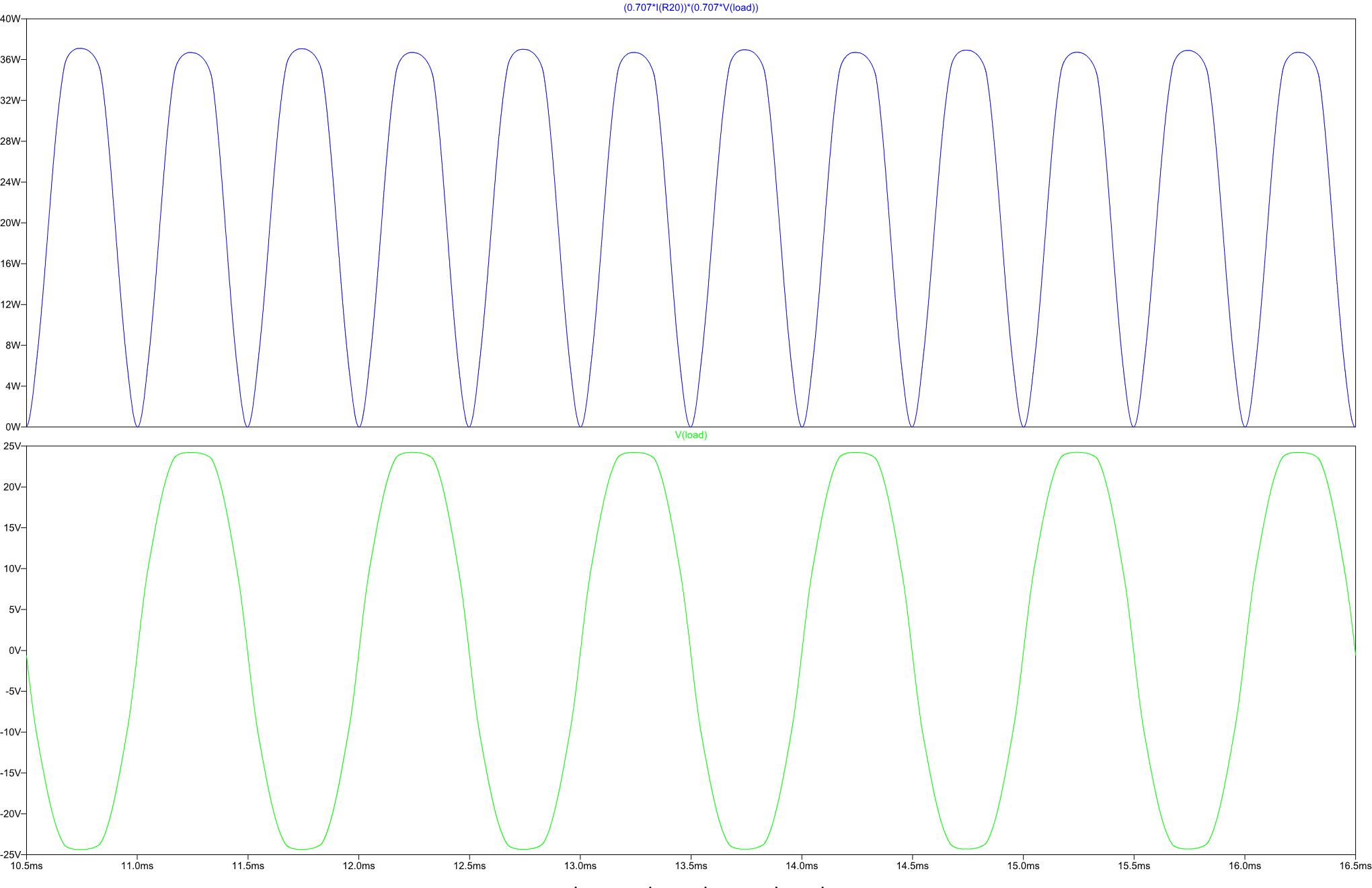

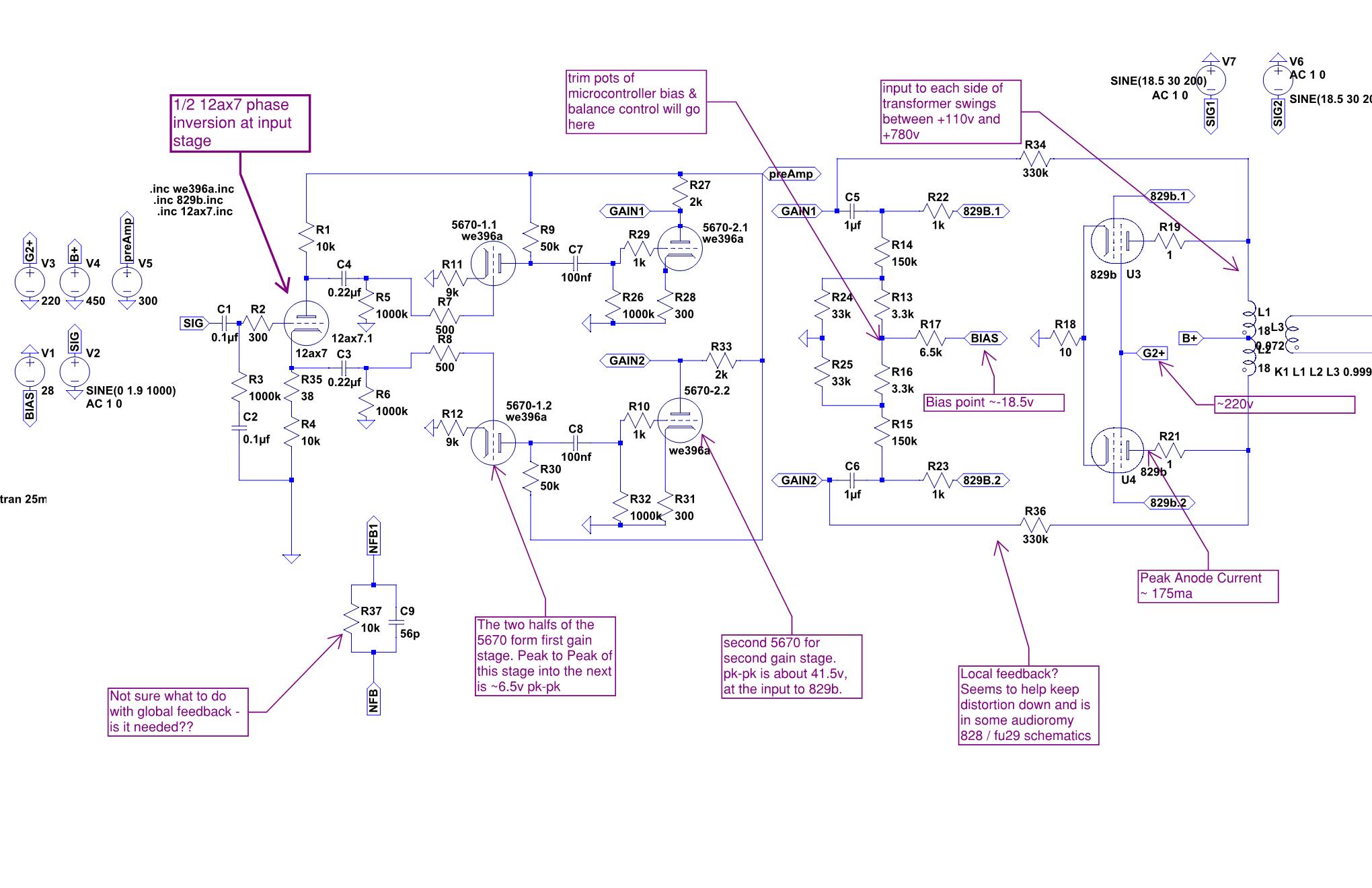

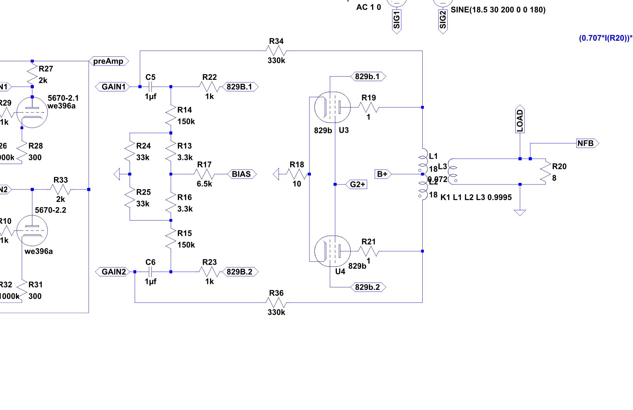

Hi All,
So an update - I've spent the last few days being obsessed with LTSPICE.
Firstly thanks for reply ratbag, saw those in the past and thought they were interesting. I've got a nice miniwatt N3 with although not a SET is more like a SEP and sound very very good. Love it to bits.
Anyhow, I am keep on a powerful as I can make with whats available.
So messing around with LTSPICE - wow, what and amazing piece of software, love it. Really remarkable and easy to use. Anyway, I have gone mad with it and played for hours, hours and hours, learning a hell of a lot. I am more of a electronic systems engineer and low level analogue electronics is newish to me, tubes are especially new so I expect a lot of problems to be lurking in my circuits.
Anyway, I have attached all of my information for review, comment and for me to hopefully learn, fix and make.
Summary (per channel basis):
- 1/2 of 12ax7 as input phase splitter
- 1 * 5670 1st stage to gain up to ~7v pk-pk
- 1 * 5670 2nd stage to gain up to ~50v swings into the 829b
- 1 * 829b output tube in push-pull config. Each half of the tube does a push or a pull.
I am still keen on using toroids as output transformers. I believe I need about an 8k output resistance to work best with the 829b?
It would be great if the experts might want to leak some of their awesome knowledge to help me tweak this amp. I've done loads of analysis and annotated and commented this and the schematics, as attached. The LTSpice model and tube data zipped is attached too.
Cheers for any help and comments!
