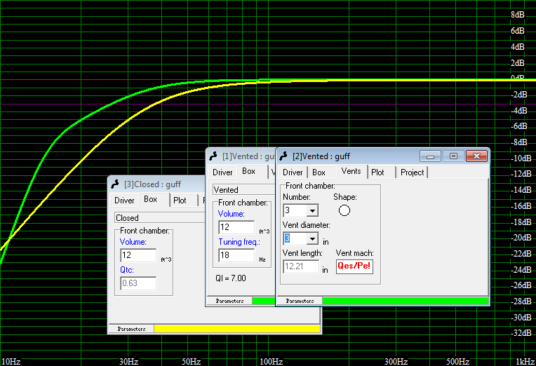

Dayton Audio DCS450-4 18" Classic Subwoofer 4 Ohm 295-475
Should work well. 12 cuft tuned to 18Hz with 3 3"dia x 12" ports. But if
you want more efficiency and less bass then this might be a good driver :

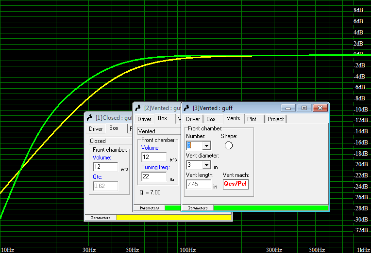

MCM Audio Select 18'' Die Cast Professional Woofer - 700W RMS | 55-2984 (552984) | MCM Audio Select
Because its a more efficient driver Vas is a lot more than the above. However
it still works in the same box, 12 cuft but tuned to 22Hz with 3 3"dia x 7.5" ports.
Note that I don't like classic vented alignments, I like low tunings in box sizes
somewhat larger than sealed but not as big as vented that allow room gain
to well well, even better than sealed boxes.
Attached is the MCM driver :
rgds, sreten.
