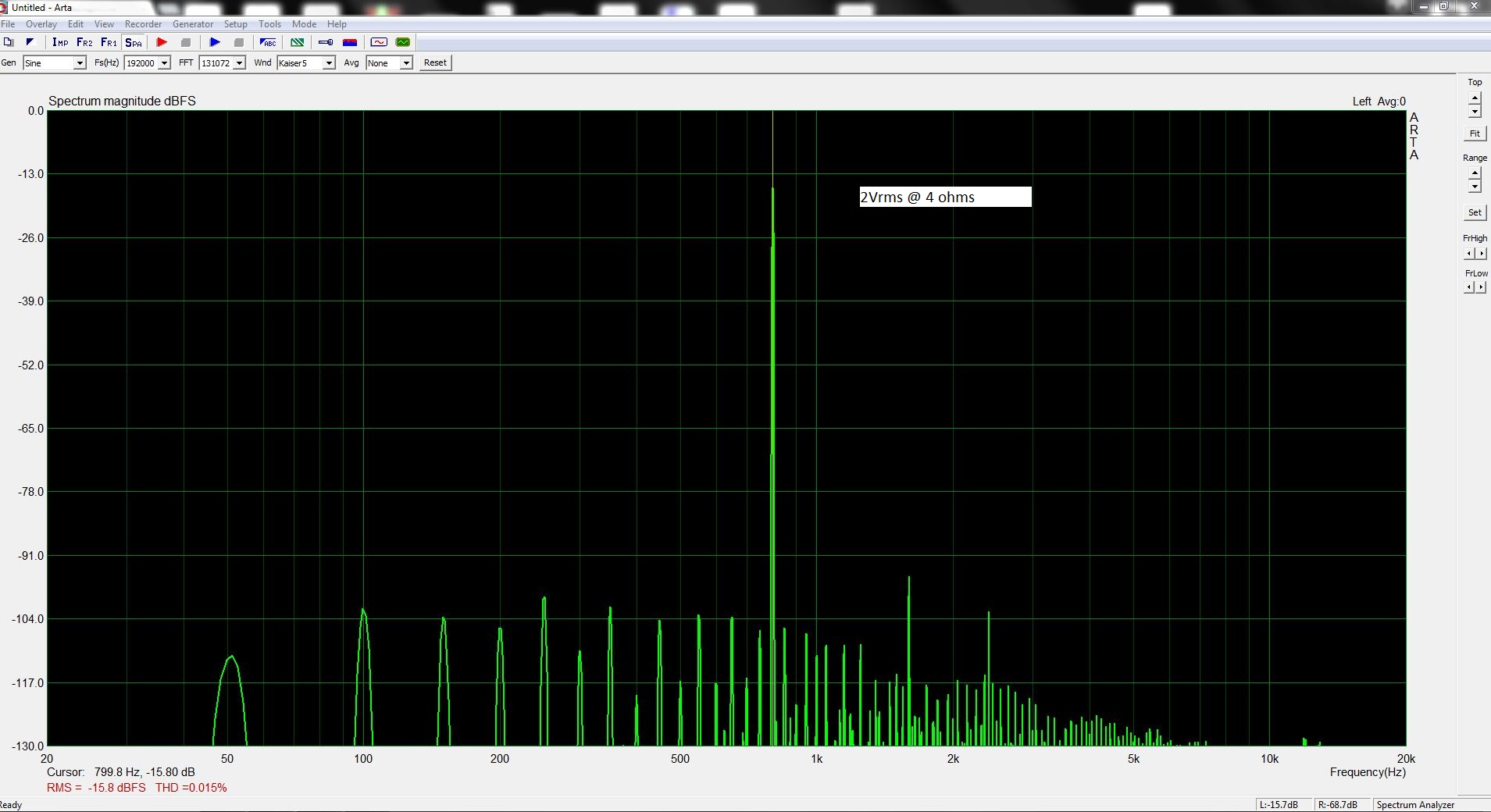

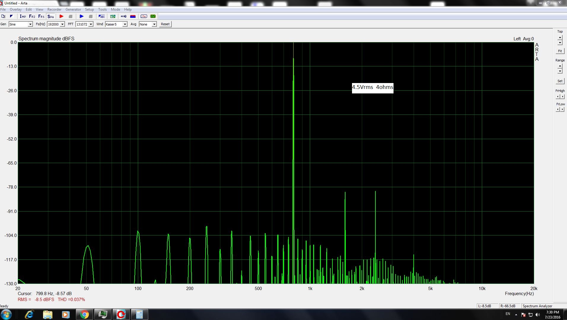

Hi all,
last days I was playing with P3 on the F5 power amp.
I dont have possibility to see distortion in time domain, so I listening and looking on the FFT.
FFT of what sounding best for me is in attachment.
That setup giving dominant 3rd on 8ohms and same setup on 4 ohms giving
dominant 2nd on low output voltage, until around 4.5Vrms, where 2nd and 3rd are equal, over 4.5Vrms 3rd became dominant.
4th harmonic is minimised, maybe there is clue....? Who knows....
When 2nd is nulled it sound to detailed for me I cant relax with that sound.
:cheers:
