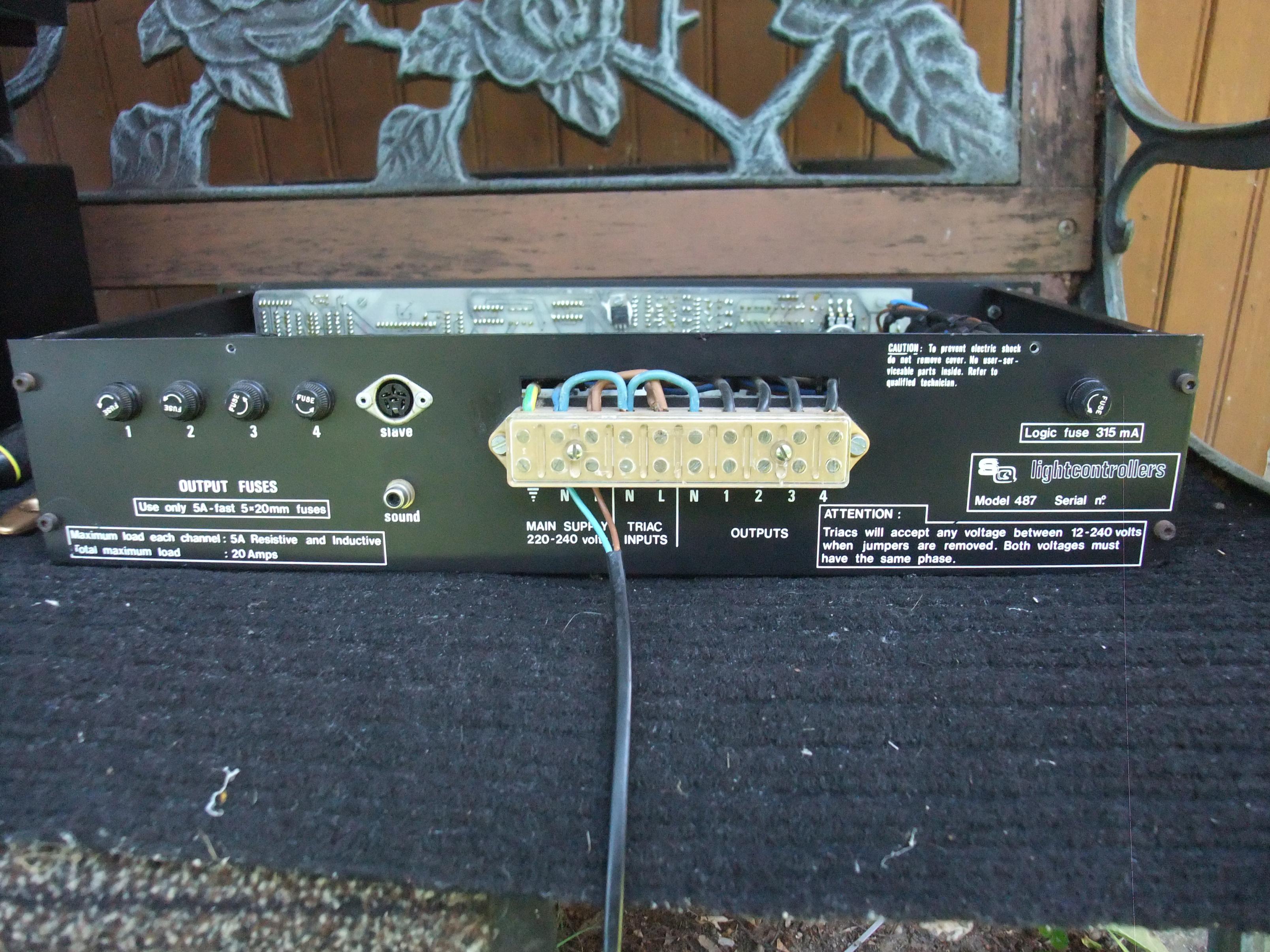

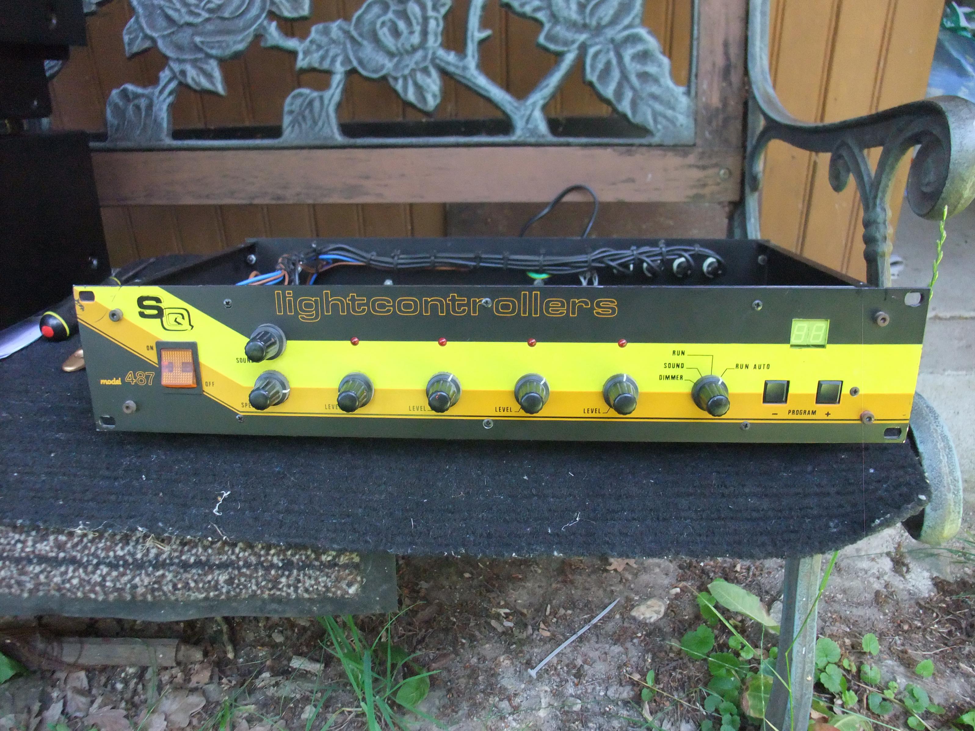

Address wanted of the Brand "SQ"
From this brand I have a light controller, but I am not able to find the appropriate service department. Maybe there are also old audio amps and mixers of this brand.
Who know this brand ?

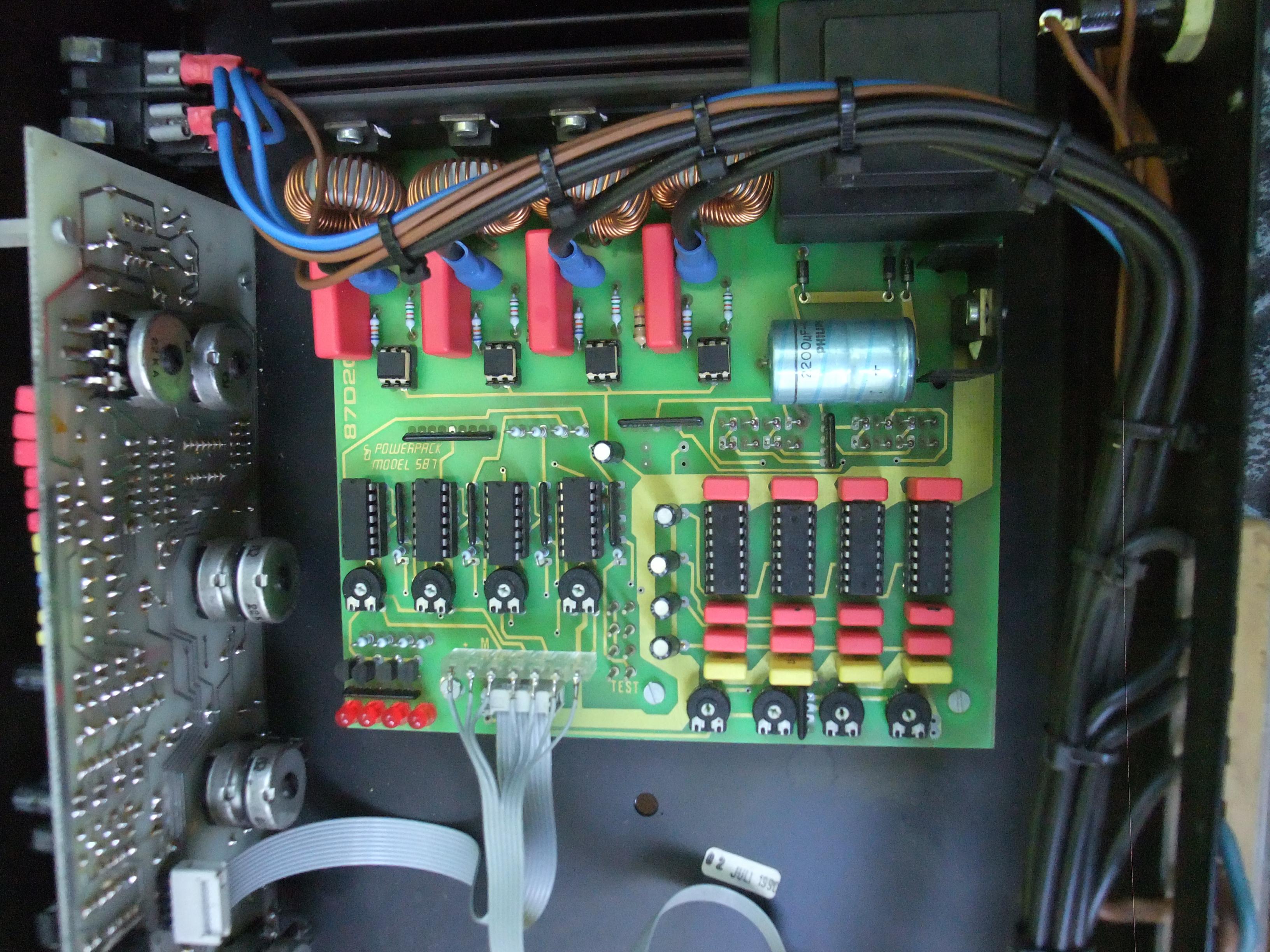

+1, what is it not doing correctly? I have built these from scratch, they use standard logic components but the most common failure point is with the triacs. Post up some pics of the internals and PCBs.

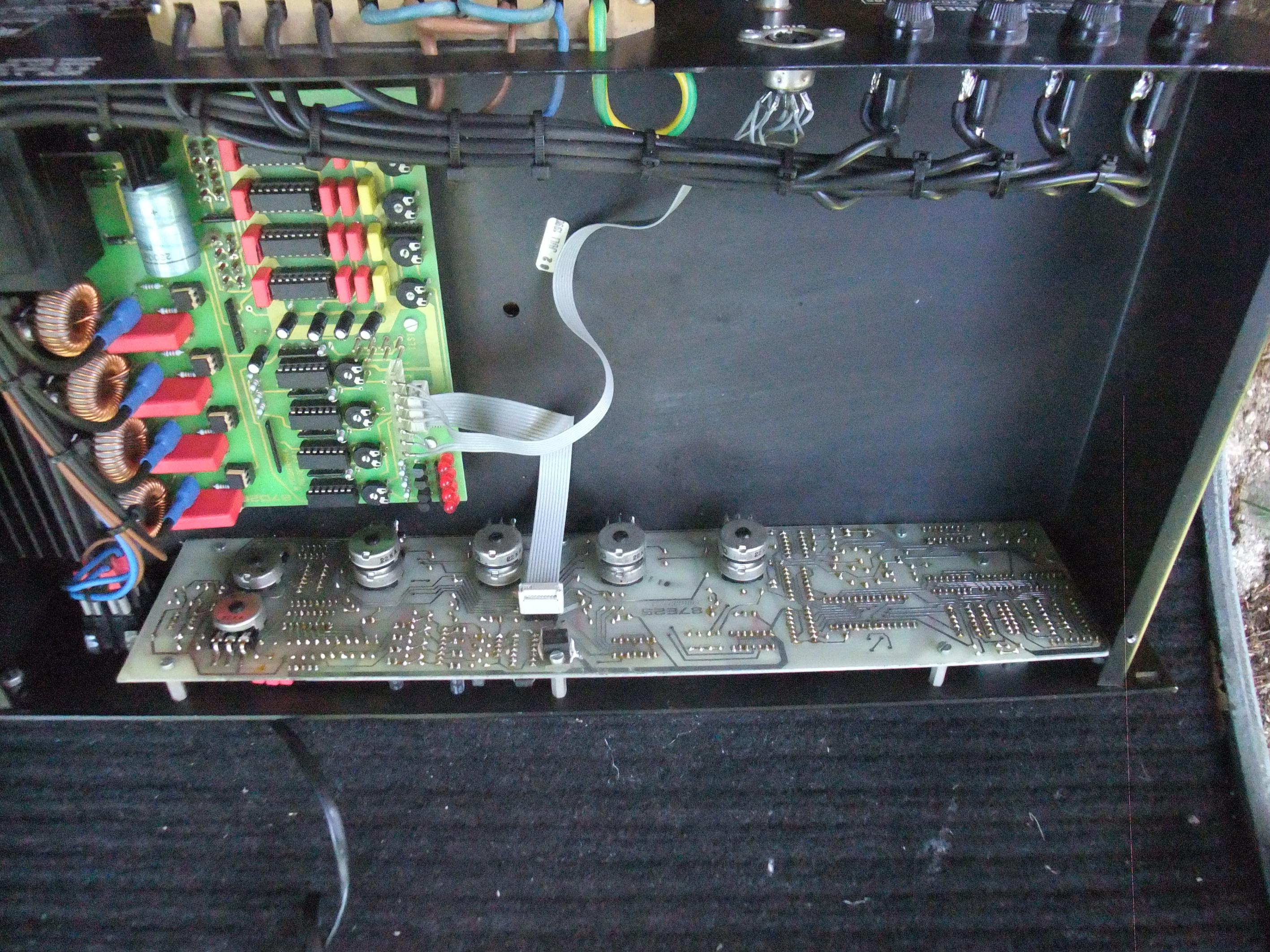

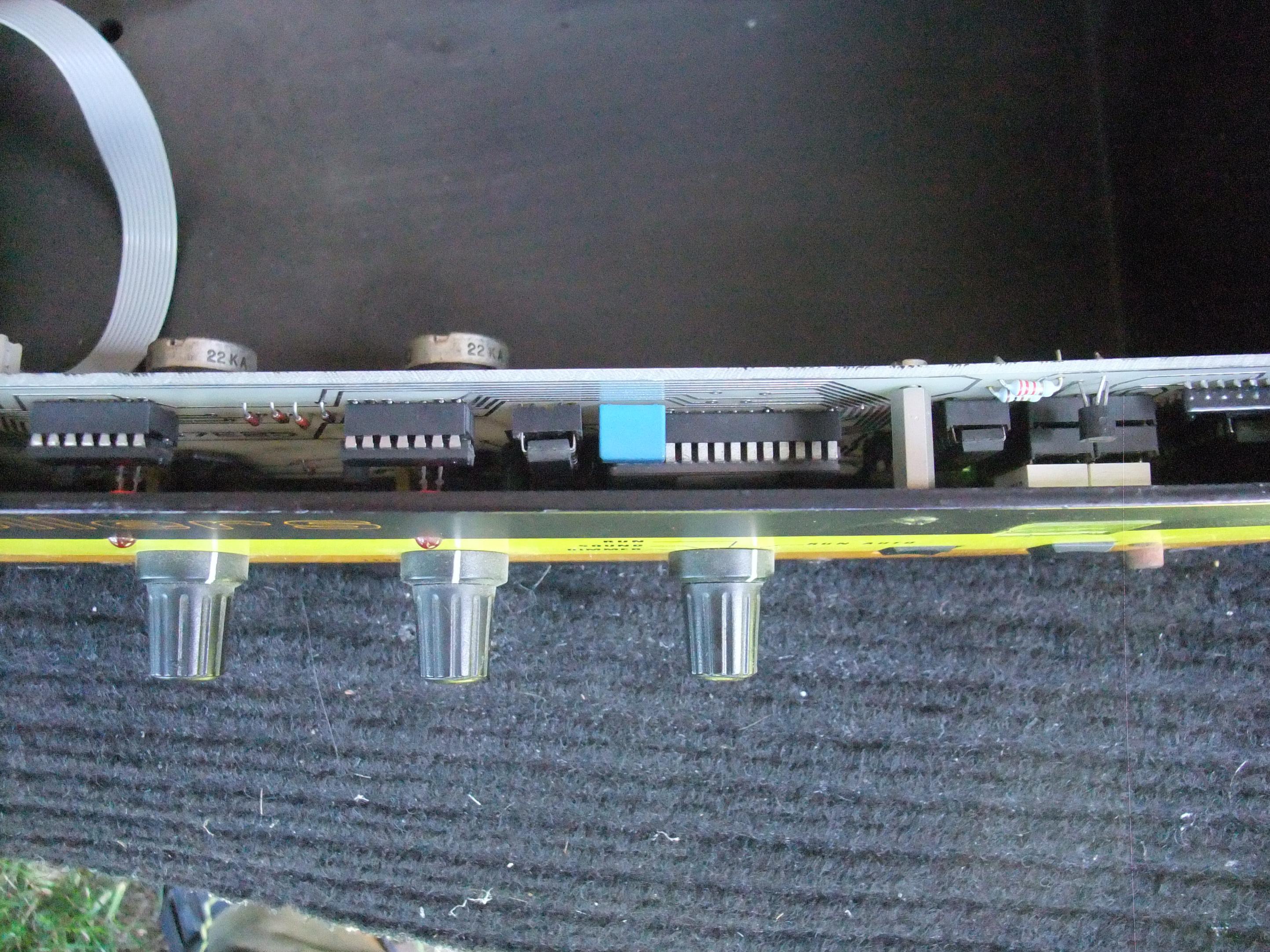

Here more images from some internal PCB's

Oh it is very well done, looks like it has opto isolated high voltage side and all ICs are socketed.
If you plug it in and power up with nothing else connected, select auto run and the LEDs on the main PCB will cycle through different sequences selected by the Program buttons on the front panel. To test the outputs just hard wire some incandescent light bulbs to the 4 outputs.
