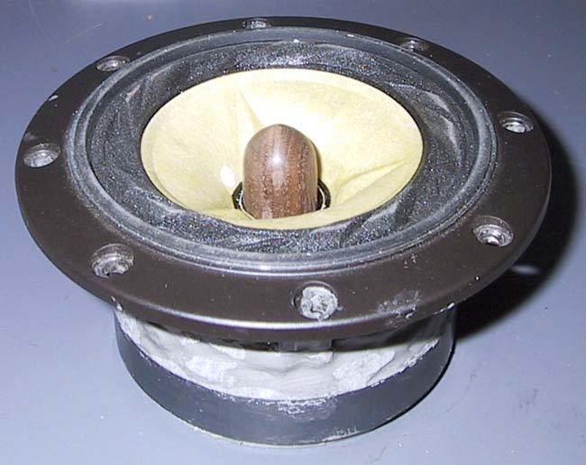

I had a chance to listen to the B200 OBs with the horizontally mounted Fountek. The Fountek had a 1.5 uF cap and the Visaton BG40 an 8.5 mH choke.
The tweeter integration -- well lets say it sucked. Disconecting the tweeter transformed the speaker from unlistenable to quite good, but i know it could be better yet -- the woofer at the bottom really needs bi-amping and the B200 some roll-off to clean up the mids & tops. With the phase plugs in (the B200 also had a couple light coats of C37) i found the top end just fine.
dave
frugal-phile™
Joined 2001

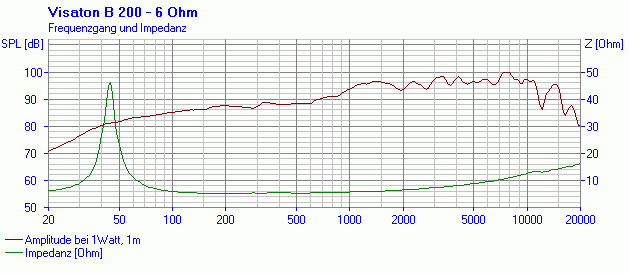

Geoff H said:
The B200 has a peak at about 12 or 13K. Dave, does your phase plug reduce that, or fill the dip just above 10K?
I haven't measured them yet. Phase plugs spread the rising on-axis HF, giving a much larger sweet spot and flattening on axis reponse. When we 1st heard the B200 we were all thinking, these are good, but i wonder what a ribbon would add... after the phase plug "no need for a tweeter".

I don't know if resolution is the right word. The phase plugs dramatically improve HF dispersion. With stock B200s if you get the speakers just right and lock your head into a vise at just the right point, there is top end -- the Germans listening with their measuring mics, record a rising top end (and dutifully add a filter to flatten it). But you move your head and all the top goes away and you start thinking tweeter.
The visual analogy is that the energy gets more and more laser-like as you go up in frequency, the HF energy is there but highly concentrated. The phase plugs take that energy and spread it out over a wider area, so that the sweet spot expands and the energy is spread over a larger area (volume).
The phase plugs also cure a tiny bit of chestiness in vocals (the dreaded voice coil oil can resonance) -- this last is just a tiny improvement, you don't notice it on stock ones until it is gone.

At several places I read that people have used 1 mH +10 Ohm filter in series with B200 and they prefer the sound this way, because it sounds better (smoother?). I wonder if ayone has tried to compare the sound between a phase plug and no filter, versus filter-no phase plug.
Dave, you didn't use any filter on B200?
Vix
frugal-phile™
Joined 2001
I always try to fix the problem at the source instead of adding a band-aid. I wouldn't use B200s without phase plugs, just as i couldn't live with an unmodified FE126/127 (or CSS FR125 now). Once you have heard the improvement you can't go back, (of course i have a vested interest to say that -- but i learned long ago, that being as honest as i can (ie culturing what i call long term greed) is way better over time than trying to quickly pocket some cash by stretching reality)
