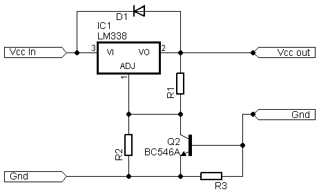

Just like LM317, LM338 offers a simple and safe way for current limmiting on single supply, choose R3 by 0,65/Iout

This scheme has many problems: it will ruin the regulation...
Only when reaching the threshold the output will be affected, but then again any current limmiting acts about the same, it reduces the voltage to keep the current at a needed level, so no problem here.
...and in case of dead short (Vout<0.6V), it will fry the transistor...

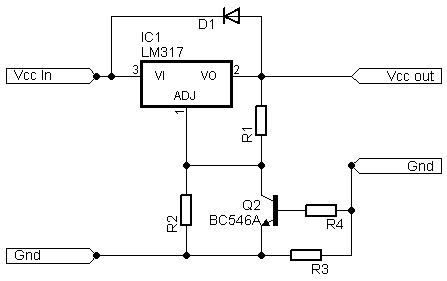

Easy fix:

hmm, so the current limiting shouldn't impact voltage regulation until i reach the current threshold? what happens at that point? the voltage drops slightly?
would a 2n3904 be a suitable substitute for the BC546A? do i need a heatsink on the BJT?
R4 = 0.65 / Iout. so if i want to limit at 2A then R4 = 0.325ohms? what power rating will i need on this resistor?

a) It will impact the regulation at any current level
b) On a dead short, the current limit will be double the normal

Any NPN small signal transistor will do as long as the Vce of it it's larger than any espected Vin on the regulator ( that is just to be sure ), it does not need a heatsink cus it will work only when the limit is reached and it will dissipate a small enough power, the resistor indeed would have to be 330m Ohm for 2A limmit and it's power rating P=V*I =>0,65*2 =>1,3W, make it 2 or 3W.

No, it will not, maybe you should study more of this config... as long as the voltage across the shunt resistor is less than 0,5-0,6V the transistor will not enter conduction, and let say that the load is 1A, on a 330m Ohm resistor will be 330mV, that is too small a voltage to biass the BE of it, so no, only near the threshold when Vbe will be big enough the regulation will be affected.

I don't remember seeing this circuit before, but it seems easy enough. It's sort of the series pass transistor concept in reverse. When the R4 IR drop reaches a level to turn on the transistor, current is shunted away from the adjust pin. That reduces the regulator output voltage, and also the current.
It will impact the regulation at the load; there will always be a drop across R4 that is unseen by the regulator.
A 2N3904 can substitute. No heat sink needed.
No, it will not, maybe you should study more of this config... as long as the voltage across the shunt resistor is less than 0,5-0,6V the transistor will not enter conduction, and let say that the load is 1A, on a 330m Ohm resistor will be 330mV, that is too small a voltage to biass the BE of it, so no, only near the threshold when Vbe will be big enough the regulation will be affected..
You should probably study more carefully this configuration: the 0.33 ohm is in series with the output, and it will add an uncertainty between 0 and 0.6V on the output voltage. This makes it useless as a lab supply. If you set it 3.3V to supply logic circuits, it could drop to 2.7V under load.

When you add loop gain (transistor) to a regulator, you eat up the stability margins

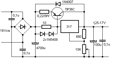

This woulb be much more precise on voltage regulation but the current limmit is not so, you rely on the regulator's limmit of about 1,5A and the rest of the current is given by the pass transistor

Just looking at the datasheet
http://docs-europe.electrocomponents.com/webdocs/0028/0900766b80028b1f.pdf
On page 8 you can see how the LM338 is used in current limiting mode. AFAICR you need to keep the adj pin at <1.25V. So if you want to limit the current to 1.5A you are looking at using R(limit) = 1.25/1.5 = 0R82.
Unfortunately the second regulator will swallow another 3.5V of your available ouput.
