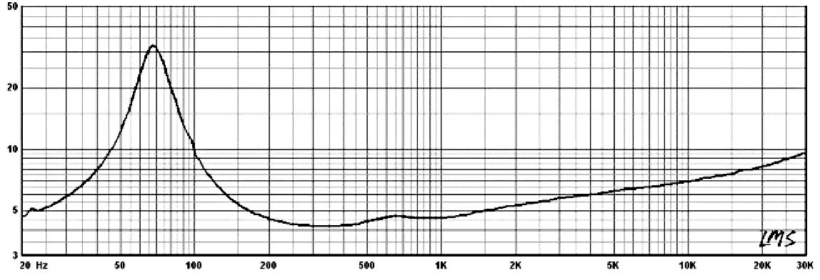

IIRC, you have CHP-70 in FH3?
Impedance of CHP:
attachment.php
The copper cap on the polepiece prevents the impedance from rising too high.
Now CHP70 is down about 6 dB at 13-14 KHz on axis.
Even if you XOed an 8 ohm tweeter (or a tweeter with an 8 ohm L-Pad) you would have impedance on the order of 4 ohms.

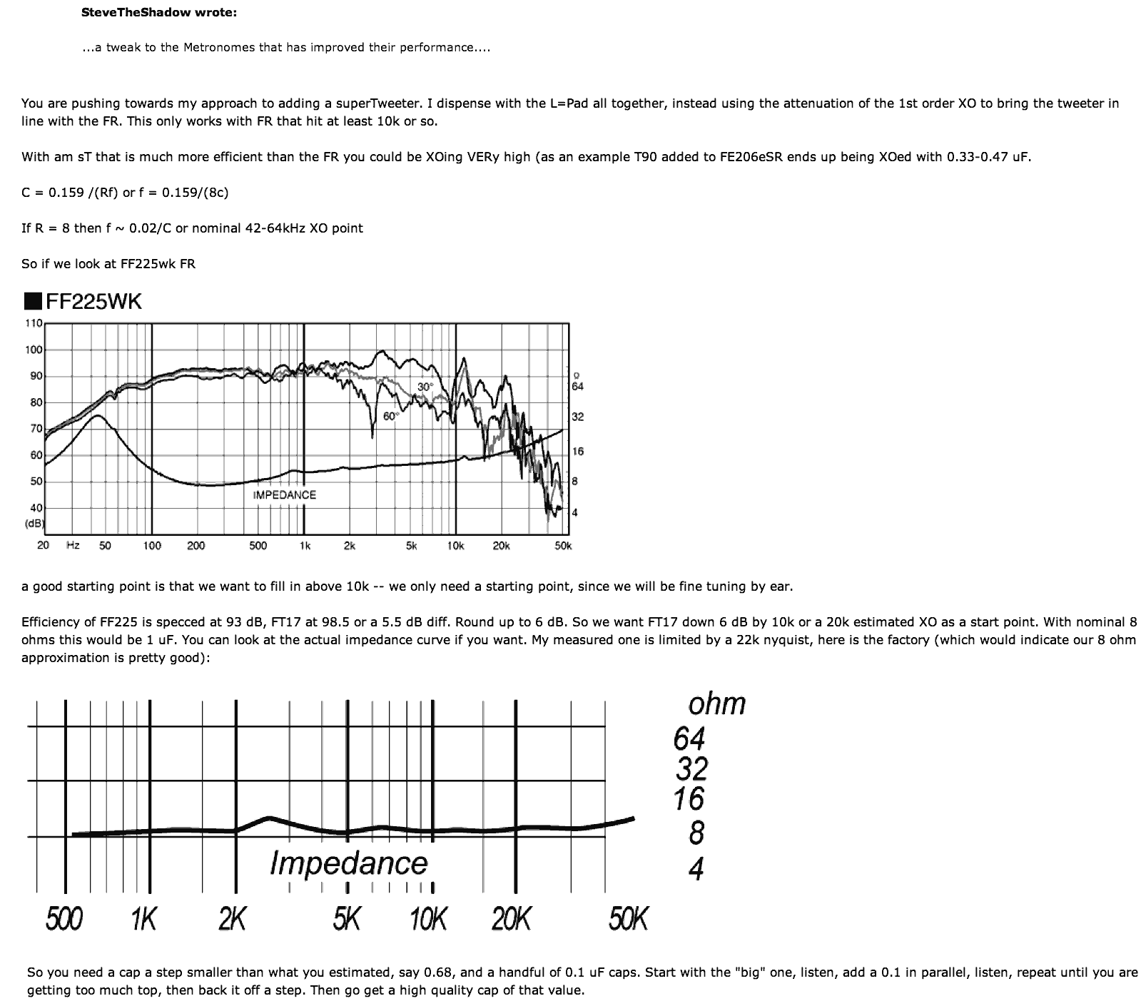

My prefered method of bringing in a super tweeter as high as is needed here is to just use a single cap & XO high enuff that the attenuation of the XO to bring tweeter level down to match the FR.
Here is a practical example snapped from a post on another forum.
attachment.php
What TVRGeek says about phasing & C-C is all true, but up here the ear/brain is pretty forgiving, and in practise it works pretty good.

Hi Dave. I have the EL70s, not CHP-70s, but good guess. Anyway, at 10KHz, the impedance of the EL70s is about 6 ohms and climbing, so I suppose a simple cap on the tweeter wouldn't stress the amp too much.

Using an online calculator, the cap size for 10KHz cross would be 1.98uF and to get the speaker attenuation matched with the an L-Pad would require 3.99 ohms series and 8.03 ohms parallel for a 6dB attenuation.
EL70 is sort of a CHP with 2 magnets (and a different spider i believe)
I'd not do it that way. With only a 1 uF cap you will also have 6 dB attenuation at 10k, which is probably XOing the tweeter too low. The method that puts the XO higher also means that on the low end, the tweeter has quite a bit higher impedance.

So you mean, to leave the L pad as it is an put a 1uF cap in series?
Using a 1uF cap puts the crossover point at 20KHz, is that right?
Start with a 1uF capa nd ditch the L-Pad. It will provide the XO at 10k with 6dB of attentuation -- i think 1 uf is likely too big and that a 0.6 and a handful of 0.1 would be a better start.

The cap only method works with a high x/o point but may be too much for
young ears, for the rest of us it probably will be fine for a supertweeter.
Basically you just adjust the 1st order x/o point so the treble sounds
balanced, down if its not enough, up if its too much, and the range
of the adjustments depends on the drivers relative sensitivities.
I don't agree it works well with very high senstivity tweeters,
here you should also attenuate and play with the x/o point.
rgds, sreten.
I think I see what your talking about know. Use a simple cap so the crossover point is a lot higher than you think you need (say 20KHz), and because the tweeters dB/w is higher than the main driver this will attenuate the signal from 20KHz and under, no need for an L-Pad, right?
